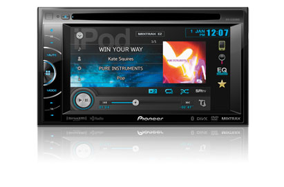

Three hours and $700 later we have a new toy, installed:
http://www.pioneerelectronics.com/PUSA/Car/DVD-Receivers/AVH-X3500BHS
This thing is freaking AMAZING!!!!!!!!!
