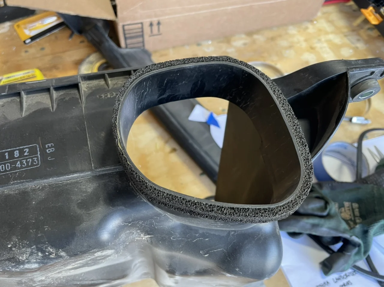

Hey @radman, @grinchy and @1world1love or anyone else who has installed this snorkel. Do I ditch the OEM slanted air flow thing that goes into the fender and the air box attaches to and connect the FF silicon elbow directly to the air box?
Seems like that is the idea but I’m not seeing happening. It’s going to need a lot of persuasion. Do I cut the foam off the oblong opening and lube it up?
Yes, that’s the only reason you take out the box - to remove that part. The foam peels off the airbox.
Then jam the flexible 90 onto the odd shape of the box. You’ll need a bigger clamp.
Short end of the 90 goes on the box.
Thanks. Got it on. Just didn’t seem right. Silicon spray was key.

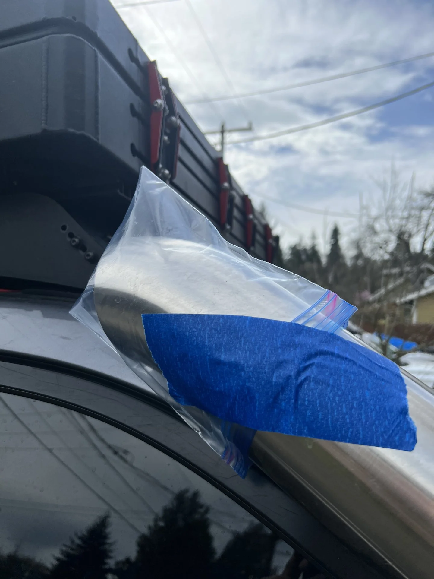

I‘m also wondering what people do when they wash the truck. This occurred to me the other day when I was spraying off the truck with a high-pressure hose. I know this isn’t specific to the FF snorkel but was curious generally.

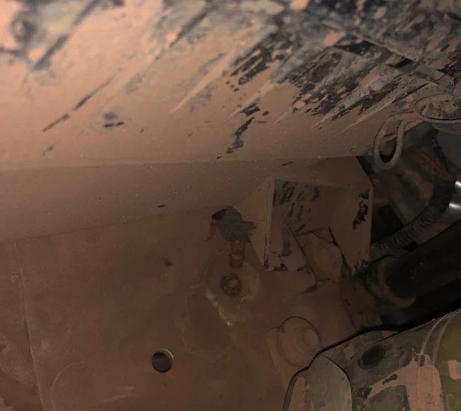

How did you put it in? There is really no clearance under the existing hole. Seems like you’d have to drill a home in the wheel well.
Plastic bag and some painters tape works while I spray it off. I attempted to spray it without the bag and noticed water in the airbox after. I sealed the one drain hole in the airbox. The only times I’ve had water in the box was after cleaning without the bag.
I don’t 100% recall - I either drilled to the side of it and mounted it at a slight angle or I opened the existing hole a bit. I think it was the former. I can take a photo this week if you need it.
I used a bit of non-silicone RTV to seal and hold it in place.
A pic would be appreciated. Also, why non-silicone RTV? What's wrong with silicon in the airbox?

Not sure if it helps, but here's the valve below in the center, RTV'd into place. So much Moab mud...
Photo of the inside. I filled the original hole and drilled a new one near it. A bit of dust I need to clean up...

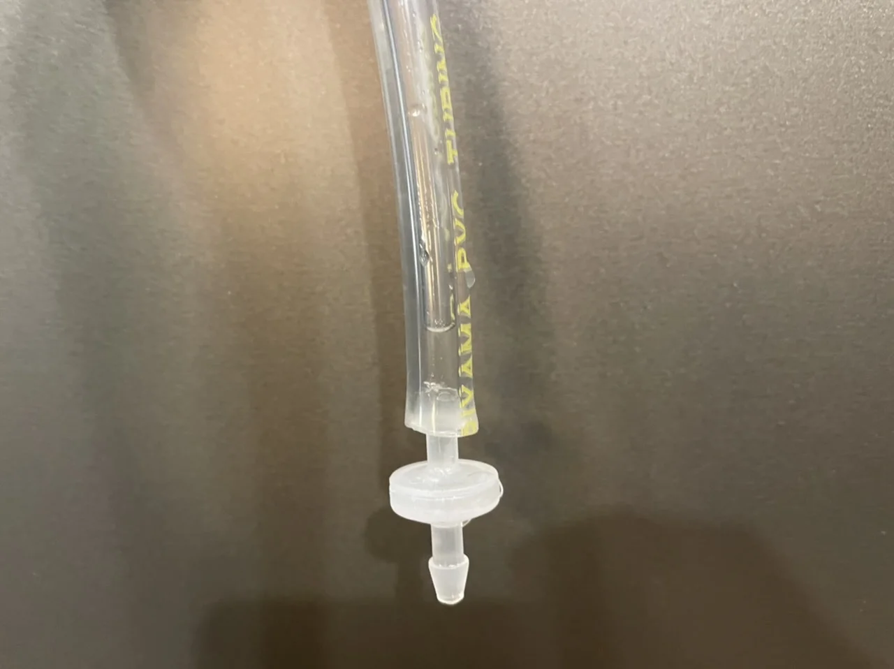

So my check valves came in today. I tested how much water column it takes to open the valve. It’s about an inch from the from the center of the valve. I’m going to mount it in a short piece of tubing and call it good.
@linuxgod, have you tested yours by pouring water in your intake and seeing if it all drains?

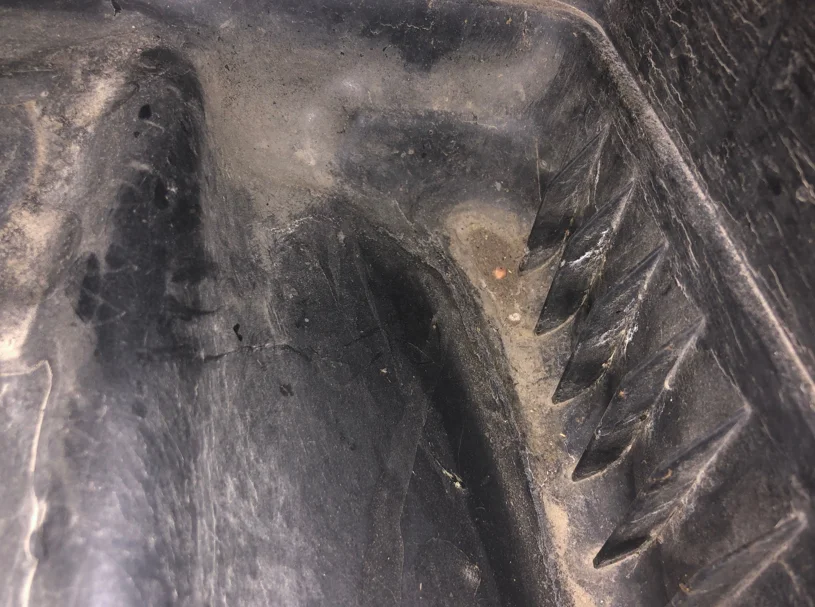

I've found sediment in my (edit) airbox at times. Any concern that would clog the check valve?
definitely a possibility. The duckbill valves are a lot bigger and would never clog but I don't see how to install one on a US airbox. The check valve I bought is very small so I think clogging is a concern. It would be easy to blow out but you'd have to remember to check it. Maybe another approach would be to only use the check valve when wheeling where water crossings are possible. 99% of the tine the stock hole is just fine. Or just plug the hole before a water crossing.
I have, I poured in just a teaspoon of water and it drained immediately.
Yes. In that case you’re not any worse than not installing one and just sealing up the hole with RTV (which iirc is what arb says to do)
