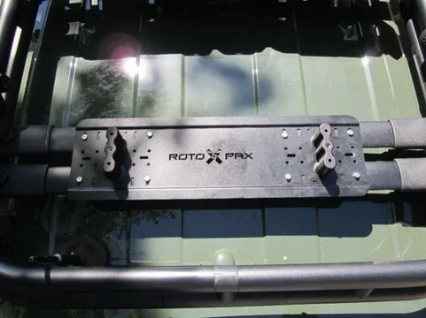

I do see where one person on the FjCruisers forums pushed their rails together and then used Rotopax universal mount. I guess that might work?

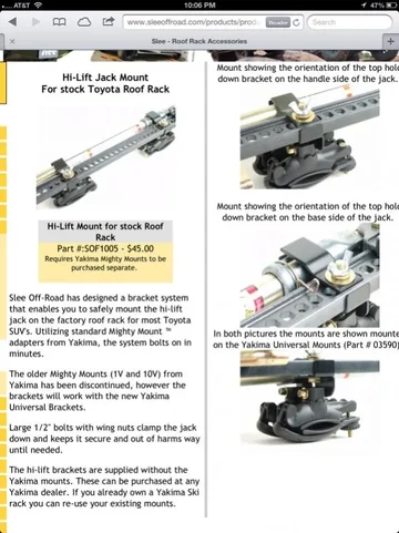

I plan to turn it long ways and then on the opposite side use the Yakima mount and Slee bracket for my High Lift Jack. I think I will have just enough clearance for garage.

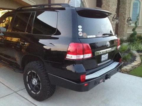

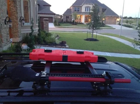

I completed the set up for both the Rotopax and the high lift hack roof mount. Both on the factory rails. I couldn't get really good pics. Both very solid. I used stainless bolts and self locking nut with the backer that came with the rotopax universal mount.
The Slee brackets worked great with the Yakima might mounts. Can't decide which way to turn jack. I have the neoprene cove and afraid it will unzip I'd I have jack end on the year.
You drilled right through the bars, right?
No worries about compromising their load carrying abilities with a hole through two parts of the aluminium? How thick is the material on the bars.
I like the quick and clean solution, no fancy roof racks needed. I tend to only use a Yakima box up there, and only for clothing and some toys. Carrying gas has always been an issue, usually ending up in the very back of the truck...not good, I like your idea.
Yes, drilled through the factory bars and used the supplied RotoPax backing bracket on the bottom which really boosted the strength. The aluminum is pretty thick and I used new stainless bolts with the self locking stainless cap nuts I picked up at State Trailer Supply. It is very solid.
I can stack another dual pack on top of these to give me 8 gallons total if needed. If you want to save some cash go to eBay and find RotoPax "factory blemished" units at substantial discount. I can't tell the difference and they are on the roof anyway...even came with the snap clips to hold them together. I think they may have been demos.

I am going to scoop up that hi-lift bracket from Slee next week. I started a thread on this topic a few months ago, at that point there was nothing out there. Love mighty mounts as well, use them for my maxtraxx. Super multi-purpose
