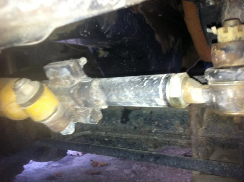

This one shows how I did the steering stabilizer mount. I had a local machine shop make the tapered piece where the shock mounts. They machined it into a small tab.
I found a piece of pipe with the same ID as the OD of the tie rod. I cut that piece of pipe in half, then welded wings on the ends. Tack some nuts to the wings, drill some holes for bolts on the other side. Tack the tab to the assembly then bolt it on the tie rod. I put a small tack on the tie rod on both sides where the assembly bolts on so that the force of the shock is transferred there. The bolts may not hold that force without those tacks.
