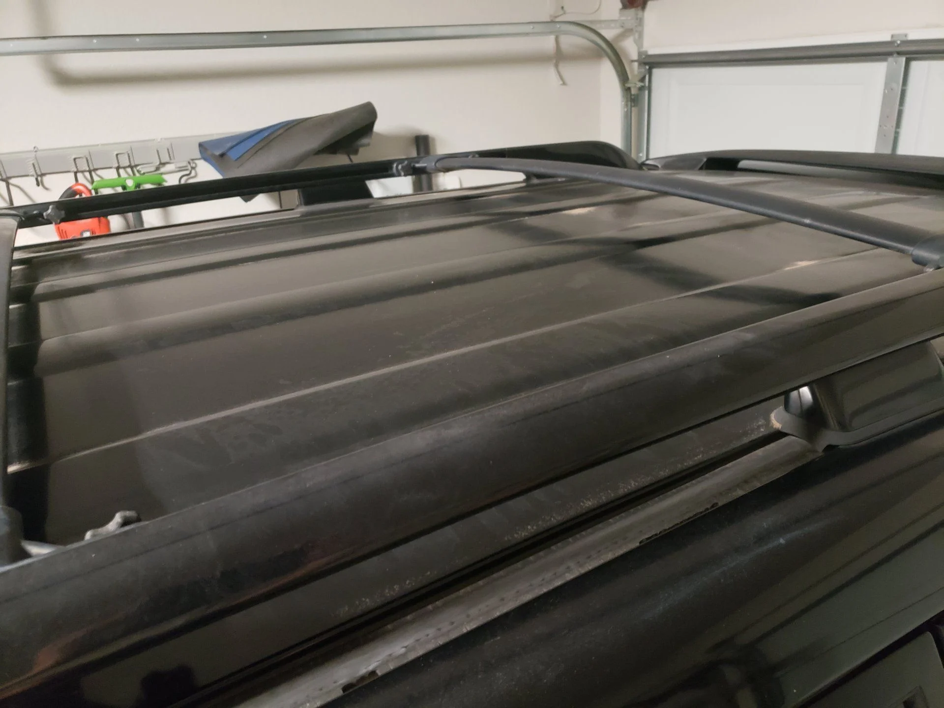

Recently purchased a 2003 GX 470. All the window mouldings are shot. I also need to replace the roof mouldings does anyone know the part numbers?

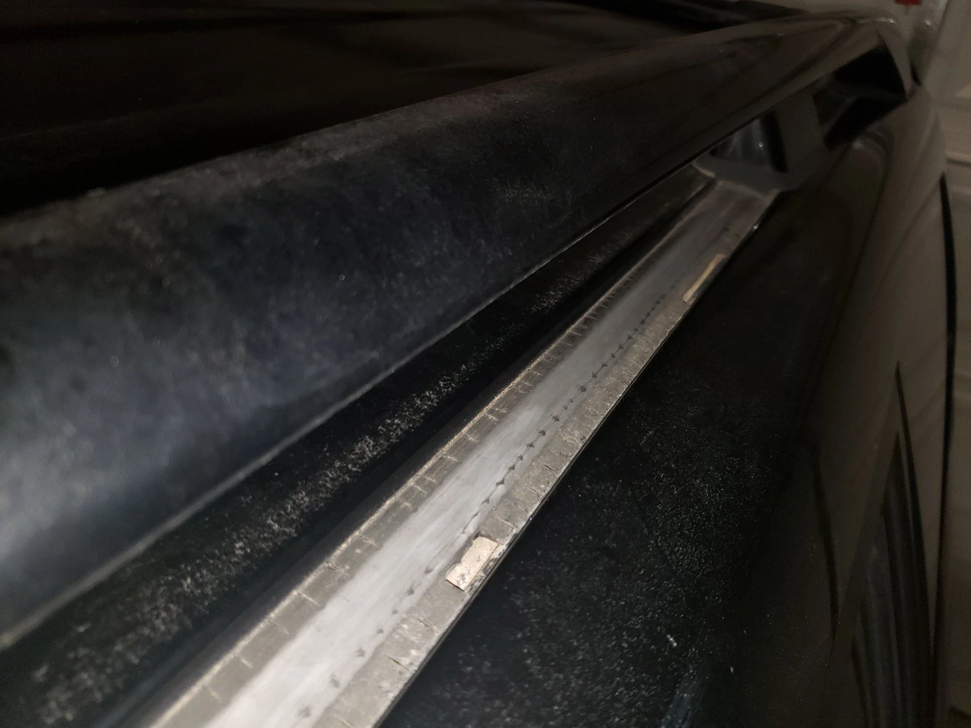

Does anyone know where this hole in my roof moulding leads to? Is it easy to replace?

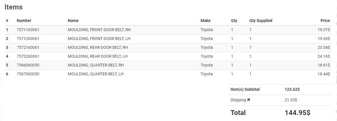

Found these part numbers for the window mouldings
7571160061
7571260061
7572160061
7572260061
7566060050
7567060050

I had to get a rear roof molding for the passenger side on mine, got it from Lexuspartsnow.com I believe you'll want the roof drip side molding. It just pushed in, didn't feel real secure but it hasn't gone anywhere.
The part number looks to be 75557-60031, Moulding, Roof Drip Side Finish, Center NO.2. I can't tell you what the hole is for but it is easy to install. I hear a rattle sometimes going over potholes, it could be the rear quarter windows but I assumed it was the third row seats rubbing somewhere when they're up. Good luck

Thanks for the tips I am looking for the roof moldings I think I need to replace them all even though they just stop water from pooling. Anyone have the roof moulding part numbers?
I did order the window mouldings from Part souq these are the black (not chrome) part numbers and prices paid
Thanks to all who contributed to this thread. Here's another case of deteriorated mouldings. We will be eliminating the roof rack for the time being. So I will need the full kit to clean it up.
Part numbers so far 75557-60030 and 75557-60031.
