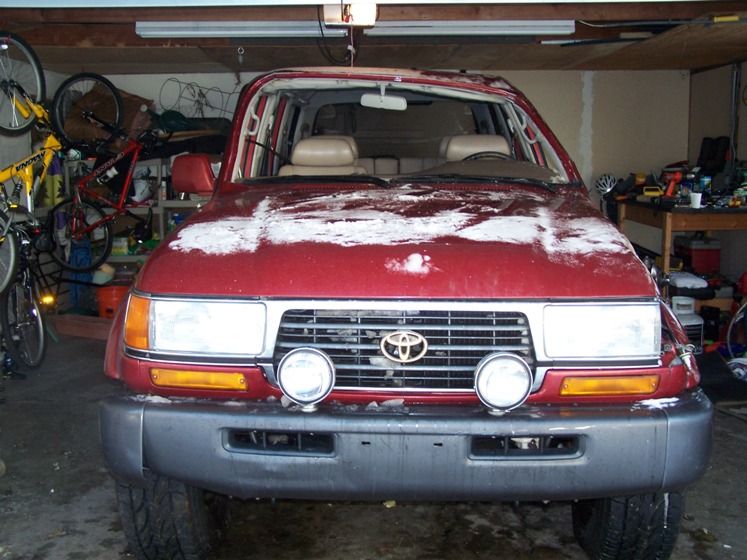

I recently picked-up a 1995 Cruiser that was rolled onto the D/S and roof. The truck is in very good mechanical condition (well maintained by PO) and rust free. I originally bought the truck with the idea of tansferring the locking axles to my 1997 LX along with some of the body panels to replace those with surface rust on my LX. After further assessment of the 1995 LC, it is in really good condition and I'm trying to assess whether it is feasible to repair the truck and turn it into a DD.
There is minimal damage to the D/S panels except the rear of the quarter panel and the front fender that has some pretty significant dents/creases. The most challenging repair will be the roof which is displaced approx. 2in downward on the D/S front corner and also shifted to the P/S by maybe an inch. The rear passenger doors close and the panel gaps are normal. The front P/S door is misaligned presumably by the roof panel displacement. The front D/S door is slightly twisted and therefore closes and latches with a good slam.
My question to the forum is what is the preferred method for repairing the roof ? I talked to another forum member who jacked (via a 10 ton porta-power) and straightened his roof that was crushed 6 inches. Another option is to purchase a roof from a LC supplyhouse (such as cruiserparts dot net) for $500 and replace the roof in its entirety. There appears to be some challanges with welding a new roof onto the old "A" and "B" posts due to the construction....multiple layers of folded sheet metal.
Any ideas ?
Thanks
Here's the damage....

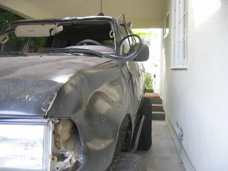

J, you are looking at bent A-pillars = you need a new top portion from the top of the door up if you want it to truly be structurally sound, and even then b/c that main support has been tampered with, in the event of a roll over the strength and durability will be compromised. I would stick with the 97 and use this for parts. You might find a shop that will bend it str8, but from what I've heard it's never the same. If you do end up straightening it out I would put a cage in it or some sort of reenforcement.

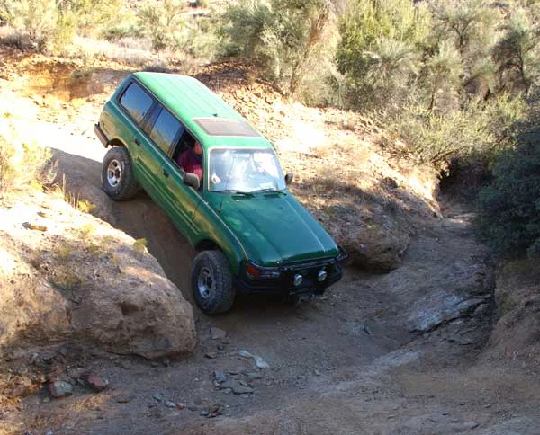

My brother Brian repaired one that was pushed down more than that. It depends on your body working talent, tool collection and time that your willing to invest. Repairing the roof is a bunch of work and more are getting parted now, so if it were mine, I would look for a body shell and just replace it.
This one was repaired with zero replaced sheet metal, in a home garage and hand tools, porta-power, mig, sanders, spray gun, etc.
https://forum.ih8mud.com/az-copper-state-cruisers/56182-sunny-belly-pix.html

A roof swap was our first thought also, but it's not as simple as just cutting it off and welding a new one on. Your posts are pushed to passenger and nothing will lineup. Once the roof is cut, it will be much more difficult to straighten them.
The first step is to remove most of the interior and push the roof back, so the doors, windshield, etc fit, then replace the roof. It's not that bad of a deal, a pota-power, come-a-long, some ratchet straps, wood blocks to push on, etc. The plan is to slowly move it, push on the A post, move to the B, then C, measure, repeat. As things start to move, tweak, bend the doors back and stuff starts to fit. The biggest mistake most make is pushing in one spot, angle too far, once you go too for it's very hard to pull it back.
The sheet metal is stretched, as the structure comes back into place, much of the sheet metal pops back much closer to shape. Once we got to the point where the structure was straight, it wasn't looking bad and the decision was made to just straightened it and no body panels were replaced on that truck.
It's a lot of work, IMHO a body swap would be much easier. At the time when Brian did his the 80's were still selling for big $$$ and there were few in wrecking yards, etc. Now they are somewhat more common and can be had for less $$. I wouldn't pay $1500 for a shell, IIRC there is an 80 in the mud classifieds with a bad motor for $3500? If you have time, keep your eyes open and shop, you can probably find a good parts rig, close to you for the right price.
