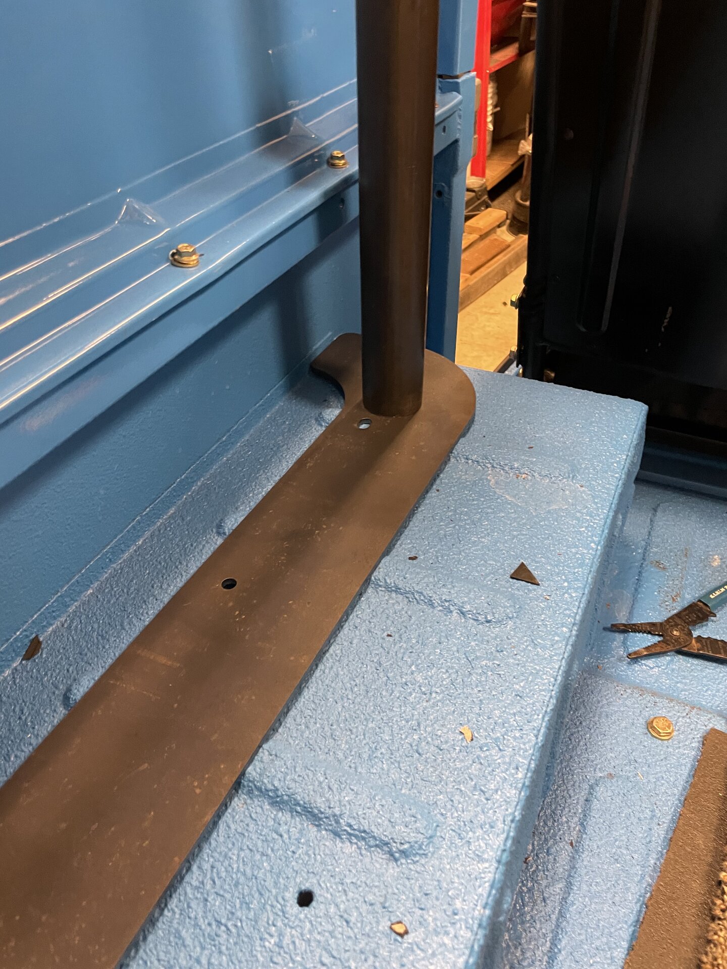

The first picture is how I mounted the base plates, you may have a different option, but I needed the entire curvature to mount the C pillar. I also added seat belt mounts in the rear for my fold and tumble rear seat, if I ever use it.

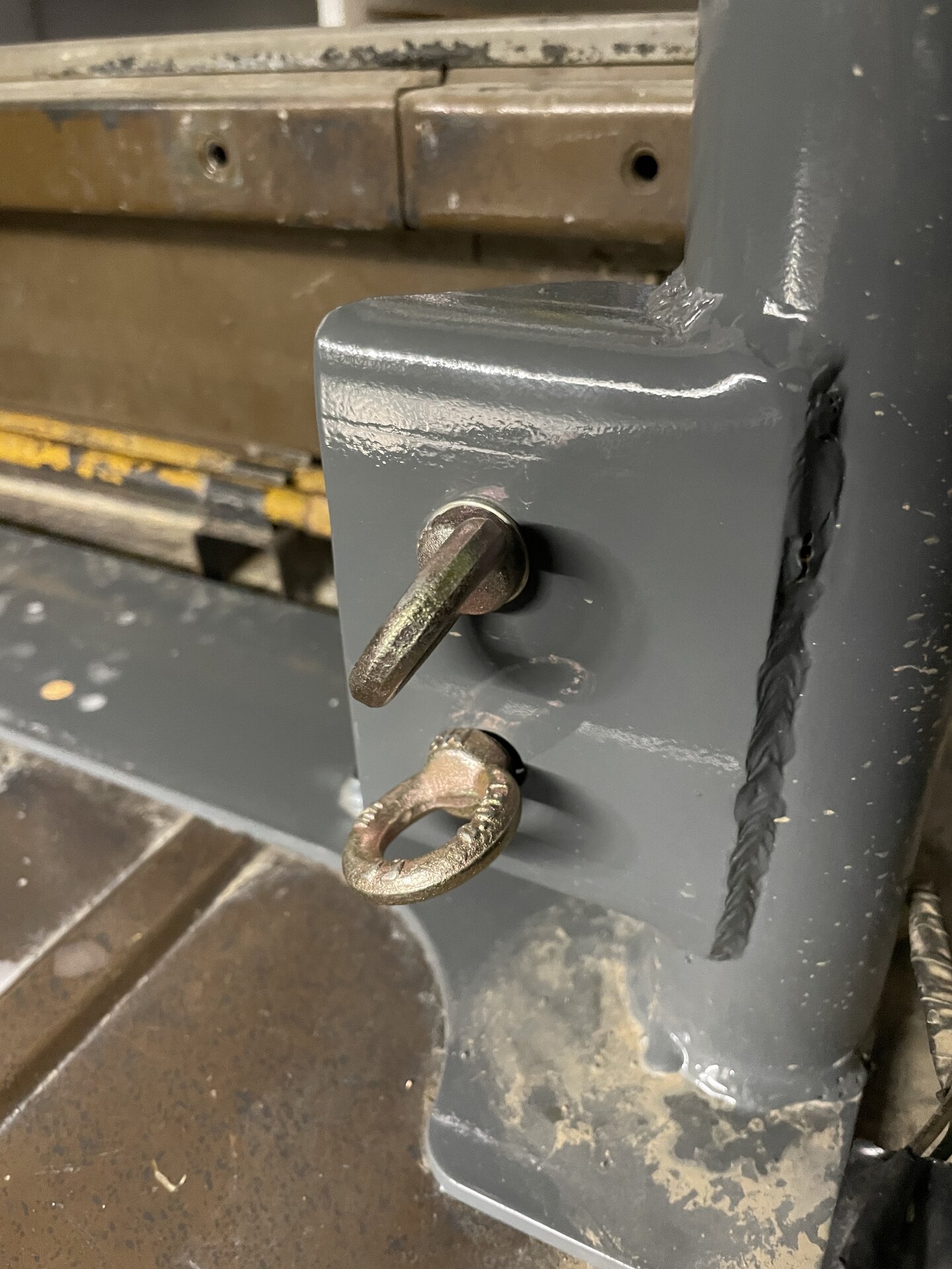

The second is my factory seat belt lower tab on my 79’.
