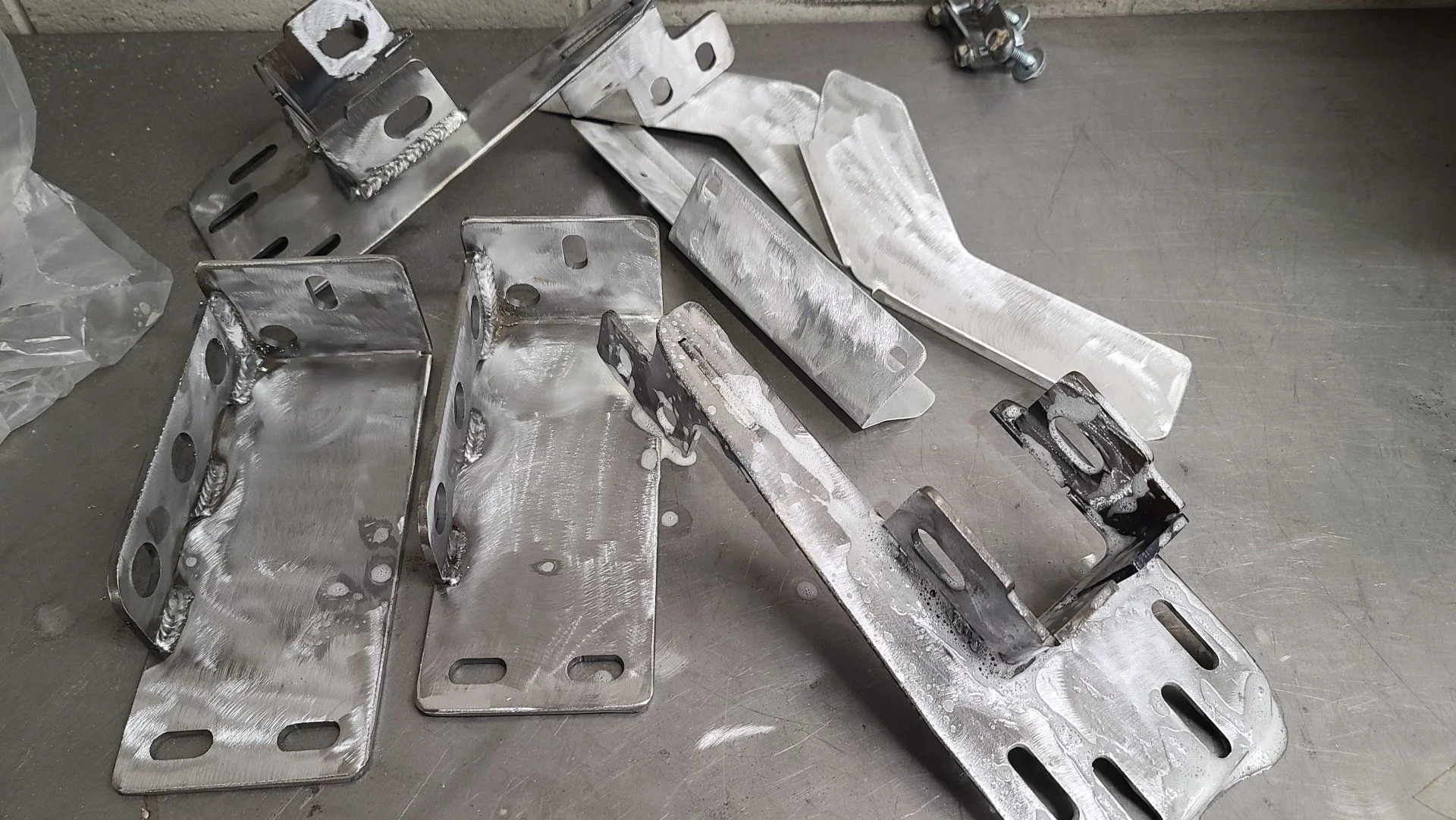

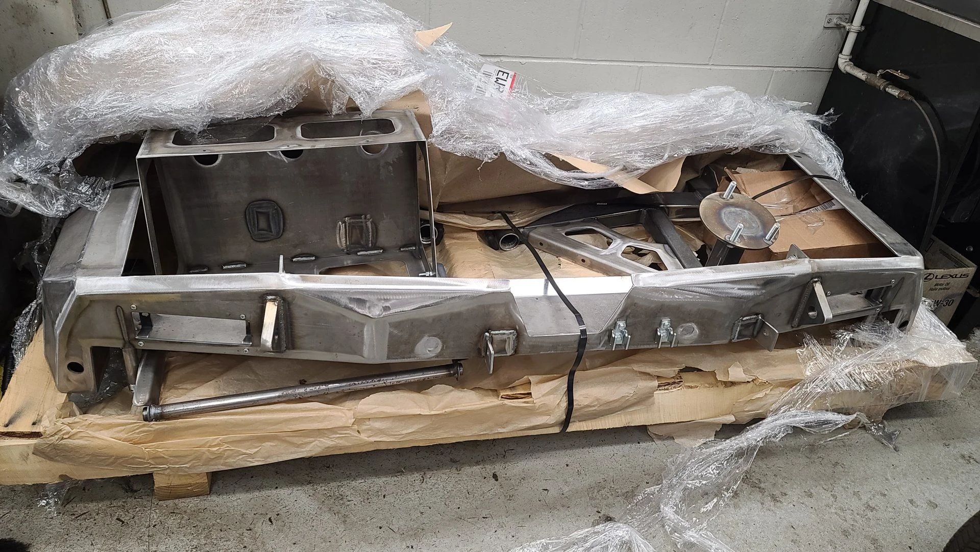

My bumper came in. What an amazing piece of work. Instead of powder coating / bedliner route, I decided to make things even more difficult for myself and chose to coat with steel-it. Surface prep requires scarification of the steel so that the stainless steel particles can fill the voids. After sanding, I cleaned all the surfaces with simple green aircraft & precision cleaner, then wiped all surfaces with isopropyl alcohol. Steel-it sprays quite well, and I expect to get a few coatings out of the amount of cans I have. Can't wait to see how this will turn out once the coating dries!
Please show when installed. Looks good

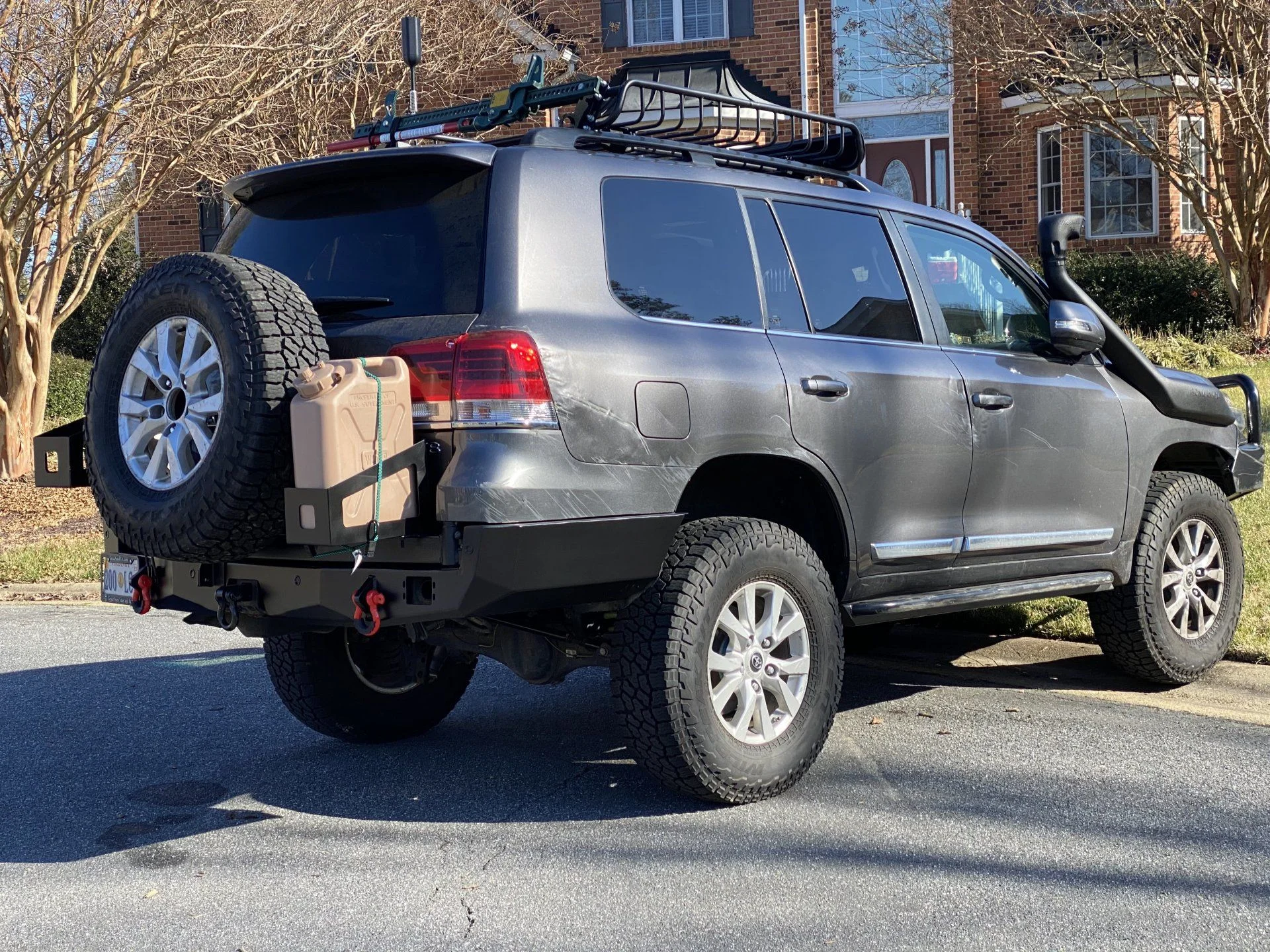

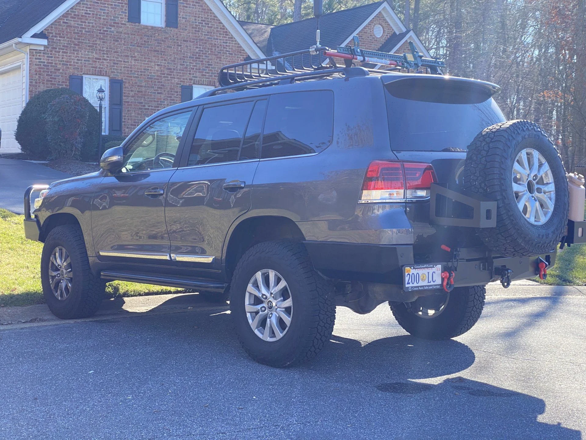

Nice post up pics when you are done. Other than mine this is the only other dual swing I've seen. The 3 jerry basket comes in very handy, and for me also does the job of a ladder for roof rack games
Yep, yours was the reason I wanted one! I just have to figure out where the hell everything goes. It's difficult to sift through this thread to get clear and concise instructions as to where each bracket goes.
Yeah I did mine and also another local buddy’s install. It’s a solid full day install, even the 2nd time around. but 2 years later I’ve had no issues and am happy with it. it’s solid has taken a ton of hard hits and never budged. I LOVE having 3 Jerry cans, those take up a boatload of room anywhere else. FYI there is a guy on mud that brings all the Scepter cans back from Canada, I order everything from him.
I think the main discussion about the install is whether the wing brackets have the flat plate facing up or down. People have done it both ways, I think it really depends on which holes line up with the frame holes on your truck. Feel free to PM me for any specifics, it’s been a little while but I remember most of the parts that were confusing at the time. Once you have all that plastic off the brackets make sense more
Thank you, I appreciate all the help you've given me so far.

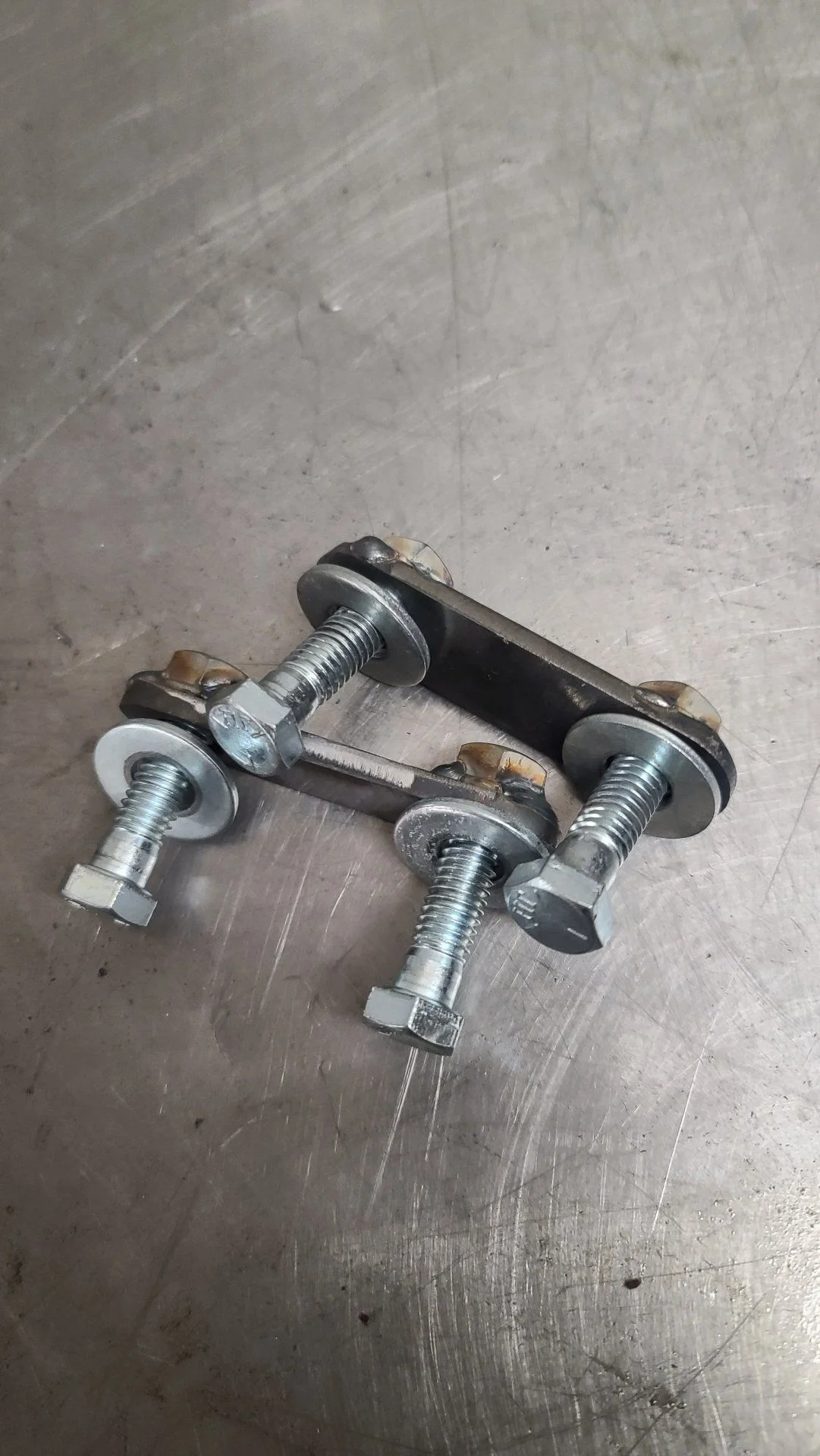

Greetings all, can someone tell me if the welded nuts to the plate is the hardware used to attach the side mounts to the frame? Just doing inventory before my install. Still lots of painting to do
Greetings, is this all that is used to attach the side mounts to the frame?
Also, heres a photo of the fasteners that were loosely attached to the bumper. But what hardware does the rear mounts use to attach to the frame?
I've been using these as standoffs for the license plate adapter. If they are the same spacing as the wing to frame mounts you could use them there. I used carriage bolts for that, but getting a wrench on the nuts was a pain.
