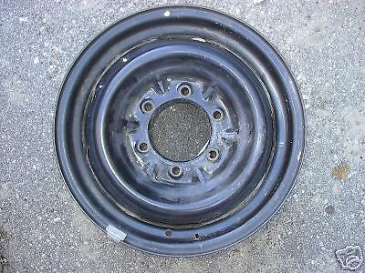

One of the OEM steel wheels for the US 4X4 minitrucks in the 80's and 90's were these non split ring type 15X6 rims.
We have never had split ring types imported in production vehicles by Toyota to the USA that I am aware of.
I do however have a set of 16X5.50 Splits that I will be putting on my FJ60 project.:cool:

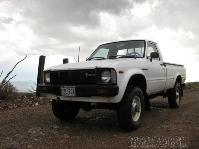

Is the white truck on the bottom yours? A"like new" '81, that's a very nice acquistion. If you can find 225's, I think that'd be the one. Otherwise, 235 75 15 is close enough.

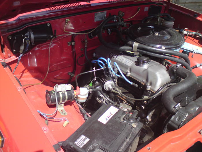

for now just a short view under the bonnet...29 years old and in a better chape than my 4 year old cruiser-build ..:D
