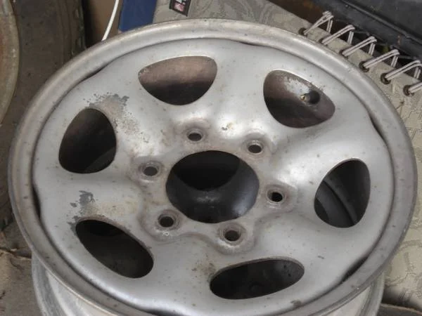

I am looking to put some street tires on the 82 FJ45. The rig is a non US model RHD that came from Oz. I installed FJ62 front discs from its 2" stock drums. Came with 16" rims.
Was offered a set of 15x7 Nissan 4x4 rims.
Question - will the Nissan rims clear the front calipers on the 45 when mounted? Rims are out of town and don't want to commit to buy them if they will not work. Anyone using the Nissans rims on a 40-45?
Don't want to use spacers.
Thanks
Nope, won't fit plus the.nissan rims will have way too much backpacking.
