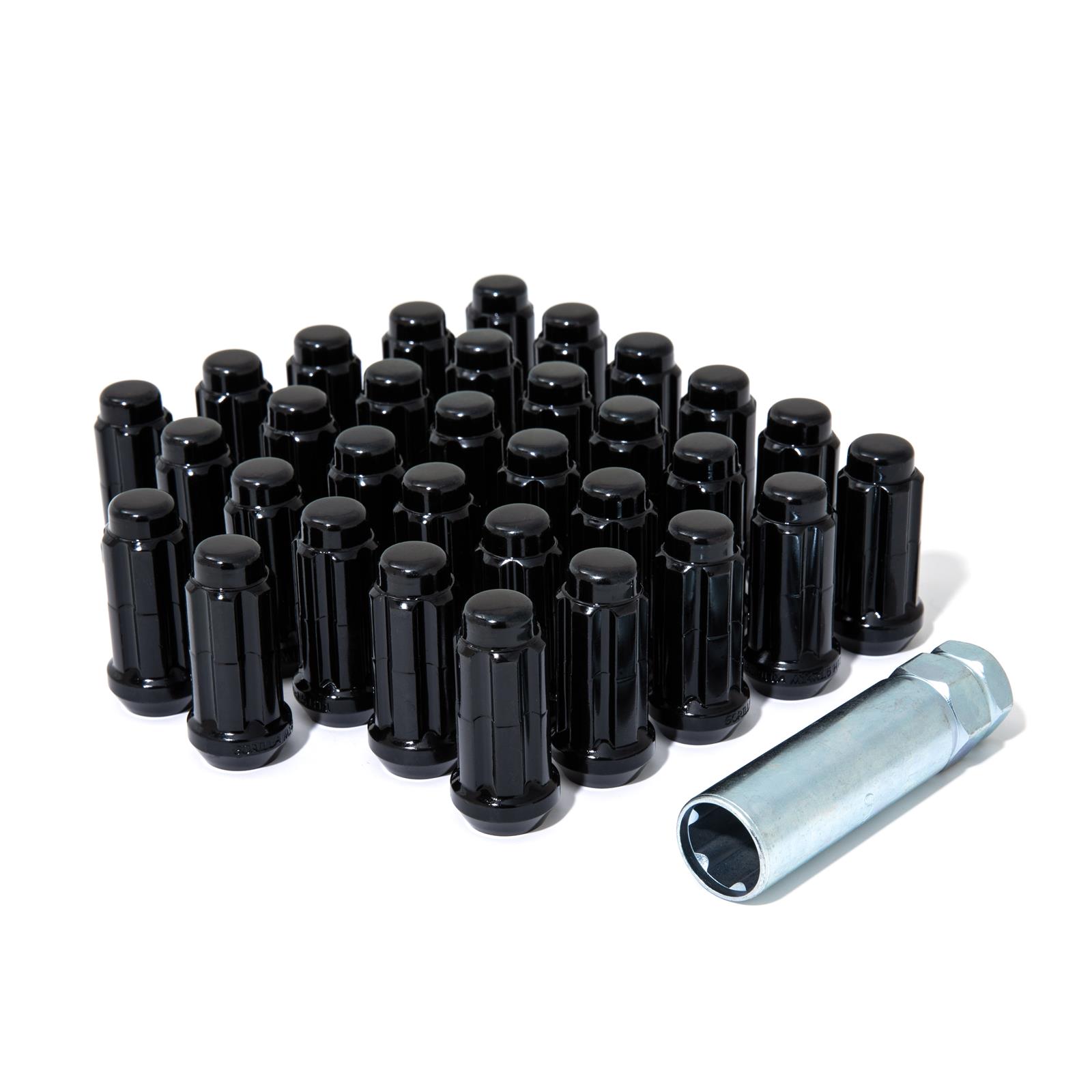

I had never had problems with acorn lug nuts on my GX, but bought my wife one and replaced stock with new wheels and tires and picked up a vibration. Chased it for weeks. Finally decided to get road force balancing (which can solve vibration issues on chunky off-road tires that even perfectly balanced centrifugal balancing can't fix) and the tech said "you need to change your lug- nuts". I didn't believe him, but ordered the ones he recommended that have a shoulder that center the rim on the hub instead of the acorn bevel that most of us are used to. Vibration disappeared.
Very good tip. But I haven't had the vibrations for 5+ years, but certainly willing to give it a shot and see if it fixes it. I have those thin/long style Gorilla brand lug nuts once I got the aftermarket wheels -
Let me know which ones your tech recommended and I'll get a set of those to try it out.

We hadn't had one either for a time, but any time a wheel comes off, and I seem to pull wheels off a lot for different things, the round bottom acorns are suceptible to not aligning the wheel properly. A little bit off goes a long was with heavy tires that already resist balancing. Here's what I purchased. A bunch of variables to consider with high-speed vibration as Red says, but this low-cost try worked for me. The 7mm shank on the end is what creates the added precision. Hope it helps!
