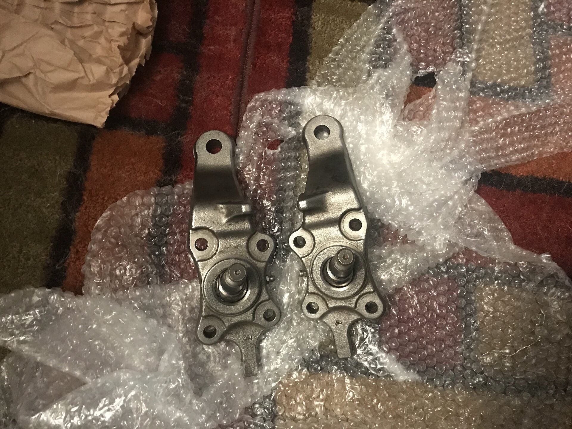

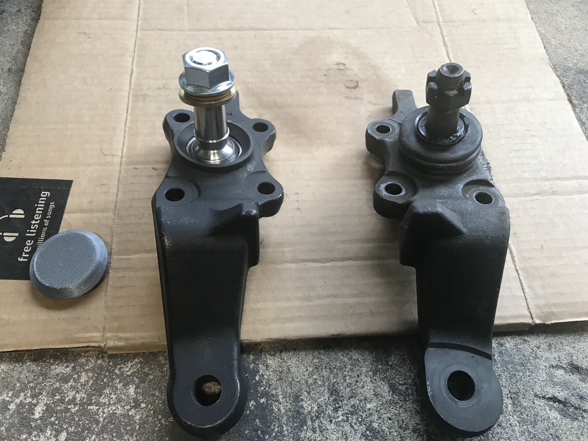

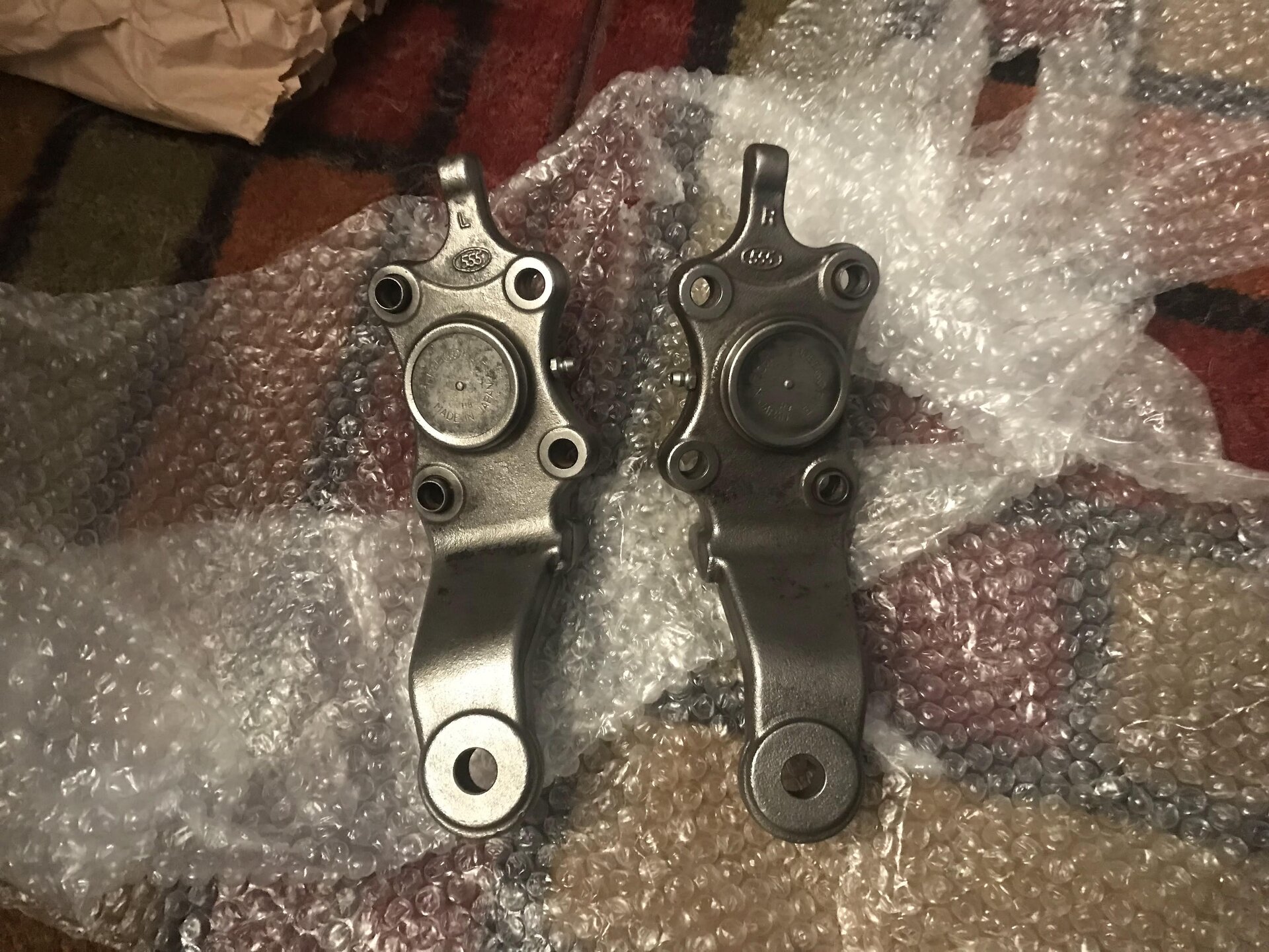

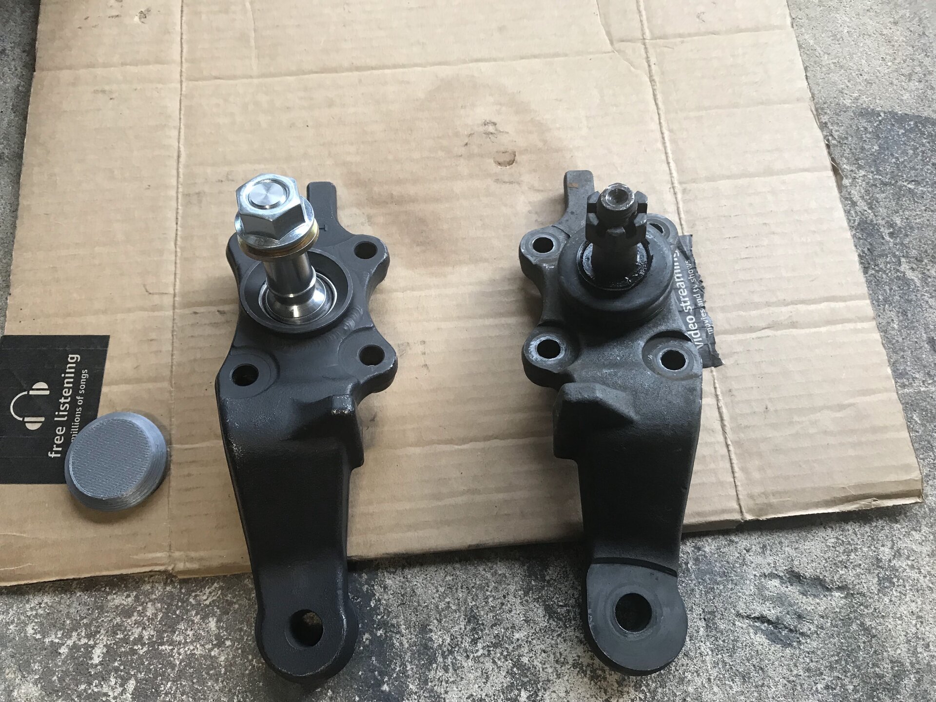

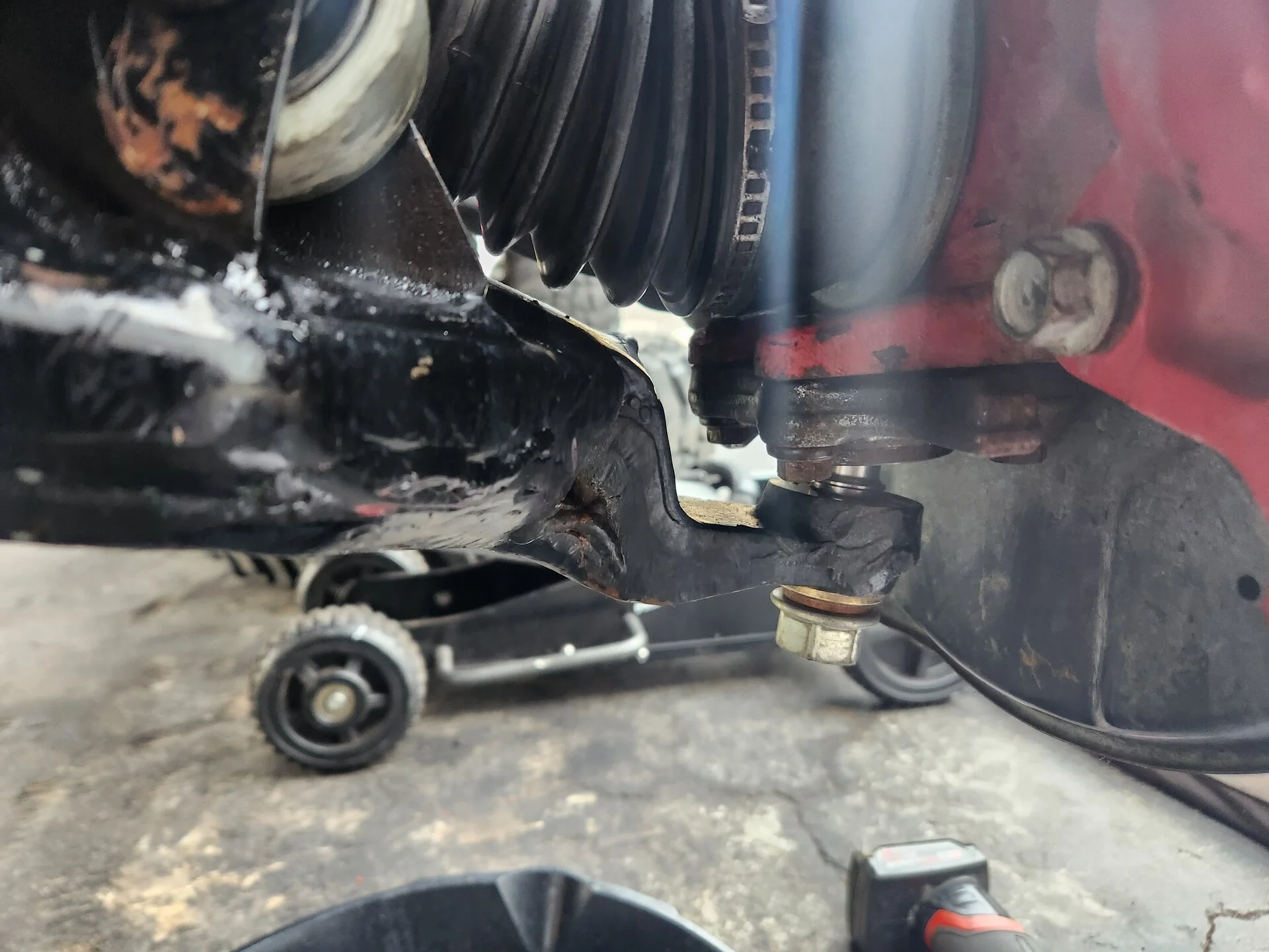

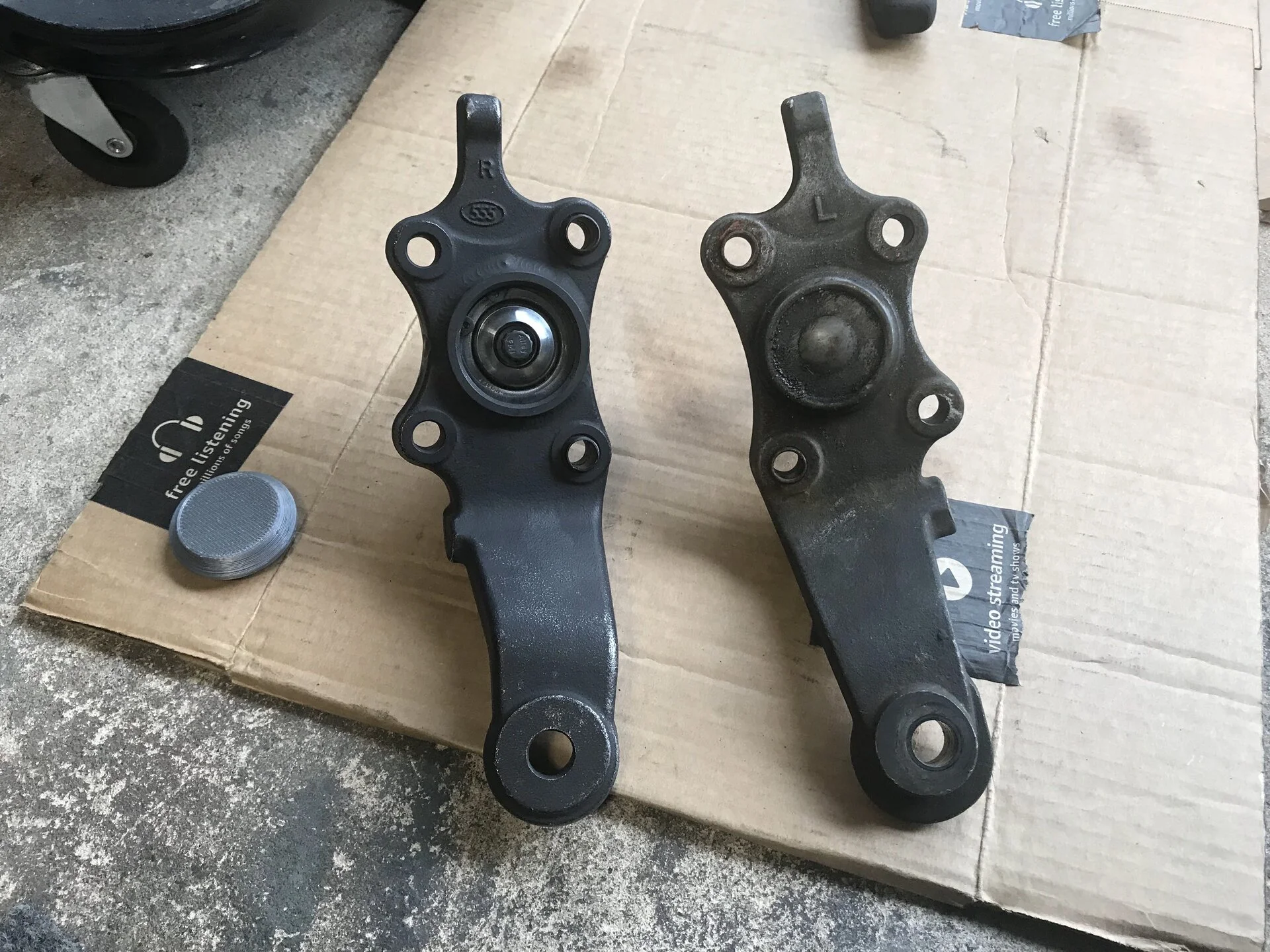

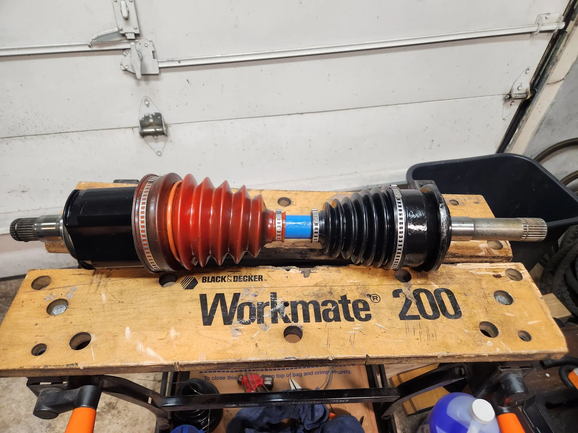

Completed the extend boot mod on a set of used manual CV axles on the 3rd gen. Also checking hubs and suspension since I was working on the CV axles. Pictures of the teardown, inspection, and oiled the uni-ball conversion LBJ's with upgraded ARP bolts from Anonymous Fab (Anonymous Fab that rebuilt the LBJ) Toyota 4Runner T4R / 90’s Prado Uniball LBJ Conversion - https://anonymousfab.com/products/toyota-4runner-t4r-uniball-lbj-conversion

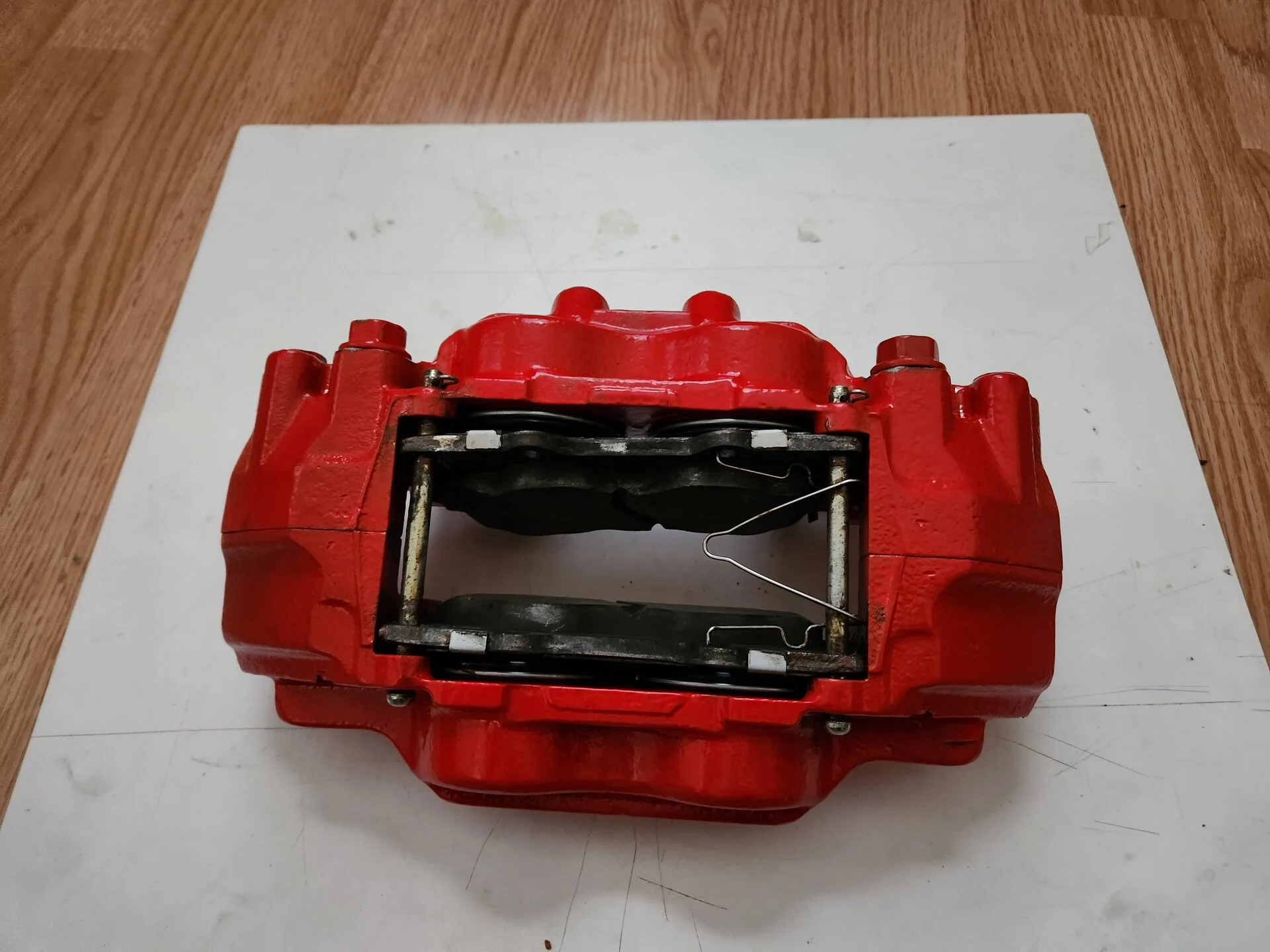

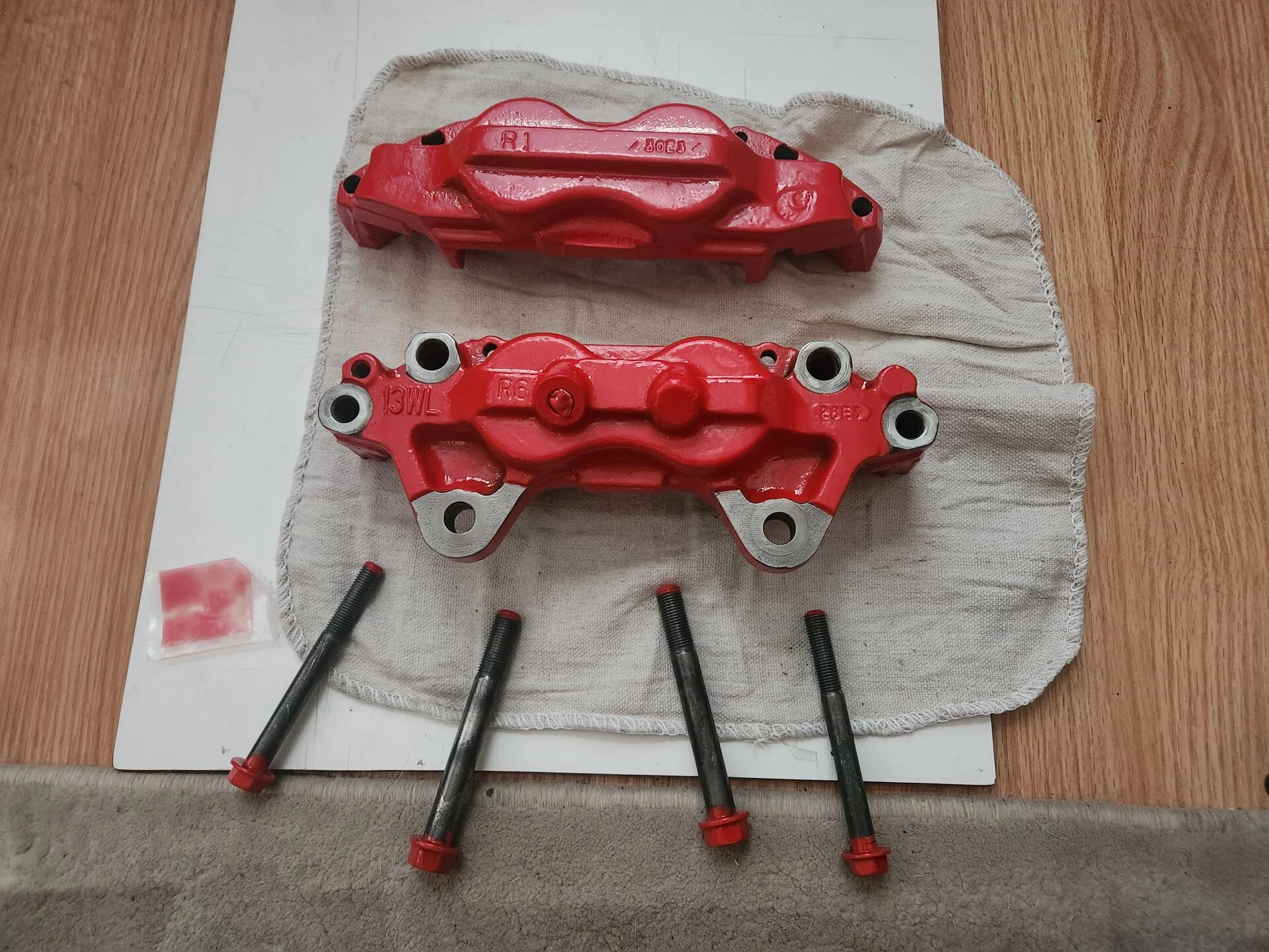

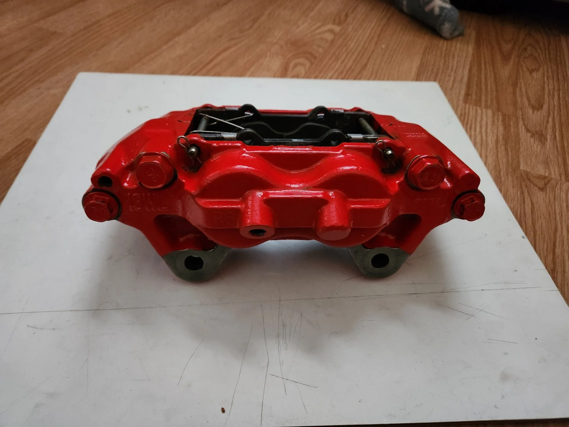

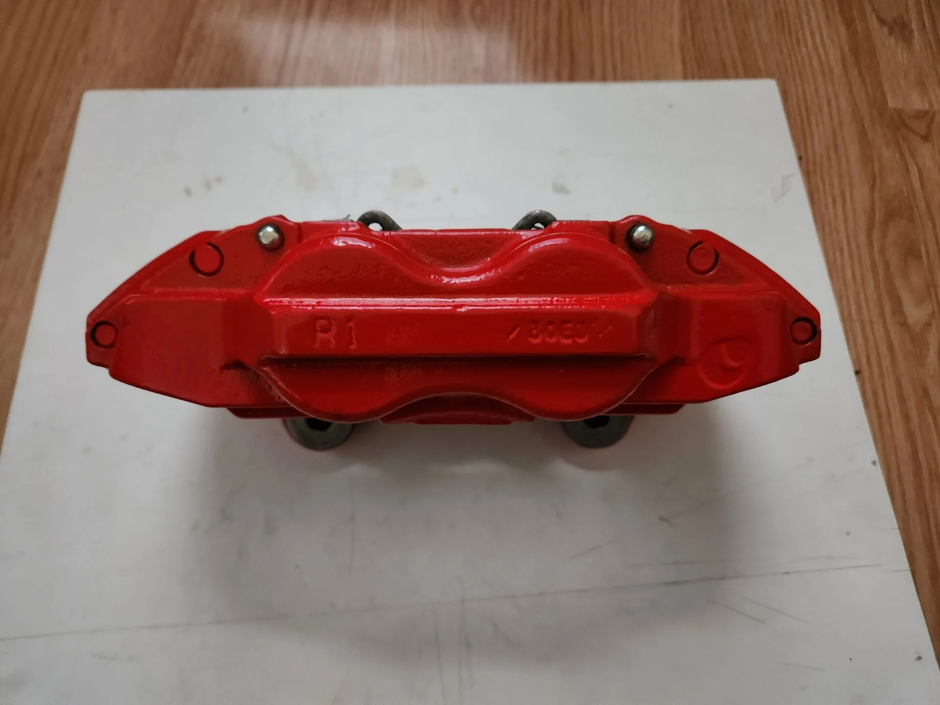

I also had to rebuild the front brake calipers due to seized pistons and then baked red powder coat

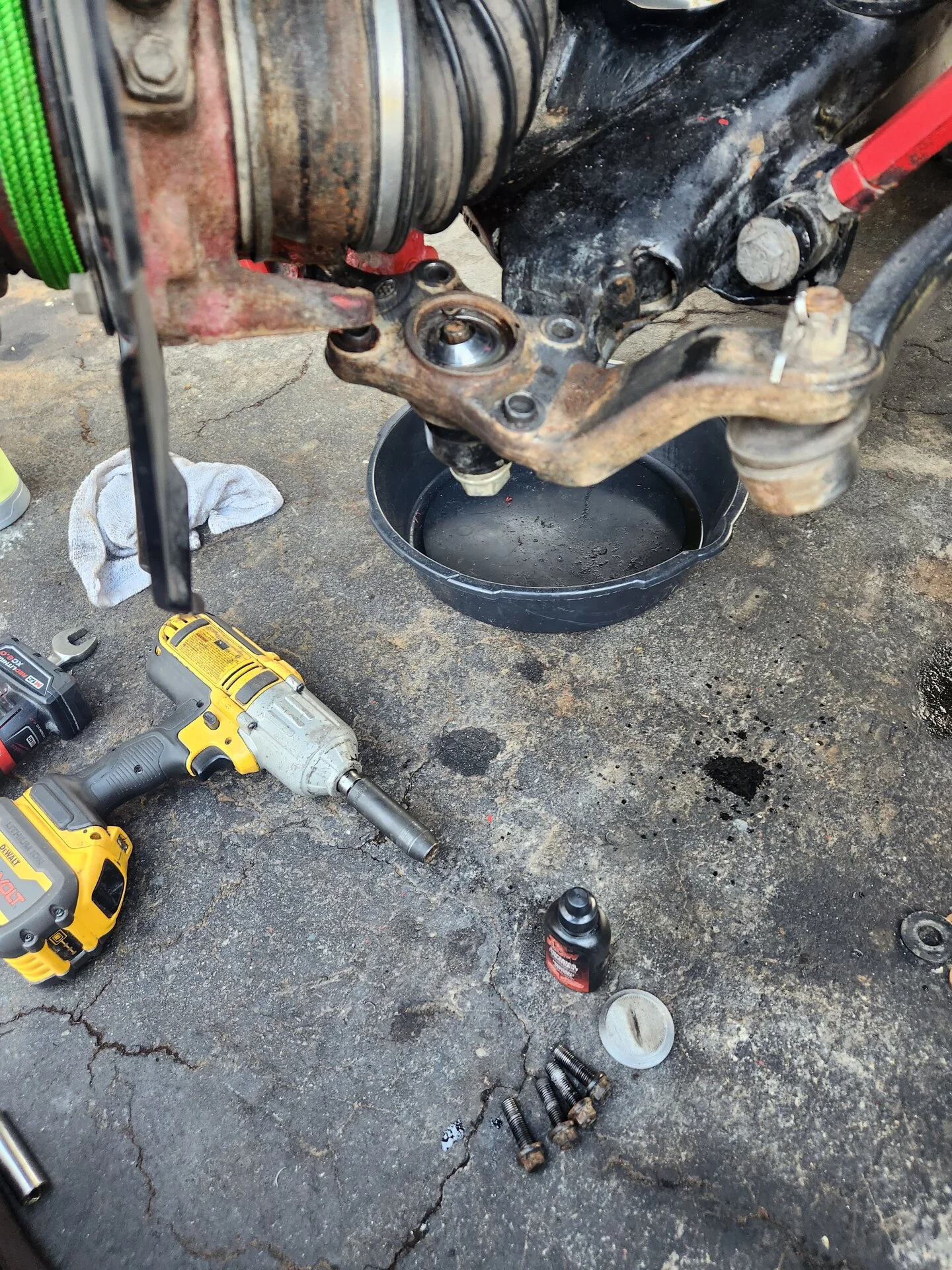

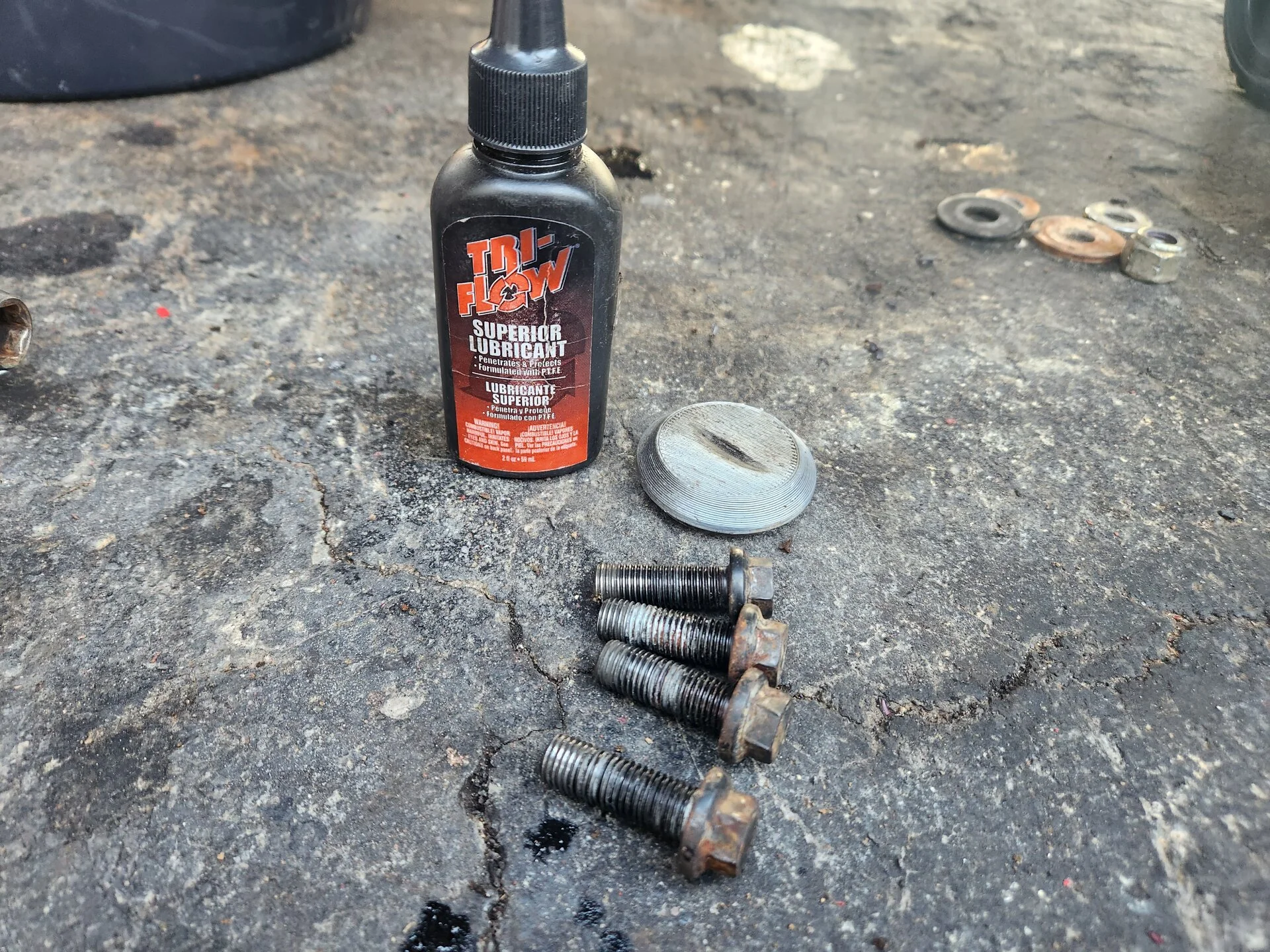

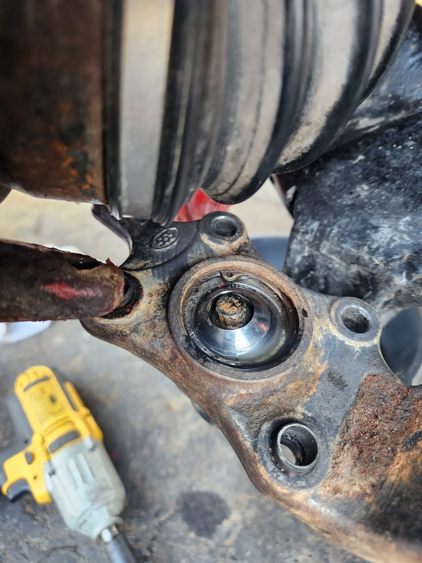

Some picture of the lower ball joint conversion.
So if you have bad LBJ don’t throw them away because they can be rebuilt with a uniball joint. check out Anonymous Fab
He can rebuild them with a uniball joint and you can upgrade to ARP bolts. The lower ball joints are a known weak point on various Toyota trucks with IFS.
