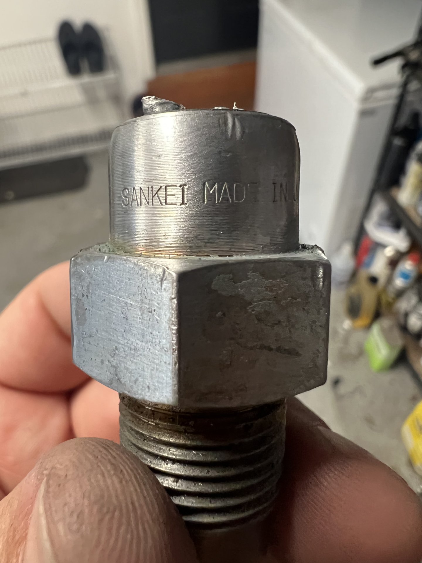

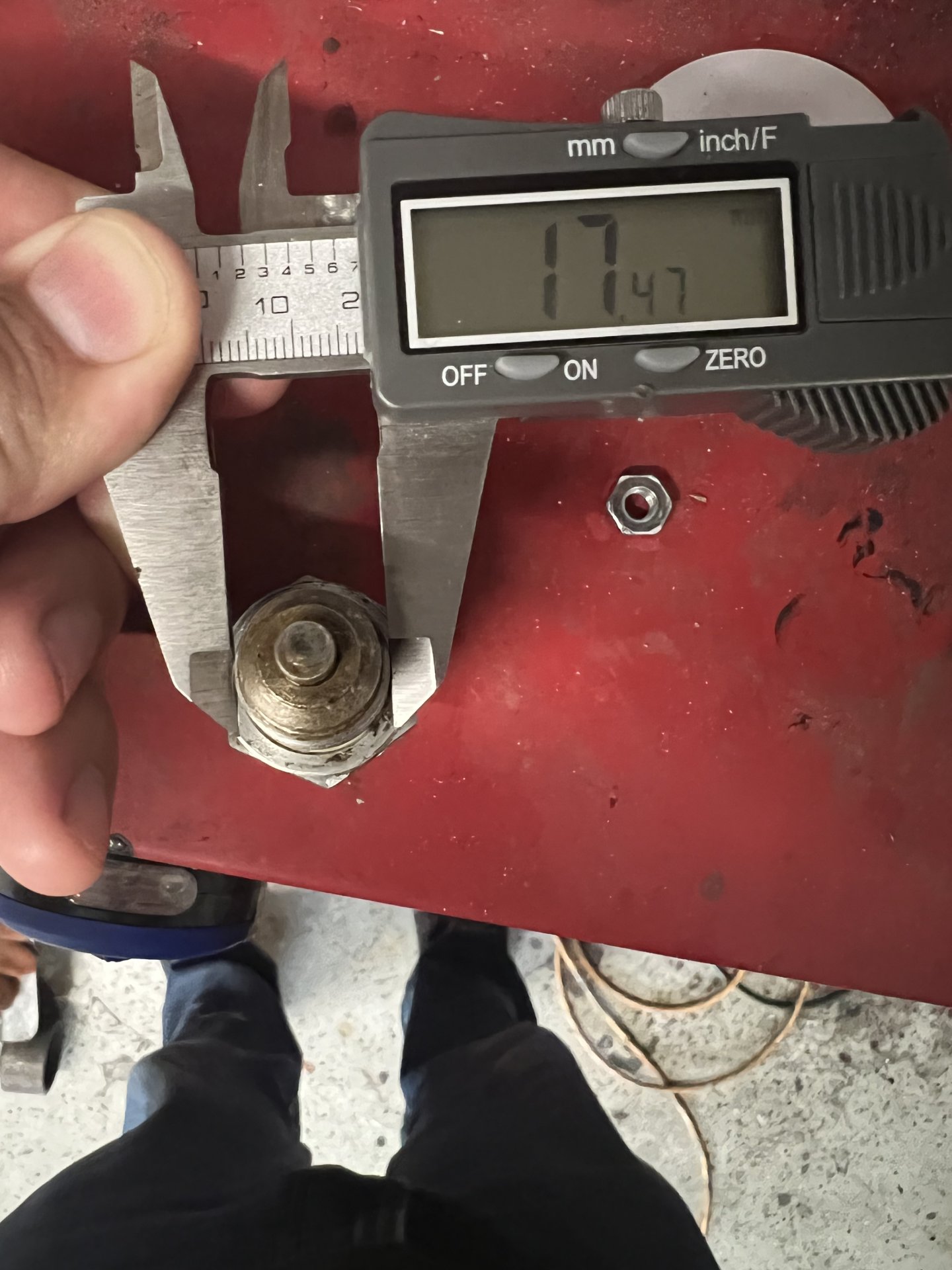

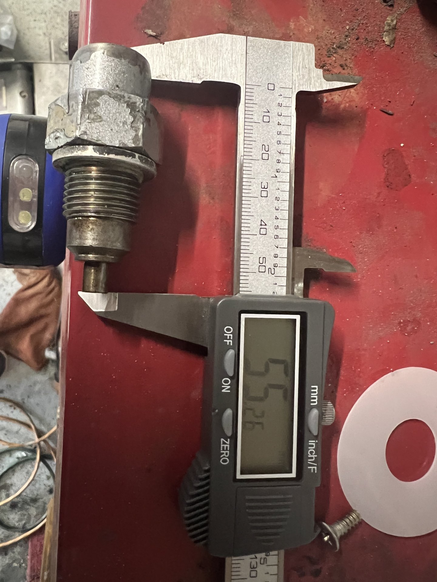

Pulled the switch on my 80 FJ43 and need to replace it
There seems to be an after market one already in mine so I need to know which one to get; as there are different options.
Measurements done in mm
Thanks
See below
Just pick up the factory or aftermarket backup switch for the transmission you have.
Careful buying on on Ebay. I bought on for my 72 fj 40 and it fit but when I put it in reverse it blew a fuse. The light is grounded at the light itself so the switch switches the hot wire. This after market switch grounded out to the case mid-travel and power was off when plunger was fully depressed. I got my money back but waste of time. I took my factory switch apart and married the end that goes in the trans to a plunge switch and it works fine now. Cruiser is out of the OEM one for mine or I would have tried that, but that one is $83 and the after market one was $31.
