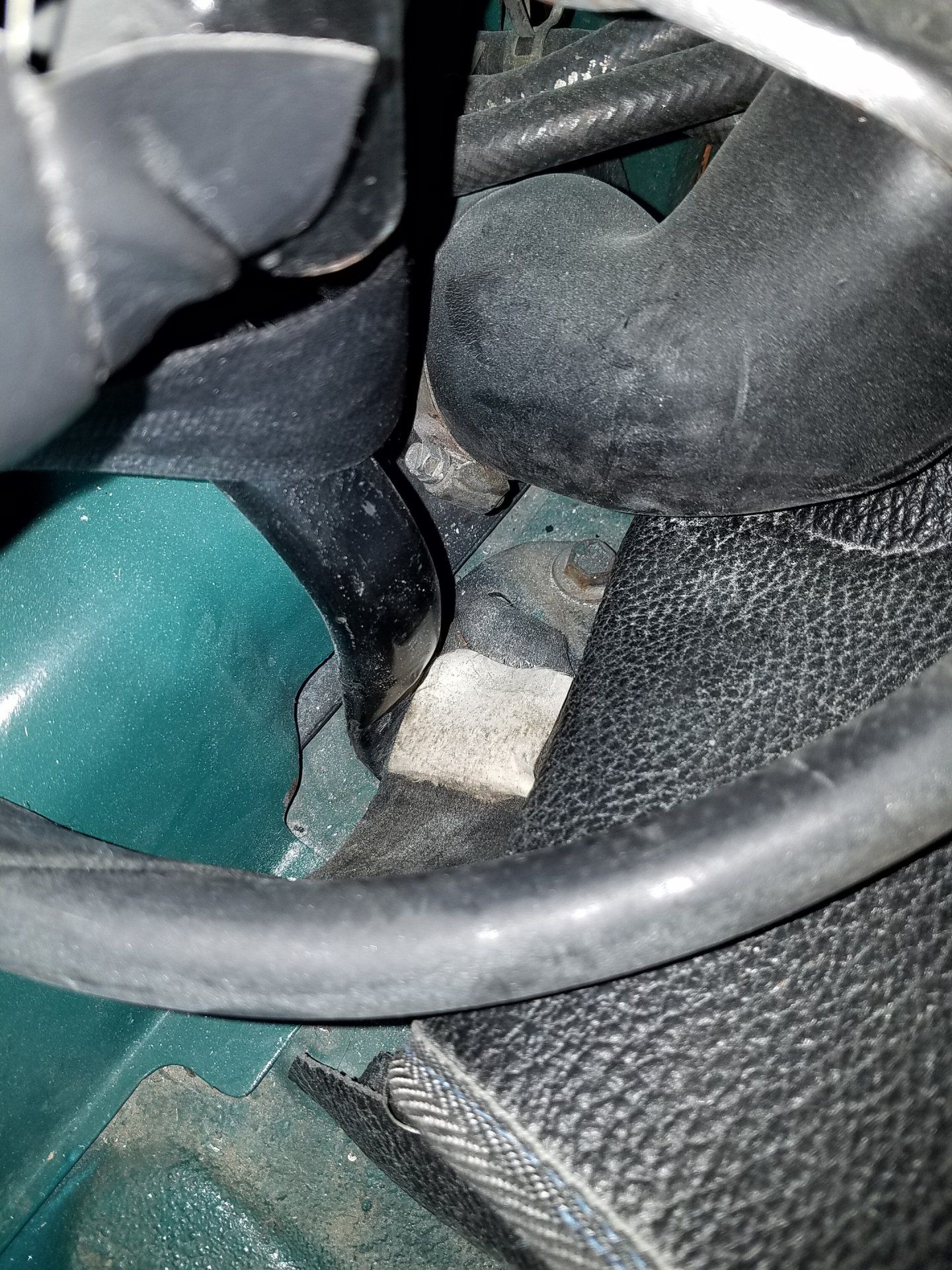

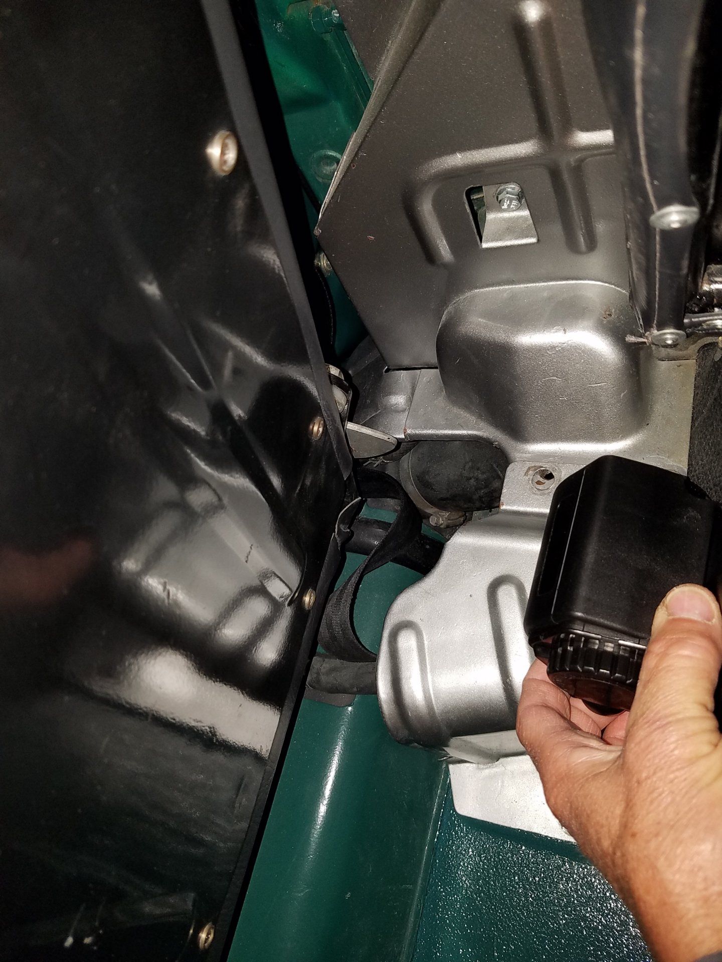

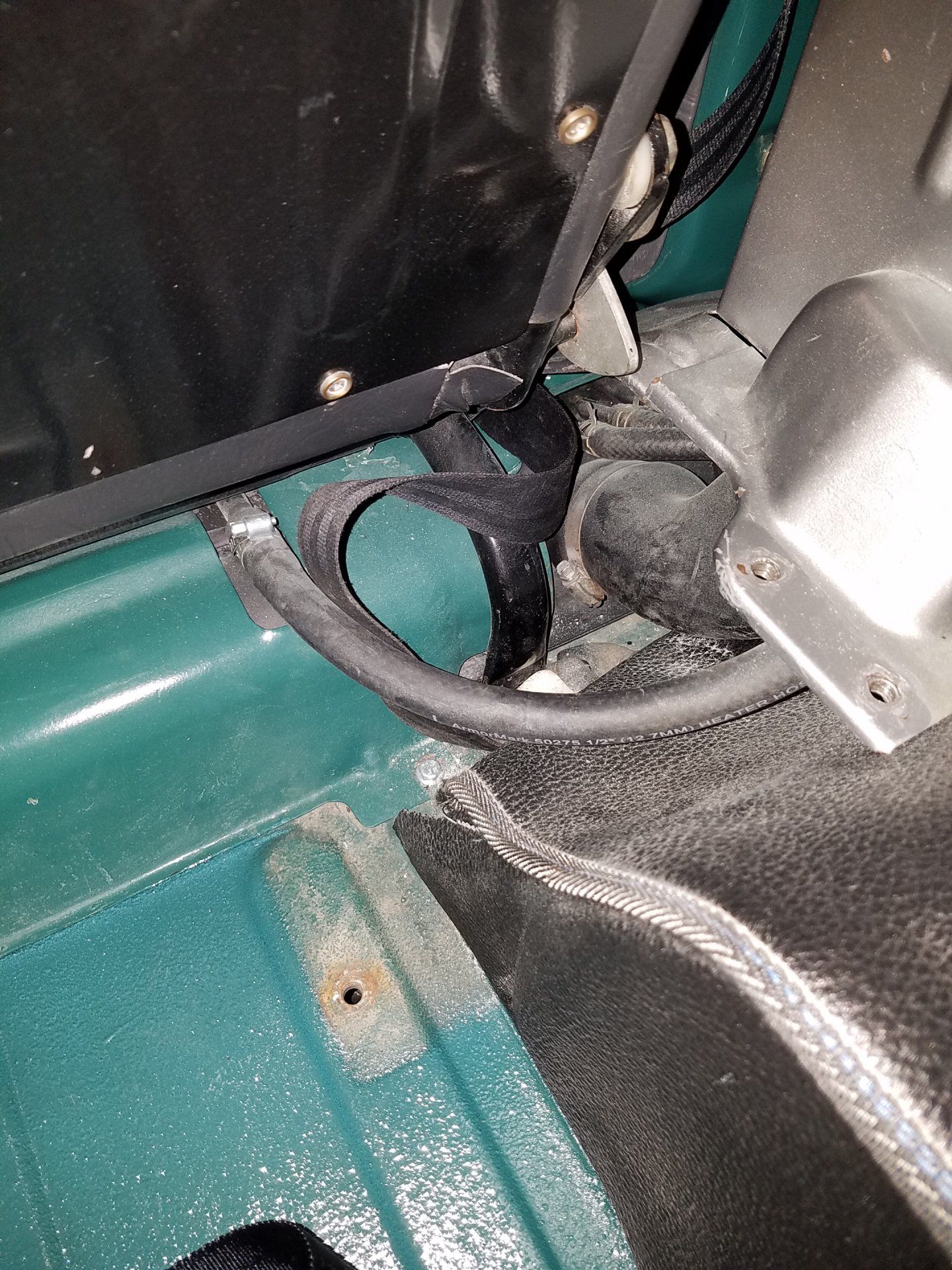

Good morning. I have attached a few photos from behind the passenger seat. I thought I might be able to mount the retractable mechanism but don't have room with the jump seat down.
View attachment 2470964View attachment 2470965View attachment 2470966
Would be helpful if you included some important information like this is a South America cruiser that did not have a roll bar and has a custom top. All Toyota tops from 9/72 thru the seventies in the US market had a fixed nut on top to anchor the three point seat belt. 1/76-2/78 in the US market the hard top side had a bracket to attach the retractable part of the seat belt. After that moved to the roll bar. Different markets it varied. I grab a set of side brackets off a Australian market 84 HJ47RV. What happen in South America in on cruiser with custom top is probably something completely different. Here is what the lap belt on a 10/75 looks lik
Probably help with future questions to include that you have a South America import. Default here is US market cruisers. In the case of seat belts in the US 9/72-12/78 the seat was the anchor until 1/76 when part of the seato belt moved to the hard top side/roll bar. Do not believe 9/72-12/78 the floor was used as a anchor for seat belts.
Thanks, I have found a way to make it work with some of the hardware provided with the purchase of the seatbelts.
