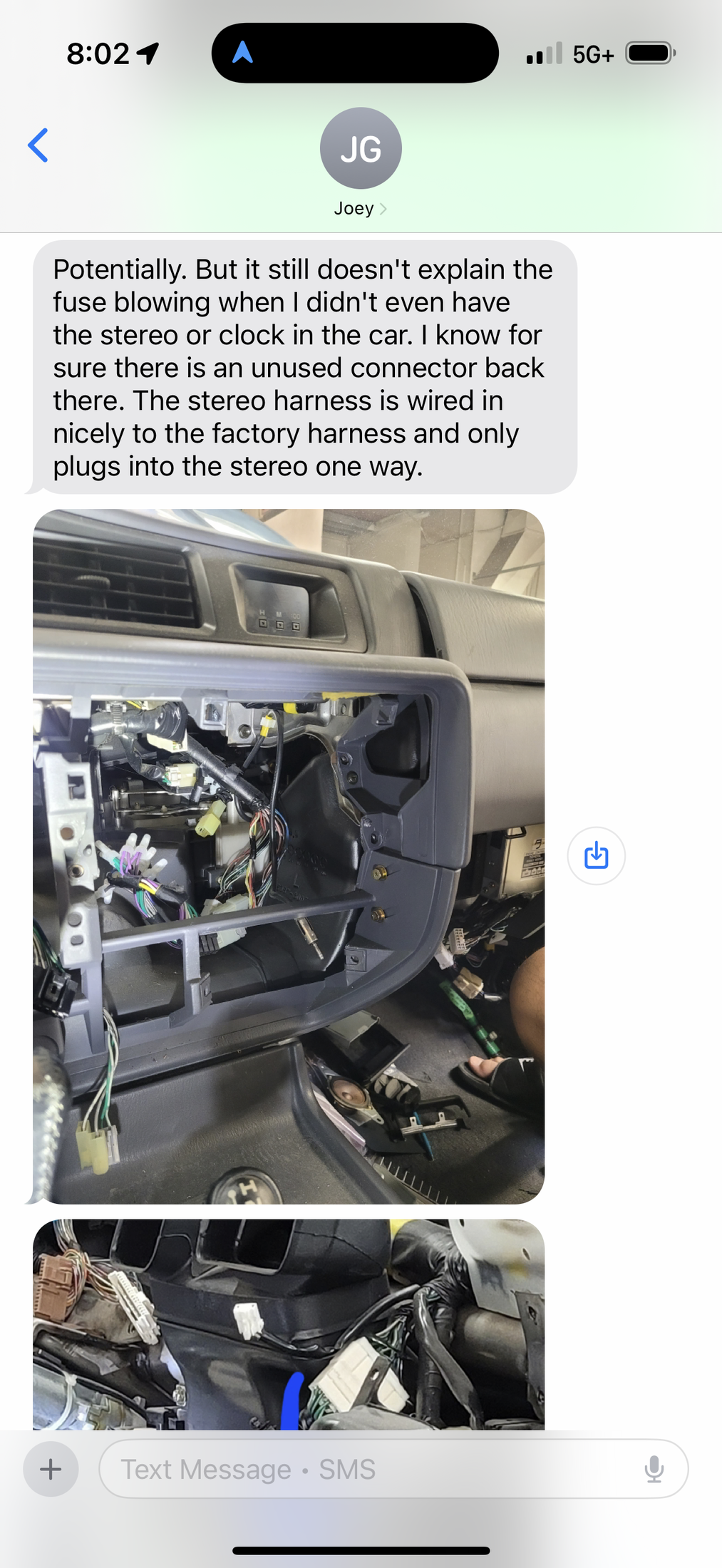

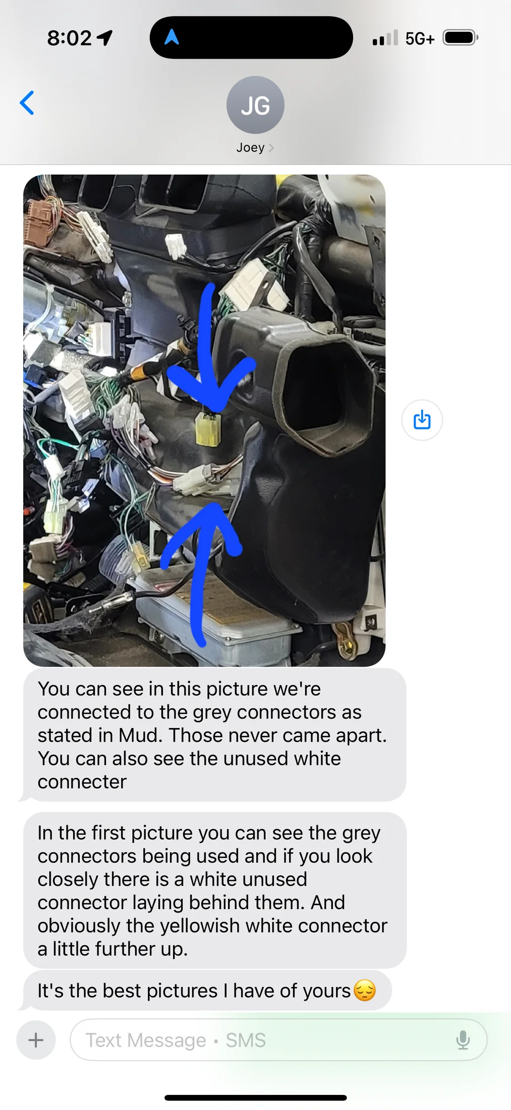

Potentially. But it still doesn't explain the fuse blowing when I didn't even have the stereo or clock in the car. I know for sure there is an unused connector back there. The stereo harness is wired in nicely to the factory harness and only plugs into the stereo one way.

@jonheld wil correct me if I'm wrong, but I believe there are two stereo connectors because one OEM option used used the amp and one did not.
I was kind of hoping for details on your head unit..."wired nicely into the harness" doesn't help me too much.

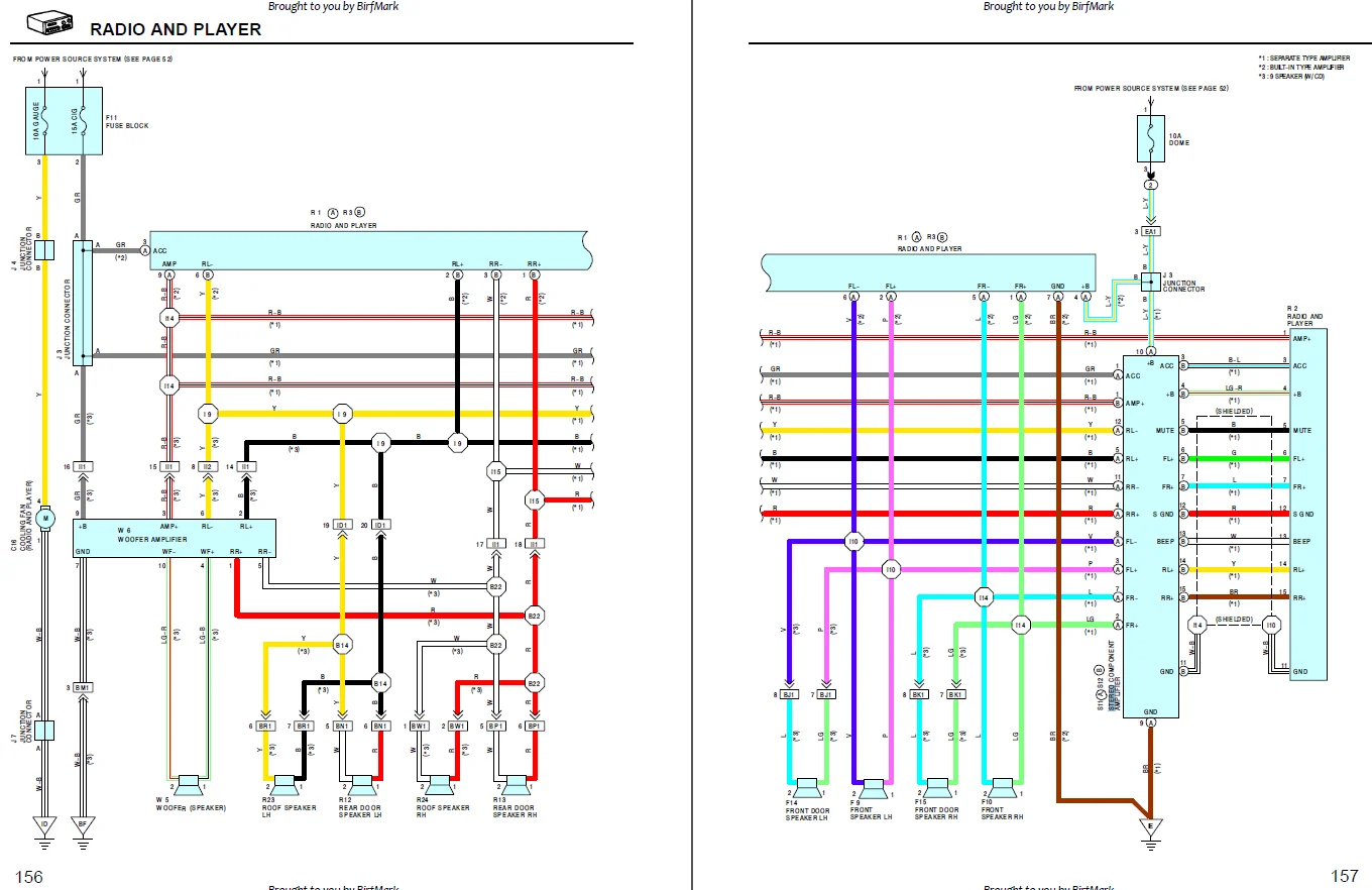

OK, here's the diagram, for reference:

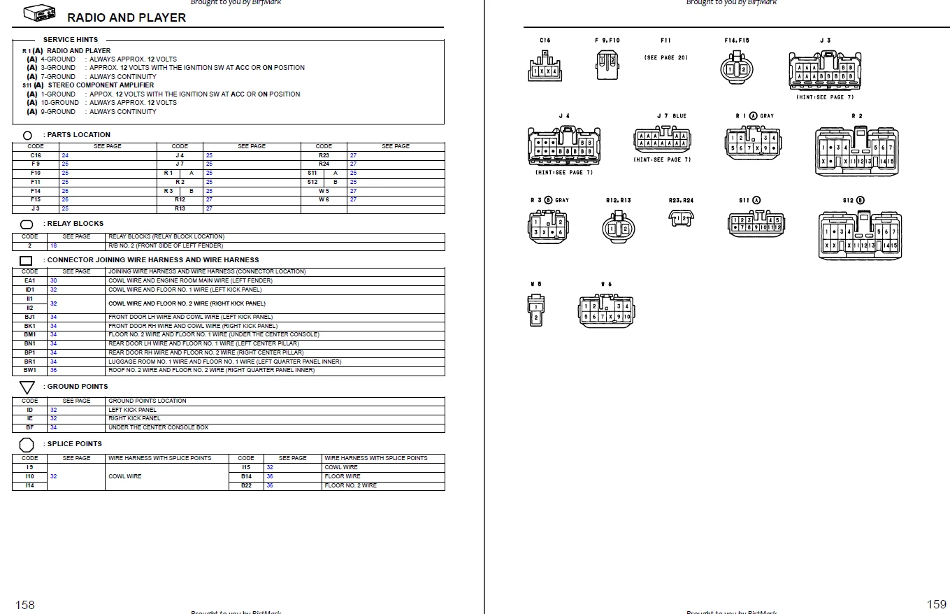

Connectors S11 and S12 (marked with "A" and "B" in circles on the wiring diagram), join the amp and head unit (page 159 has the diagrams of these connector housings, so you can ID them). They share a pair of grounds, in each connector, the typical white with black tracer in "B" at terminal 11 in both connector housings and a brown wire between the "A" connector and the head unit's R1 connector.
I'd start with these two wires and make sure there is no continuity between either end and the body when the power is off. If there is, that's the short.
Since you are sure everything worked before it was unplugged, it probably still does and the problem is a grounded wire somewhere.
The images I posted are from the 1996 EWD. If you don't have a copy, you can download one from the Resources forum.
