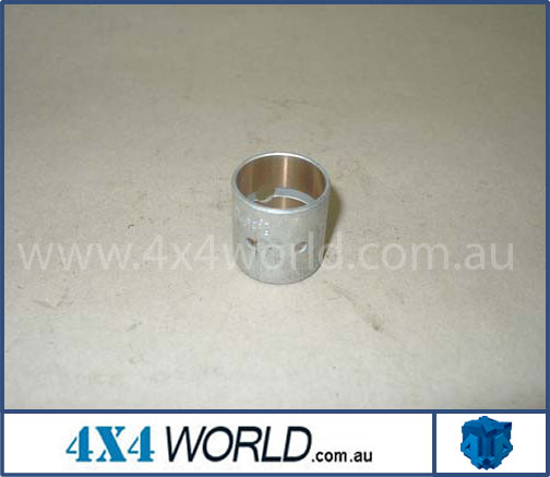

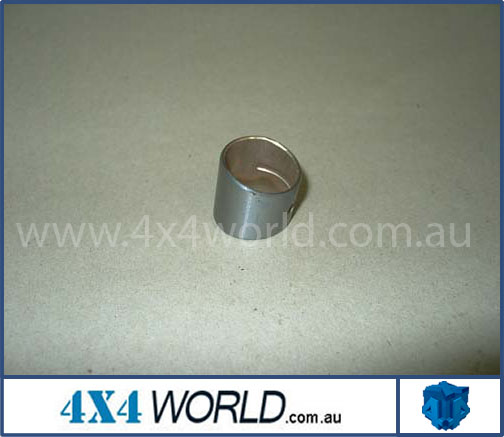

Does the Connecting Rod Bush care about side to side movement on the Gudgeon Pin/Wrist Pin?
Assuming that the diameters of the Conrod's small end, Conrod Bush and Gudgeon Pin are the same and that the only difference between 2L and 3L, other than the 3L Piston being 0.07874" over, is the width of where the Conrod Bush lives. - Could I use the 2L Conrod Bush that lives nicely in the 2L Conrod but is narrow inside the 3L Piston, or could I use the 3L Conrod Bush that sits outside the ends of the 2L Conrod but is the correct width for the 3L Piston? :clap: Either of these scenarios OK?
