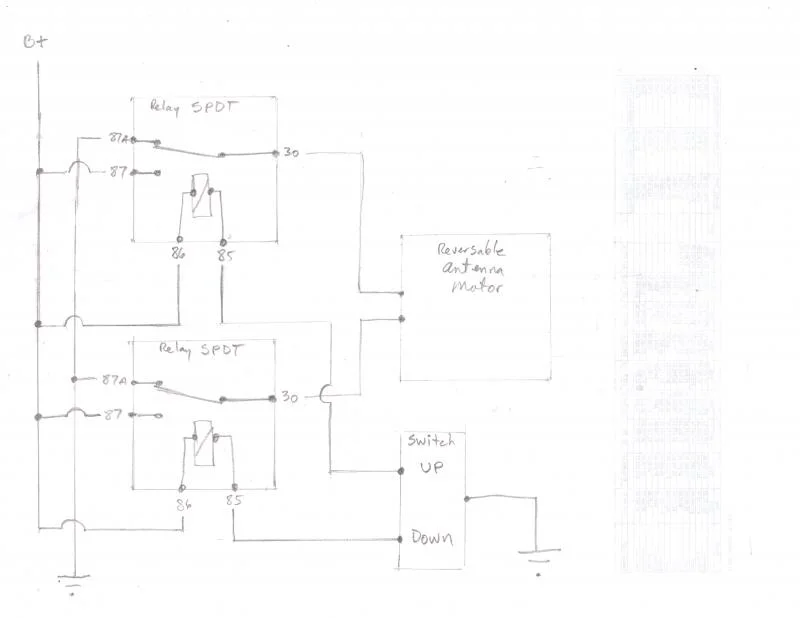

I am attempting to install a factory antenna in a LJ95L Prado fitted with an aftermarket radio, however I was not able to complete the installation due to missing information about the factory antenna wiring.
The install required me to assemble a relay circuit to power the antenna up and down using a constant battery power and a radio power supply (the blue wire coming out of most heads). See the attached sketch of the polarity reversing pair of relays that I cobbled together.
The problem is that there is no apparent limit switches in the antenna motor, at least in the two pins I found that run the motor. This detail means that there is an excessive draw (6 amps) through the stalled motor when it is either all the way up or down.
The factory radio may have housed the power antenna circuitry I am missing, or there may be a separate controller. This would be good to know. I feel the current cut off circuit can be duplicated if necessary, if I could understand the antenna internal circuitry. It is a 6 pin connector and I believe someone on this board can help me suss it out.

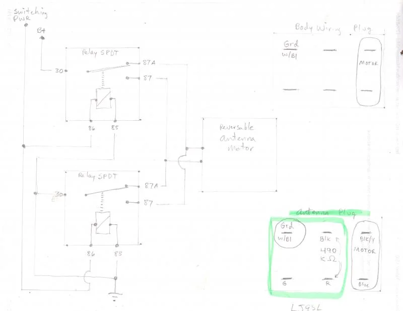

See the green highlighted sketch of the antenna connections. Three known pins are identified and understood. They are circled.
The other three pins have no relation to the circled pins, as measured with an ohm meter in any antenna position. Also, the readings between the pins do not change with any antenna position. There is a 490k ohm resistance between the center pins at any antenna position. It is of such high impedance that a limiting diode is suspected.
