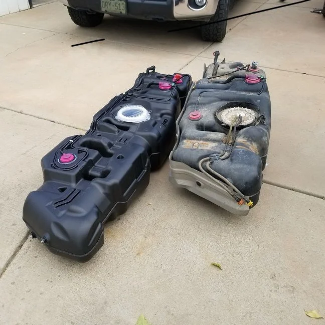

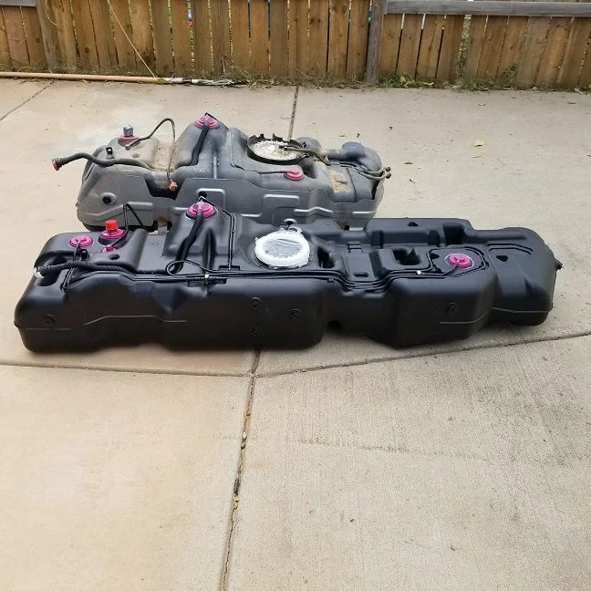

i got sick of abusing the letter "e" on my fuel gauge and decided to step up from
the little 26 gallon tank. original plans were to get a transfer flow 46 gallon
tank, but when i found they were discontinued (but with a couple still in stock), i
did some soul searching and realized that was maybe a bit more fuel than i need 99%
of the time and i didn't want that much weight.
looking at the oe tank, it's about 60lbs lighter dry and even with an rci skid plate
is still about 40lbs lighter. pricewise they were about the same.
when the box showed up, i thought the tank was really well packaged in an enormous box...nope...the tank is just enormous. (note: the retaining ring on the new tank did not come with the tank..i had put it there so i didn't lose it. also, 26 gallon tank is not taller...it's sitting on a roller)
View attachment 1823338 View attachment 1823300 View attachment 1823301
