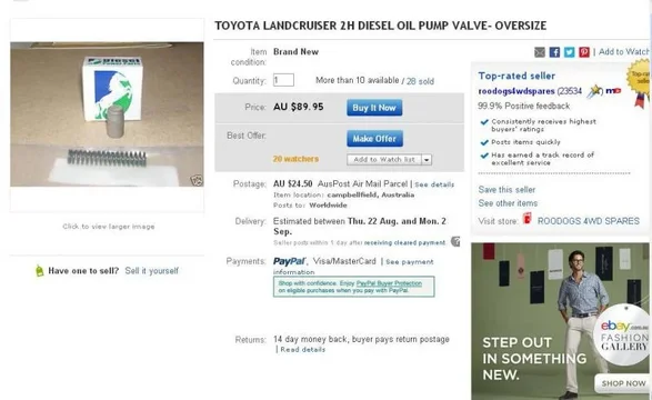

My question is can you fellers in the US or Canada facilitate me with an address where i can buy this valve as i can only find one bloke that sells them here and he wants over $100 plus postage and i consider this a rip off .Thank you all

It does seem rather expensive.
Engine Australia does sell that same Taiwanese brand. So perhaps you should compare their price?
However I doubt you'll find it much cheaper anywhere because when someone produces a part for such a limited market they usually need to charge extra to recover their tooling-up costs.
