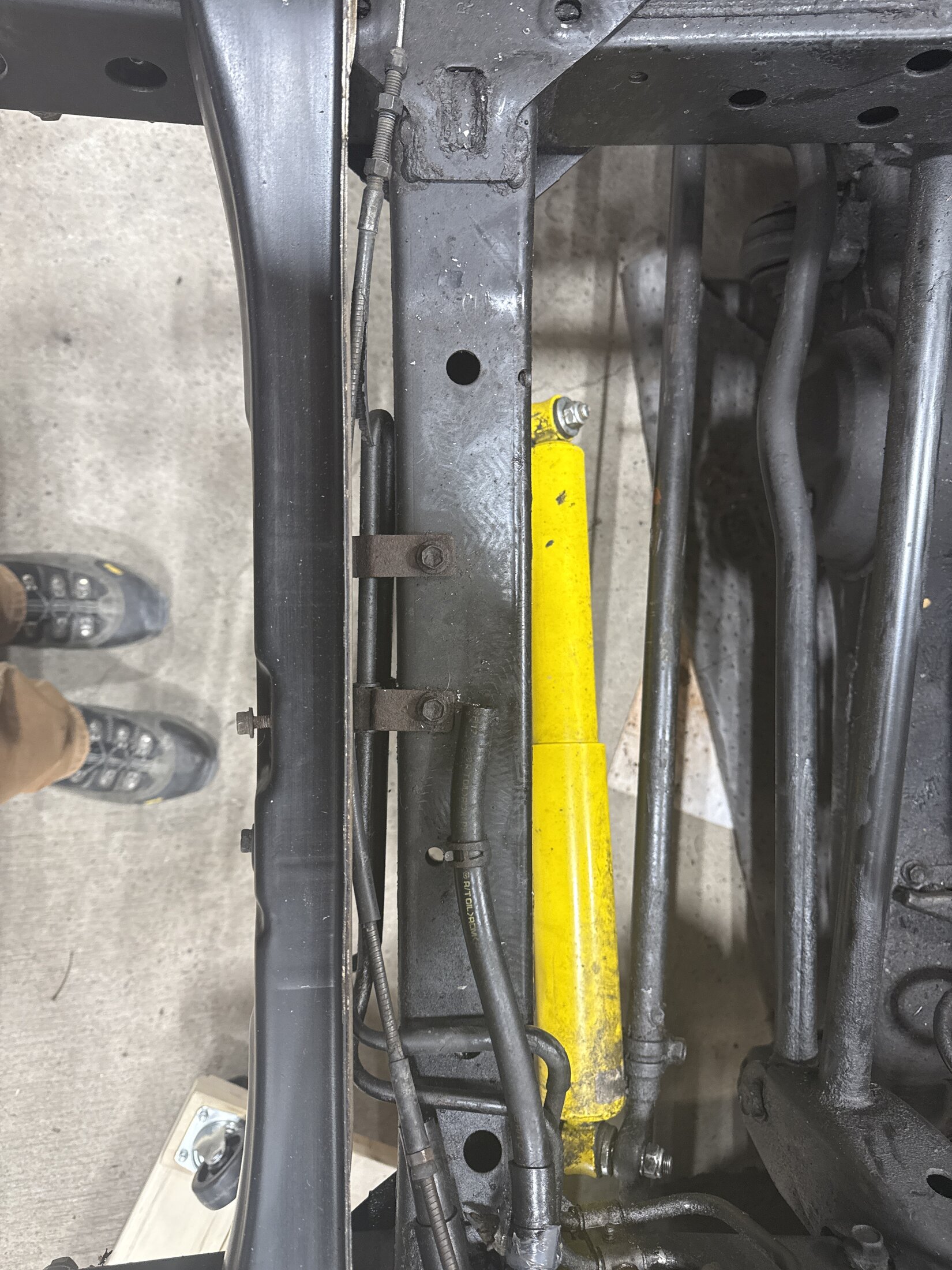

The only two bolts that hold it on are on top of the front frame and a bolt that holds the lines on driver frame rail.

I ended up buying an OEM PS cooler and replaced in-kind. Removing the radiator exposed those two bolts @Fj80oregon has pictured in this thread. It's a pain wriggling that mangled cooler line in the engine bay, but I was able to get it in. Also ended up replacing the radiator while I was in there anyway since I think it was original and I didn't have a clue when the last time the radiator was flushed.

Honestly, after the PITA time that I had just removing my paperclip OEM cooler just trying to keep it in tact, it would be a real pain to try and install a new/used one with the way it wraps up the frame...just go with the Derale setup if it's what you need for your repair.
One quick note, I did use some clamps on the push lock connectors as I never trust them even though they are low pressure in this application. The 2 male flare to NPT fittings go on the cooler for the line along with the angle to hose adapters, you can just slip the hose it over your existing pipe further up where your flexible lines come off from the OEM paperclip cooler.
