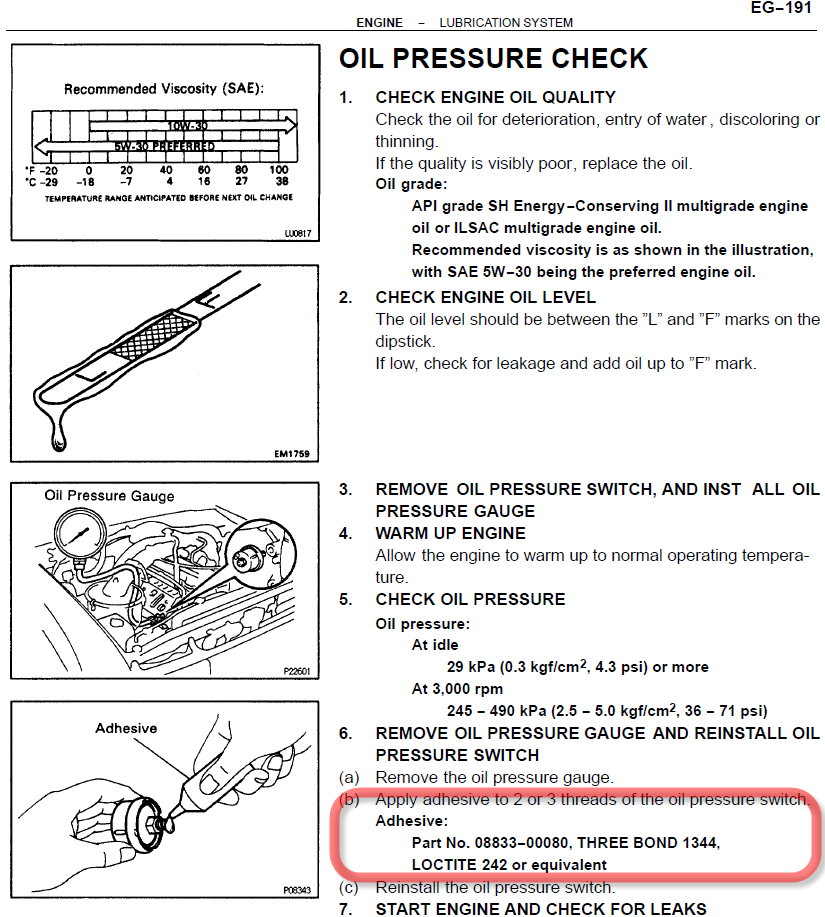

Looking at FSM, pg EG-183, it appears to me there is no washer, o-ring, gasket, etc. - just some thread locker on the sender.
There's also no spec for how tight it should be (or any guidance - e.g. - turn until it seats, then apply 1/4 turn), which I found kinda strange since the FSM is usually very precise and specific about torque specs, how things must be measured, installed, etc.
I'm happy to just put some blue Loctite on it, cinch 'er down until it's tight, one ugga dugga and send it, but wanted to check with the hive mind because the FSM felt very oddly vague about this.
Thanks in advance!

What are you referring to? The Oil Pressure Switch? It calls for loctite 242.
I have always just used a little FIPG and don’t over tighten it it’s a tapered British standard pipe thread.

I was so impressed that someone actually read a manual and took the time to quote it, that I opened my sets(s) to find out what was required, since I have this on my to do list, and haven't looked it up yet. Imagine my surprise when none of the manuals list anything related to the oil sending unit on EG-183. What year do you have and what manual are you using?
FWIW, only the 1993-1995 manuals have "EG" sections. The 1993-1994 EG-183 are emission control, and the 1995 EG-183 is the thermostat installation.
This is what the 1995 manual says about the oil sending unit:
I have the 1997 L.C. Repair Manual from Specter Off-Road, RM5100.
I see the same info/graphics as you, but mine happens to be on EG-183.

Don't overdo the sealant, the sender needs to ground to the engine block. I install dry or with just a smear of liquid thread sealant.
Don't overdo the sealant, the sender needs to ground to the engine block. I install dry or with just a smear of thread sealant.
+1 @AussieHJCruza - thanks for the pro-tip!
I typically try to avoid gooping things up and take a more judicious path, but this is a great reminder. Without a good ground, there's hardly a point in replacing the sending unit.

lol ya I was like wtf EG-183 is like the VSV so I had to dig in the back.
