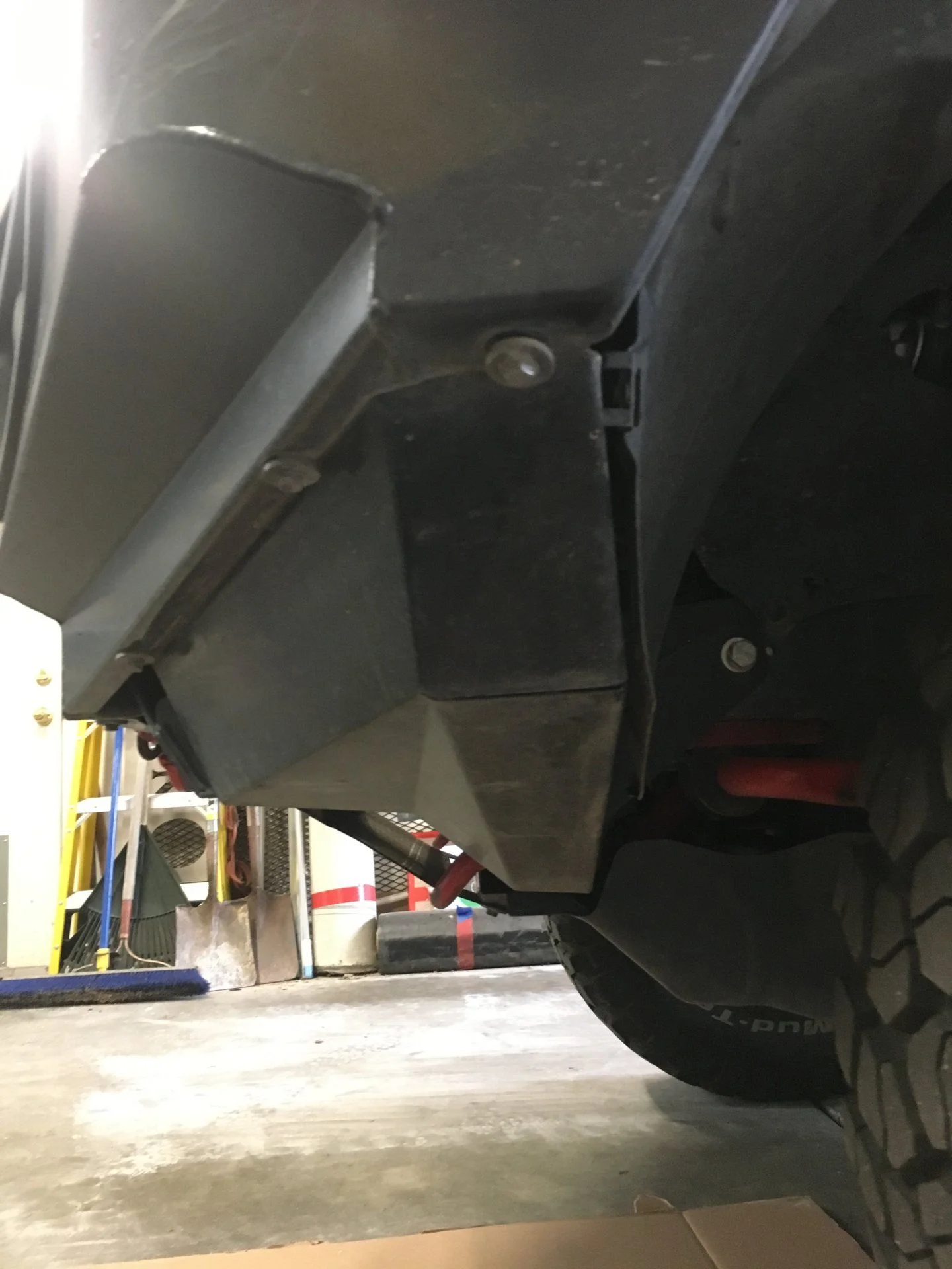

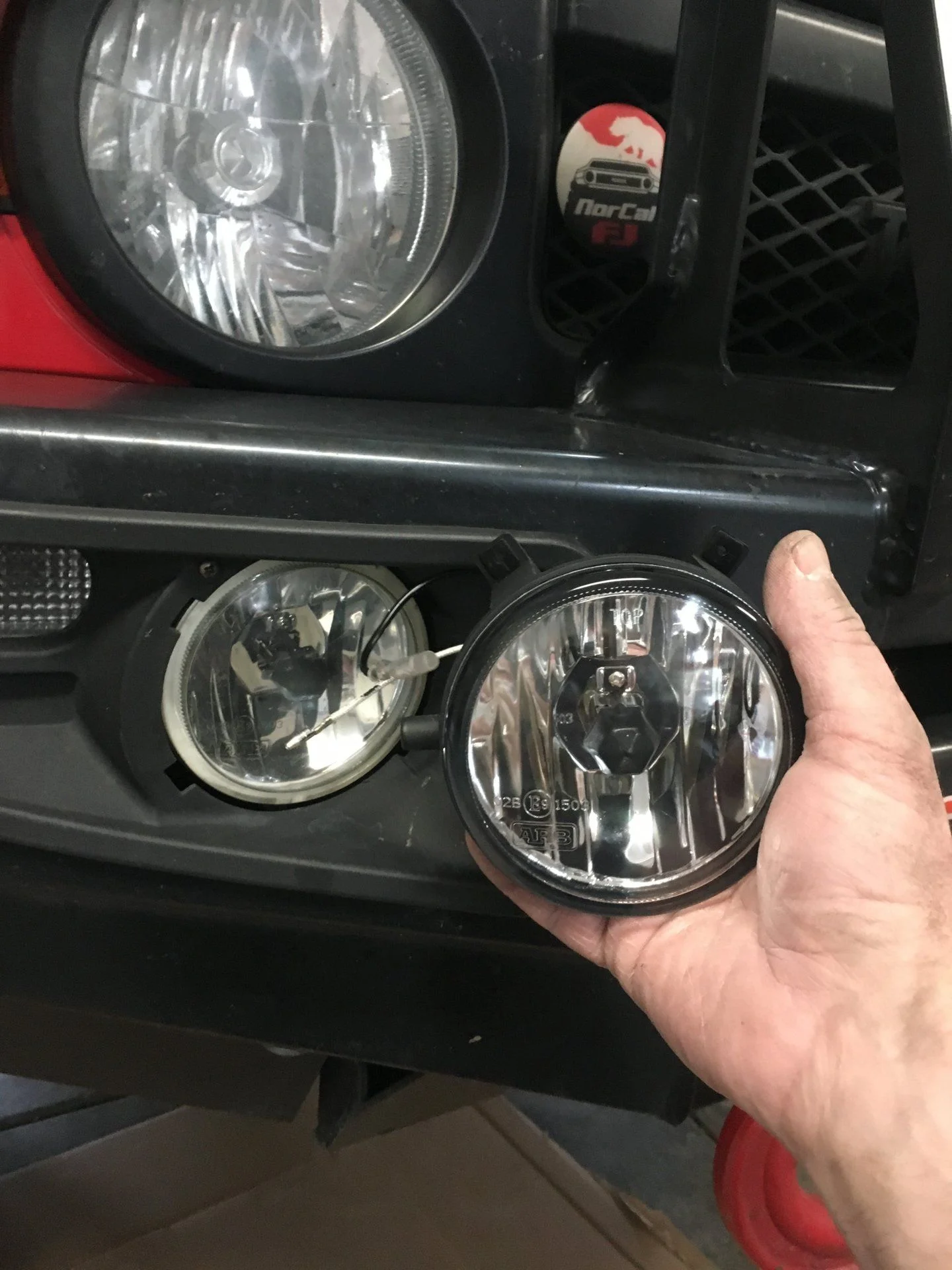

Replaced both fog lights today though only one broken. Had to remove lower sheet metal panels. Lights were easy enough to replace, plug in wiring, plastic tab to locate lamp. Changing the screw/spring adjuster was a real pain though, hard to locate, took a while. Pics here; Look at the lens color difference after 6 years.
