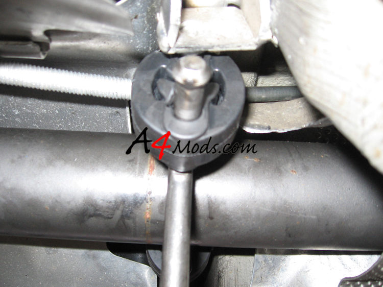

This isn't mine, but it gives you the idea.
