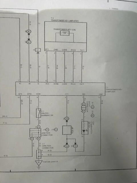

today I have been checking the wirering. I have checked if the connectors are wired correctly (pin layout) and if the colors of the whirring is also ok. Everything checks out. The ecu connectors A,B,C are ok, the immobiliser connector is OK, the connector under the ignition is OK. I have checked continuity also and according to the diagram everything should be in order.
During my reading of the electric plan, I came across something that is on pin 8 of the transponder key computer. "J/B eu".....
MMM what could that be???
J/B... I think 'junction box" or am I wrong? under J/B ecu the wiring goes to 'cowl side panel LH'
I have opened the fuse box in the cab and there appears to be some ic's in it....
I think that the previous owner tried to start te car with 24V ..... I had to replace: engine eu, abs ecu, airbag computer, immobiliser.... could a defect in de fuse box "ecu" be the issue????
Is there an ecu in the fuse box of the cab??? If Yes how can I check it iff it's ok? All my fuses stay Ok.
Coud it be the signal isn’t getting to the engine ecu? i have checked continuity and its ok. Shoud I buy another immobilizer ecu? Or is it the engine ecu?
