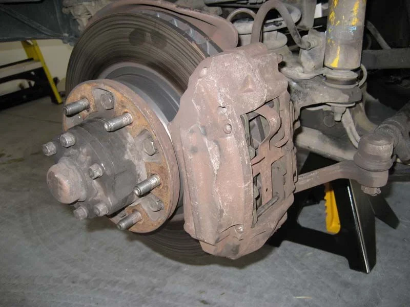

Started by getting the truck solid on jack stands, and removing the front wheels. Old caliper looks like this.

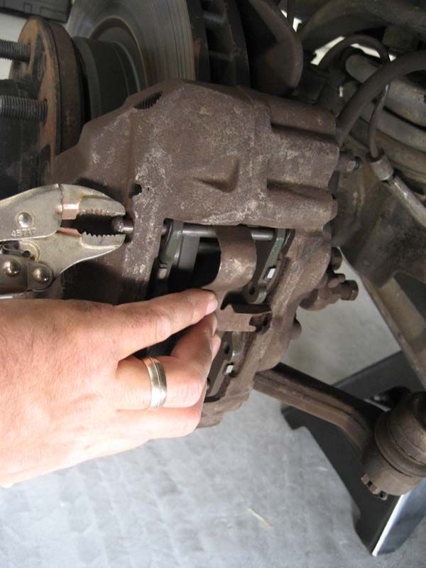

"Looking at the rotor, the brake caliper is on the left. Get a good light and examine the back side (left) of the brake caliper. You will see a thin little bent wire clip holding 2 guide pins (each pin approximately 4" long) that hold the pads in. Do not pull the clip out of the guide pins just yet. Using a pair of needle nose pliers, I pushed the middle of the bent clip out of the hole at the center rear of the caliper gently. You will have to flex the clip a little-just be gentle! Once it is out of the hole, use the needle nose plyers to pull the clip out of each pin, again gently (I had read that if this breaks, you need to replace before driving - after looking at it, I would think that 2 cotter pins (1 per guide pin) would also work."
This is fairly simple, the little wire clip is easy to recognize. Be careful, its a fragile part!
Next picture is of removing the first holding pin, while keeping the spring clip from shooting across the garage:
"With the bent wire clip out and placed in a safe place, put your hand on the flat metal spring clip that holds onto both the upper and lower guide pin shafts. Slowly pull the upper guide pin out and catch the flat metal spring clip (it will pop out if you do not have your hand on it."

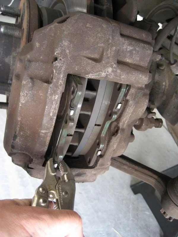

Then removing the pads, one side at a time.

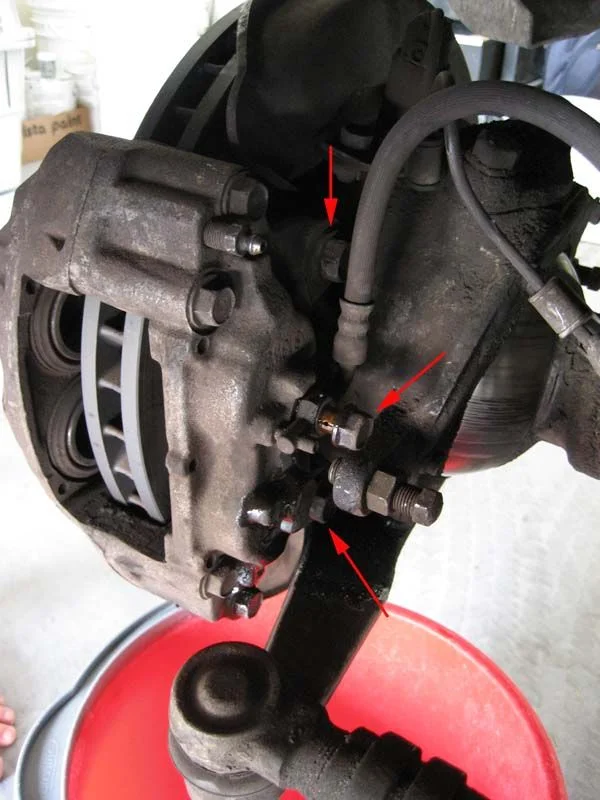

Up next is removing the caliper itself. There are two bolts which hold the caliper in place. They are shown in the below picture. You will also need to remove the brake line to the caliper itself, which is held in by the third bolt pointed to. Its handy to have a 3" extension to get the caliper bolts out. Mine were torqued down TIGHT.
Note the bucket below the caliper. You will lose a fair amount of brake fluid when the bolt is removed. Take care to save (or replace) the small metal washers that are on the brake line bolt, there are two of them.
After everything is removed, might be a good idea to clamp off the brake line somehow to keep air from entering the system. I did not do this, and I had to do a lot of brake pumping to get the lines bled out.
After the brake line and the two bolts are removed, the caliper slides right off the rotor. The dealership guys were right, and the pistons in my old caliper were very sticky, and a couple wouldn't move at all. I cleaned things up a bit, then bolted the new caliper right on. Replaced the brake line/bolt with washers.

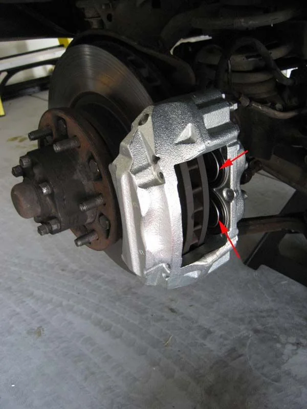

I had to pry the pistons in the new caliper back out a bit, using the wooden handle of a hammer to get the new brake pads and shims back in. After that, replace the pins and spring in the reverse order that they were removed.
I bled the brakes using a 'pump the brake pedal assistant'. I took the opportunity to replace all my fluid as well at this time. It was about the color and consistency of maple syrup, and pumped it until it came clean and clear. Because I replaced the calipers, and they had a lot of air in them, my bleeding sequence was a little different, but worked well. I bled the front two lines first, until very little air was coming through the lines, then moved to the typical sequence, and finished by bleeding the fronts again, and the LSPV last to clear all the air.
Fired the truck up and everything's working great, no spongy brakes, and no dragging pistons on the rotors.
