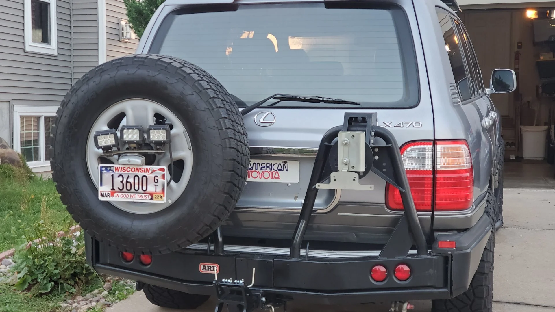

Since I do not need to have two spare tires, I would like to remove the right hand side swing out and replace it with cover panel to make it easier to open the rear hatch.
Looks like the part number I need is: RHS BLANK COVER PANEL, BLACK 5700232.
Unfortunately I can't find any install guide or instructions any where to help me understand if I would need to take the whole bumper off for this? Are there any shortcuts or useful tips you guys could share?
