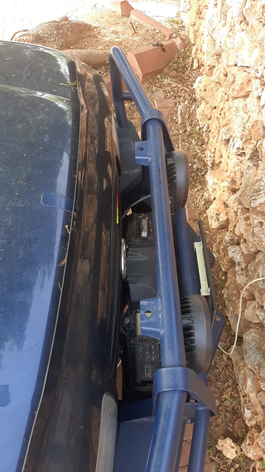

I would like to replace the AC condenser, but there is a catch...
I do not wish to remove the front ARB bumper, it's a huge job installing it back.
So what o you think - is it possible to replace the AC condenser from the engine side?

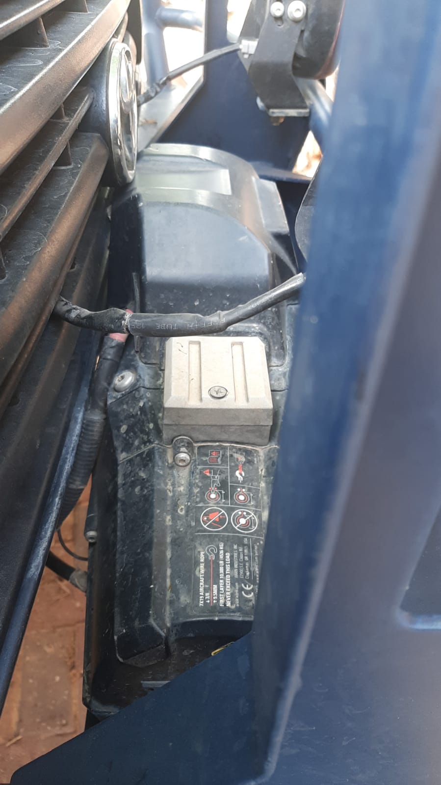

I have a big winch mounted in the bumper, and it is just up against the grill.
So I must either remove the winch, which will be almost impossible, or remove the entire bumper.

You would have to remove the radiator, the cooler, the grille, the transmission cooler, and then the AC condenser. So, I would still start at the front.
Unless the winch is literally in the grille, then you just have to reach down between the ARB/winch and the radiator to get to it.

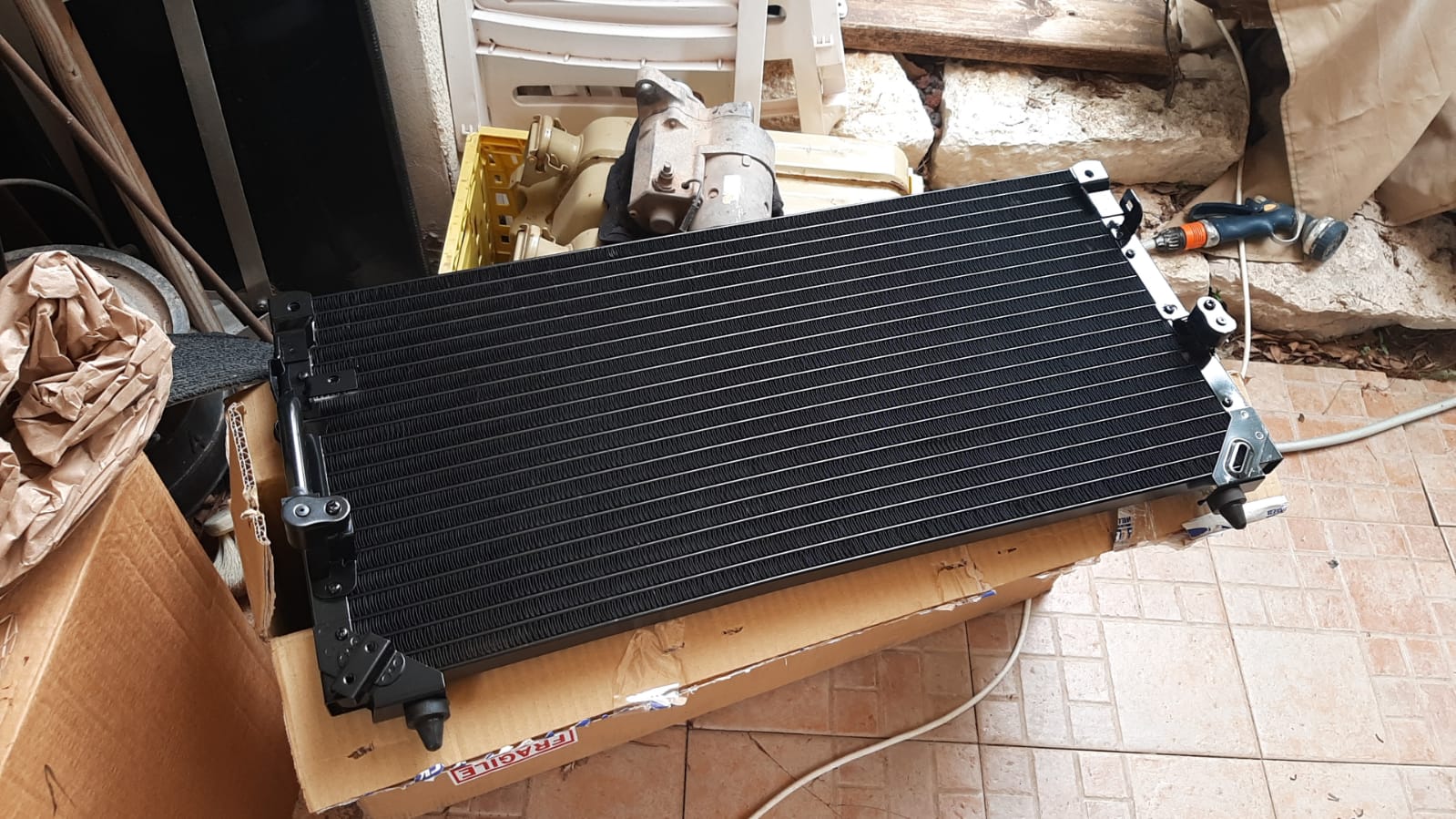

I removed the winch, took out the grill, and everything else from there went smooth.
Two hours work, very easy. Just need to go to my AC guy to fill the gas back.
