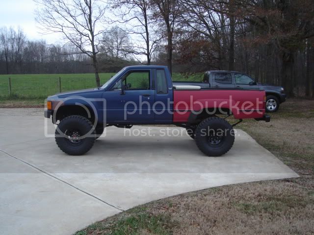

I'm running RC 3" lift (frt and rr springs) as a temporary mod till I can do better. I bought it on sale for under 300 bucks as I recall.
Too stiff for my liking. But it was cheap... so there ya have it. Kit was complete and the truck sits level and sorta clears 33's (hit's the pinch welds and bottom of front fender).
The rear springs won't carry a load, so I've mixed in some old re-arched springs, not shown (I spent like 10 bucks for the re-arch)... still not great. U bolt flip not included :D
...oh, and extend yur bump stops... :o
Before on 31's:
So the Rough/Tough Country springs provide lift, but you give up all semblance of a comfortable ride. Hmmm.

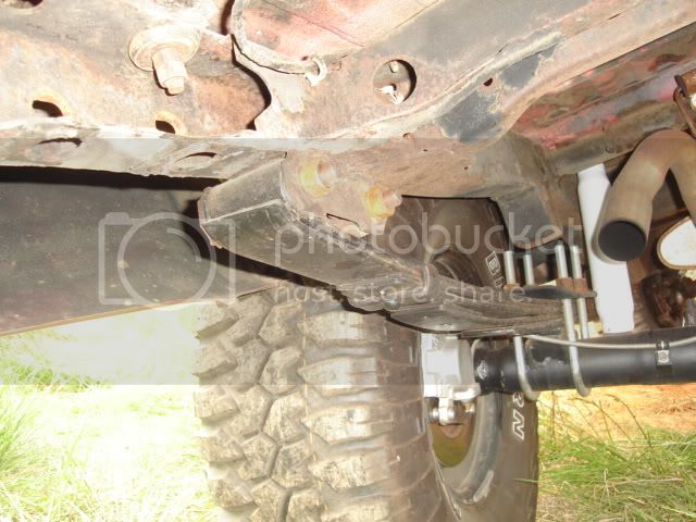

the first thing i tried was longer shackles, it did not help my springs, the passenger side still rested on the frame.
I would measure those then. They coul dbe third gen rear springs. They should not be long enough to do that, and deffinately not with a longer shackle.
Third gen rears are a few inches longer than second gen springs. That might be what happened.
