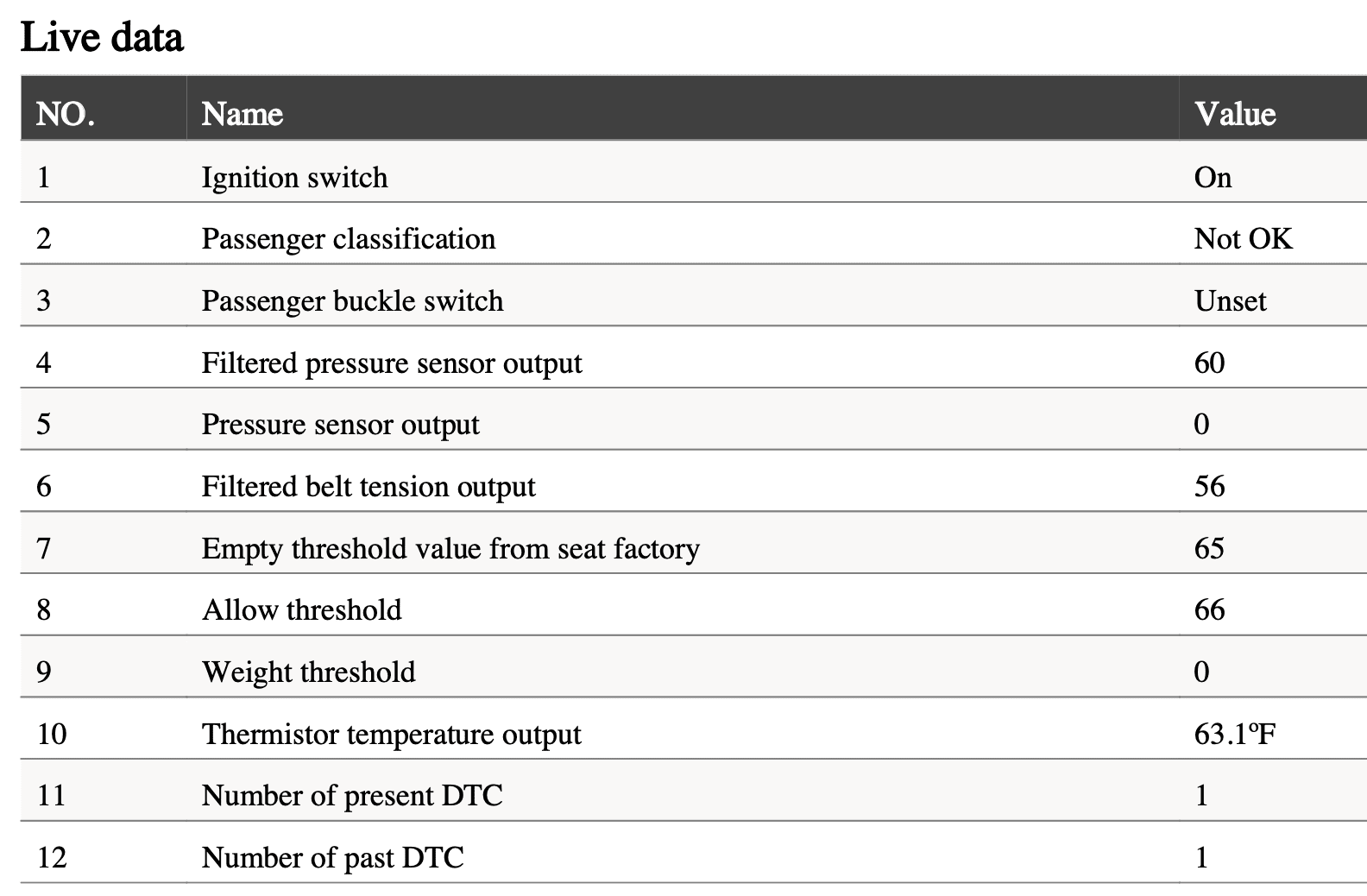

BTW here is the current live data output (measured with no one on the seat)
Maybe someone will notice something I didn't
also when I manage to temporarily clear B1795 (still having B1797) this is what I see
