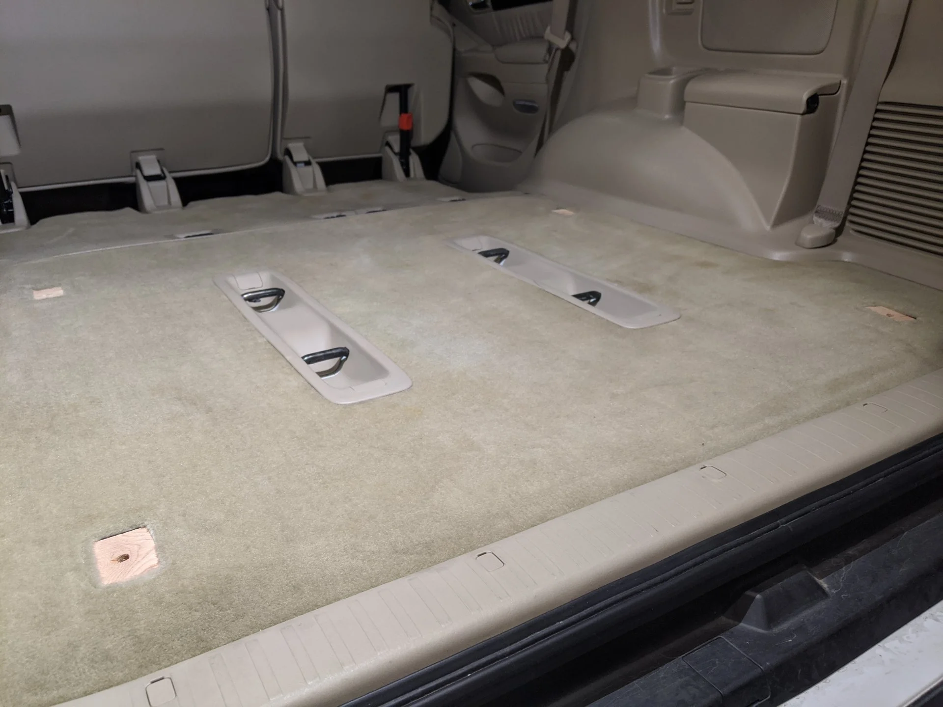

Pull the carpet and look. Takes about 10 minutes. There are a number of very sturdy bolt holes where the 3rd row attaches. This is where Dobinson's drawers mount which are very heavy and sturdy. You can also drill holes just about anywhere else you want. All you need is the most basic of Lego-kid brain, a drill and a tape measure.

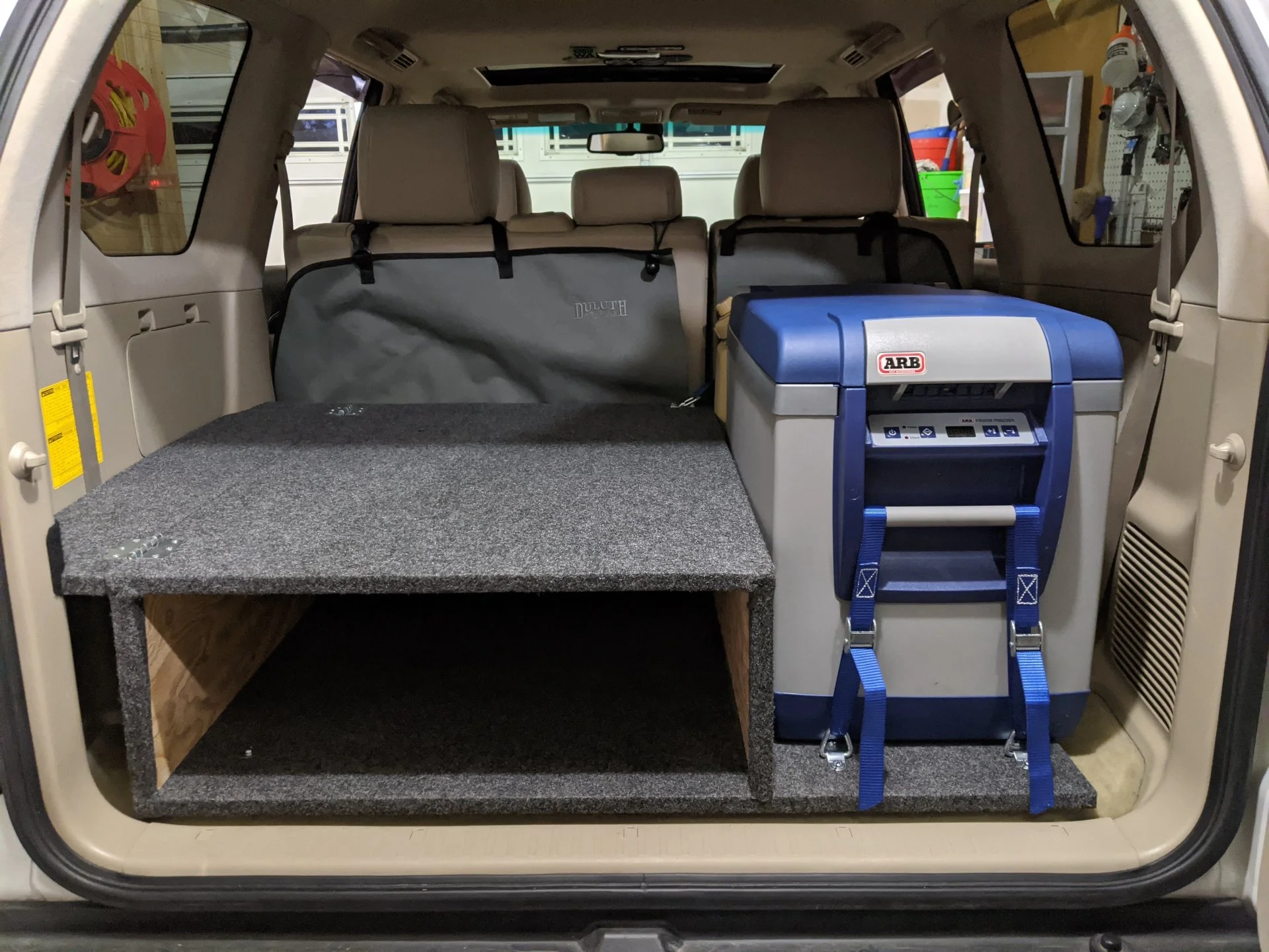

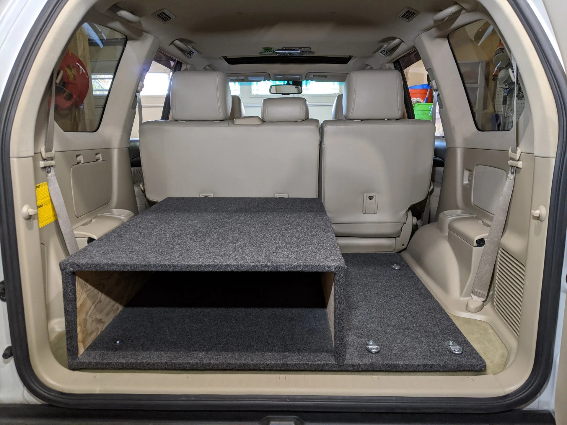

Here's how I mounted my rear storage. I did not remove the carpet. There are four factory anchor points in the corners which I removed. I then cut up a few pieces of 1x2" wood into squares to level out the mounting locations. Drilled a hole through the wooden blocks and bolted it down.
I did something similar with mine, though no riser and I followed the contours at the back. I may redesign it soon - having a tiered system like @yeos would be super helpful.
