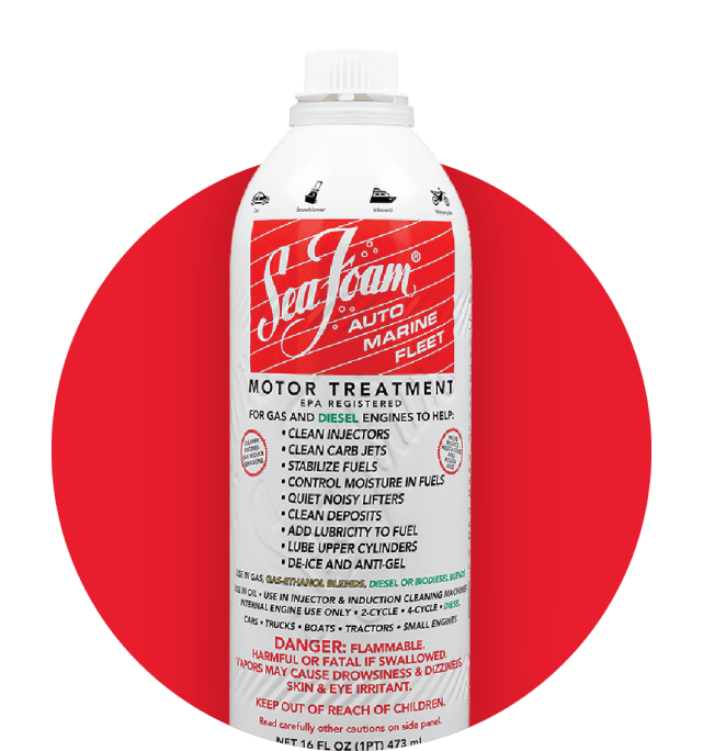

Bottle of Seafoam engine/fuel cleaner. Follow recommended guidelines and add to full tank of gas, and in oil. Change oil after about 100 miles.
They also have a spray that goes into the throttle body while the engine is running to clean internals.
Maybe also good time to check/change spark plugs
Thank you so much for this advice! Will definitely look into it and try it out. I've never added additives to oil, so it will be the first. Have you done this process and how did it turn out for you?
Spark plugs were changed about 40k miles ago so I think it should be fine.

Two bottles of antifreeze should be fine. At least on the jeep it is. Haven't done either on my GX yet. But have done the seafoam on several vehicles in the past. Can't really say if I noticed a difference on anything but it also didn't hurt
