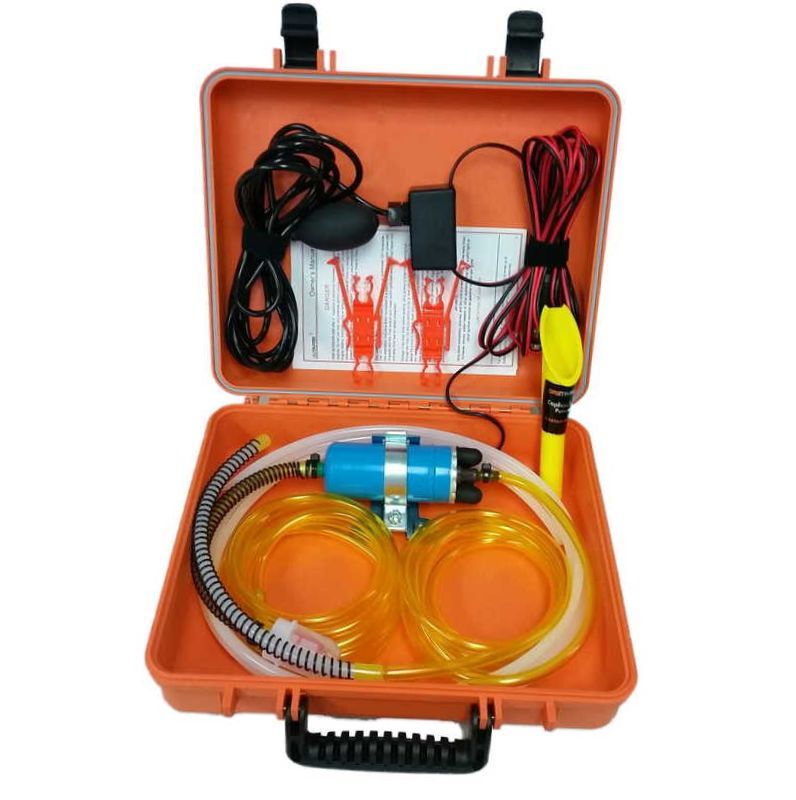

Tilting Jerry Cans into the truck is so 1980's. Welcome to 2017! :)
Products to Siphon / Transfer Gas, Diesel,Fuel & Water
Why am I not surprised there is such a gadget? :rolleyes:
Whatever happened to what we used to call an "Arkansas credit card".....4 feet of garden hose a suck? Heck, you don't even have to worry about lead poisoning anymore.
