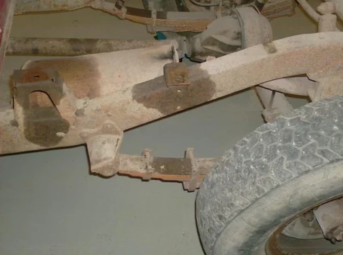

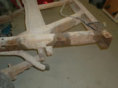

Well... my Canadian bed came off with 10 bolts. More accurately, after I drilled through the heads to weaken them and used an air chisel to snap them off. I would imagine the tray would be mounted to the same brackets off the frame. Three each side rearward of the axle and two in front.:wrench::wrench:
The wet spots (penetrating oil) are from trying to loosen the bolts up.
