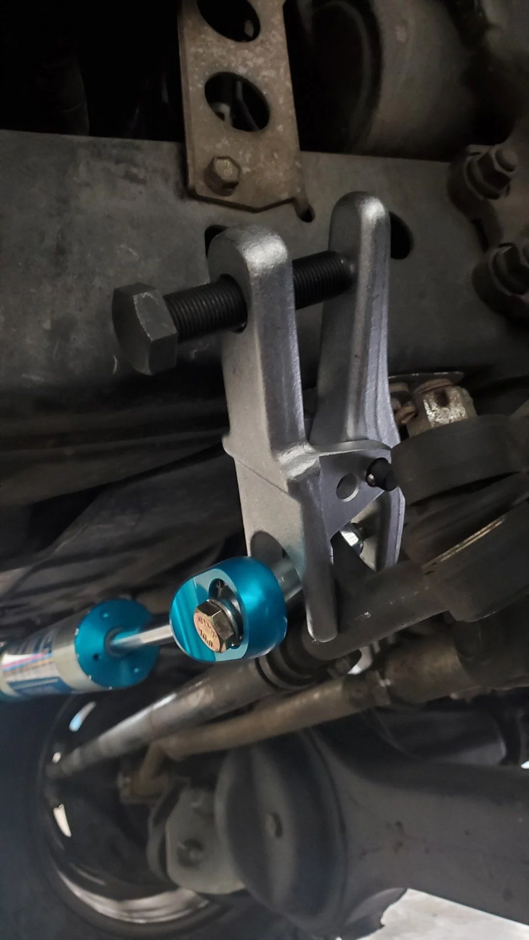

Is the fork-like part of that ball joint separator wide enough to sit on the relay rod end and not on the flat part of the tapered bolt itself? I tried using my ball join separator, but it was too small and was sitting on the flat part of the bolt. Basically just pressing the bolt into itself instead of pressing it out of the bracket on the rod end.
Like this:
Ah yep that's exactly what I mean. Definitely looks big enough to work.
Thanks for your suggestion!
