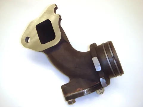

Ok I got the manifolds back and they look great. Machinist said the cast iron was warped a little, not much. He machined them together. I put them up to the head and wow what a difference.
Here is my new issue. I took the heat riser flap out to trim it so it would clear the SOR insulator. It was a pain to get out, the bolts were spot welded. Anyway I am thinking about leaving it out and welding the shaft hole. Would like some opinions on that. If I need to trim and put it back in I need new bolts and gotta figure out how to tension the spring, which moved quite a bit when I removed the flap.
With the SOR insualtor installed, there's no need any longer for the rotating heat riser flap. It won't be doing anything useful. Remove it entirely then plug the shaft hole some way. The machine shop did it this way for me.
I was hoping for that answer. I think I can just tap it here at the house and plug it. It should help the exhaust flow a little more freely. I was just worried that the insulator might need a little protection from the flap at full engine temp but It should be OK. Thanks

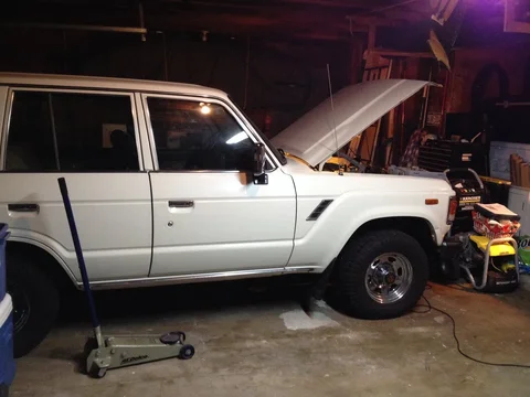

A few of pics of the white cruiser desmog/manifold project underway. I sure appreciate everyone's input. I got to thinking, instead of tapping the heat riser shaft hole is there any reason not to just through bolt using some red loctite and maybe some high temp rtv? That way the shaft could be re-installed at a later date if anyone wanted to, for some reason.

Just to make sure I didn't miss something, is the new heat riser shield that you have installed between the manifolds the OEM or the SOR (basically a block-off plate) one?
If it is the OEM one, it is designed to allow hot exhaust gases to hit the bottom of the intake manifold when the heat riser is deflecting exhaust up to the bottom of the intake (when engine is cold). Then, when the engine warms up, the heat riser moves (there is a temperature sensitive coil that rotates the shaft, and since the heat riser is fastened to the shaft, it rotates) and diverts the hot exhaust down the down pipe preventing the hot exhaust from continuously hitting the bottom of the intake manifold.
The SOR block-off plate prevents hot exhaust from hitting the bottom of the intake manifold at all times (hot or cold) because it doesn't allow any exhaust to pass regardless of what the heat riser is doing...and it also shouldn't allow the heat riser to rotate at all, which is why guys either remove it entirely (as you are intending to do) or cut off part of the blade that interferes with the block-off plate so that it can continue to rotate.
If you have the SOR block-off plate installed, then either make sure the heat riser is positioned to divert exhaust down the down pipe or remove it (as you are thinking).
Plugging the holes where the bushings/shaft went through the exhaust manifold is to prevent an exhaust leak.
Any way you design to plug that exhaust leak must hold up to high temps and corrosive exhaust gases. So, in the case of using a removable bolt, I would imagine it would have to be a grade bolt that can withstand a corrosive environment...stainless steele? Or is there a better material?
Same with the high temp RTV sealant...
I know you've probably already considered this...just talking it outloud in case someone else has recommendations to improve on the plan...
I am installing the SOR stainless steel shield that completely isolates the intake from the exhaust gases. I was thinking of using a stainless bolt in the heat riser shaft hole that faces the rear of the engine. The side facing the front of the engine already has a sealed plug from the factory that looks pretty stout and has held up for 30 years. Was also going to use red loctite, flat washer, lock washer and two nuts with a little orange high temp rtv. Maybe some JB weld on the last nut for good measure.
The shaft wasn't that tight to begin but I never heard any leaks. The bolt should do fine as long as it stays tight. Thanks!
