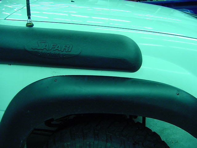

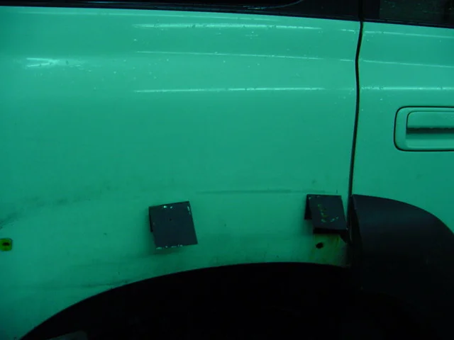

Took me a while to getting around to taking the pics, but here are a couple. Obvioulsy, one could do a much nicer job. My truck gets beat on regularly. I take the flares off every three to four weeks. I have stopped caring about 10' and in. If it looks presentable from a distance, that's OK with me until I stop wheeling it.
I put the clips in place, then drill through the flare and the clip so I know the flare is going to be where I want it. THey are just 16ga. sheet, so I can tweak them a little. I then put in the rivit and paint the head. Pretty hillbilly, I know, but I really like the look of the flare better and they are seriously torn up from trees. Now I just take them off in the parking lot with a 10mm wrench and off I go.

Thanks for the pics. 3 of mine are beat up but I still prefer the flares to the non-flared truck.
