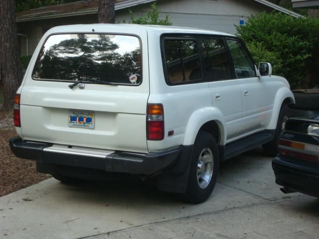

took off my landcruiser tailgate badge
Just took off my Landcruiser tailgate badge last week. I used 3M adhesive remover. Get some sort of plastic handle so you can spray it and use some muscle to scrape it off. Took me awhile but not too long... just soak that 3M on there!:cheers:
I got the spray can of the same stuff as above. Works great! s.....o......a.....k..... it!
