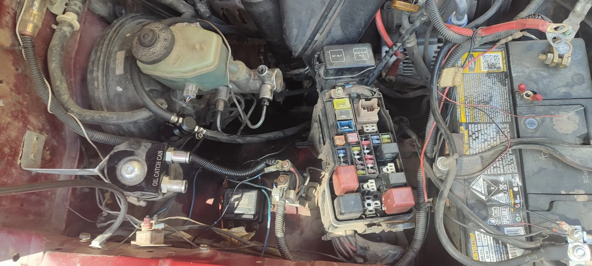

So I've started looking into what needs to be done to achieve this. You can buy 100 series complete air filter boxes for $99 that should fit in the starter battery space. I might also look into later model Prado air boxes and see which filters are more readily available. If you look at pic #2, you'll see the starter battery, the fuse box, dual battery isolator and catch can will need to move. Starter battery can go over to the opposite side. That's pretty straightforward. But the fuse box is a bit tricky. I think if I move my catch can and the battery isolator, I can rotate the fuse box 90° and up into that space BUT it will involve cutting and lengthening about 6 electrical wires in the harness attached to the same plug 😬
Any auto eleckies reading this have an issue with this idea? Assuming the extended wires are soldered, shrink wrapped and then protected with a wire snake sheild?

And not to be critical, but with that existing mess of loose wires - yeow.

In that second pic, I've undone/loosened off all the wires and taped off the live wires intentionally so I can see what's involved with moving the fuse box. It doesn't usually look that hideous haha

I was going to try to use a I4 or V6 4runner airbox but they wount fit. The spot welded batt tray is in the way, plus I have ABS so not much room for moving my fuse box .
