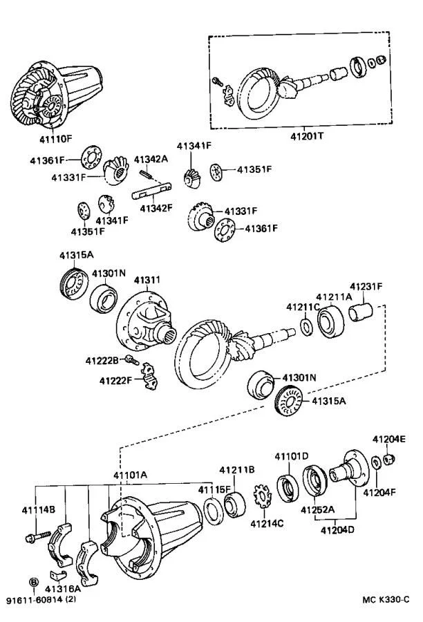

Sorry oil retainer (or whatever the F it’s actually called) you reuse the slinger, but you will have to open up the ID of the slinger if you upgrade from 27 to 29 spline pinion. Or just buy the correct size from cruiser outfitters, or wherever you want.
PN 4115F Need one of those they are cheap, and not included (at least in a Nitro installation kit)
