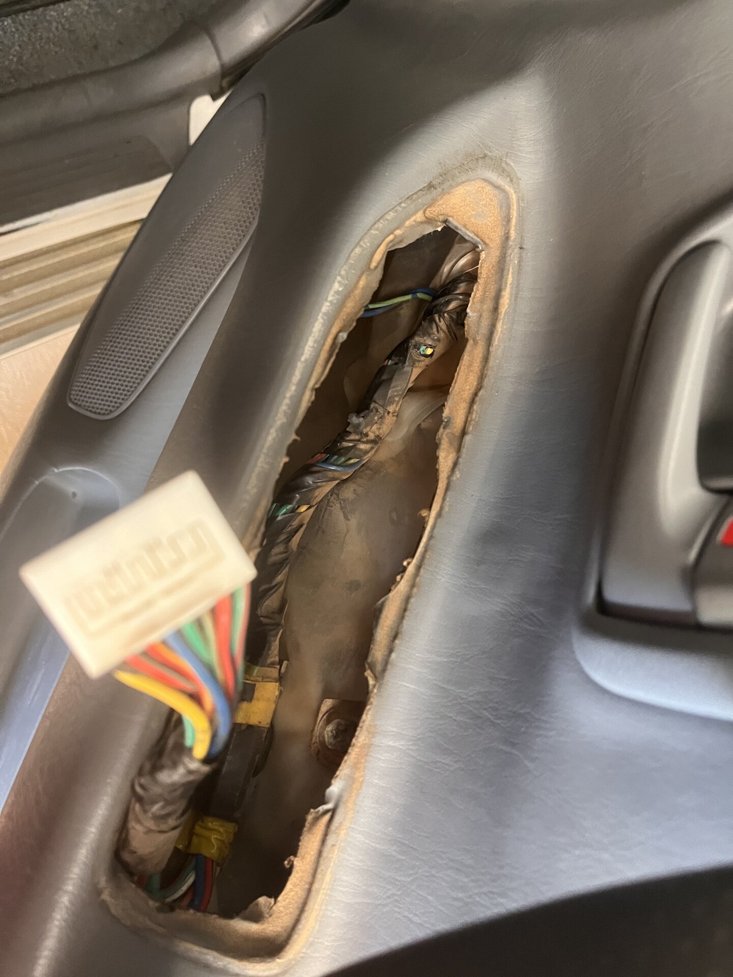

I have a new to me but very-well-loved South African 105. Mechanically, it's been pretty solid but the interior needs lots of love. The driver's side window strains a little going up and down, but I suspect the motor is still good. The track of the window has tons of dirt in it; the master switch, which will need replaced, looks like it was buried in the dirt.
Are there best practices for cleaning up/reconditioning power windows and the related mechanism? It looks like the seals and gaskets need replaced. Is there any kind of lubrication I should use given a particularly dusty environment?
Thanks!
