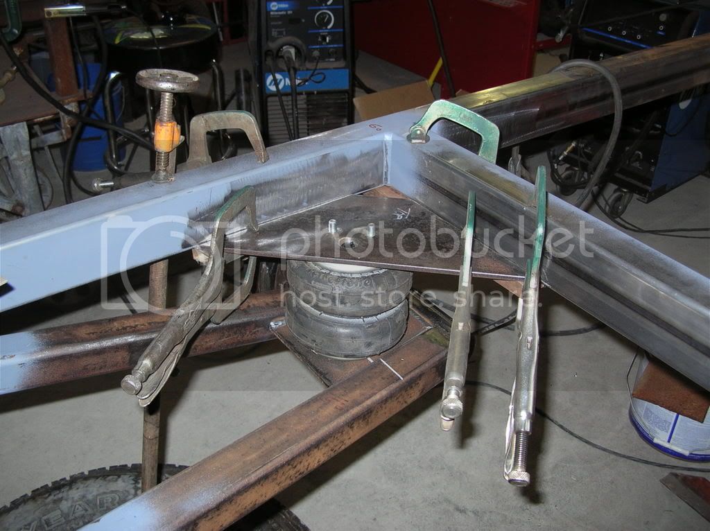

Here is my firestone bag installed... Very happy. Also AT, who runs these, has reported ZERO failures if I remember correctly...
Ride height is actually about 1" more inflated...

Lots of suspension designs are better than leaf springs, just more expensive and more difficult to design. Go for it! dieselcruiserhead's is pretty nice...

Leafs with bags maybe??? even with my alignment hasssles I had with my trailer(solved), I am sold on the bag/trailing arm setup! Go for the bags! Dieselcruiserhead has the idea!
