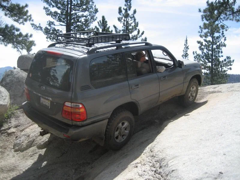

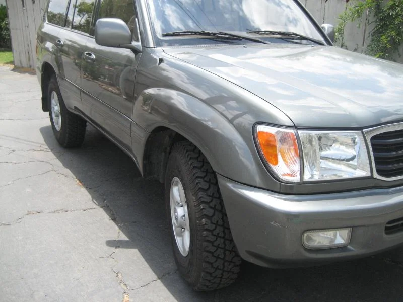

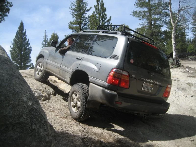

Here are some pics of the tires with OME 860's and cranked OEM Torsion bars.
