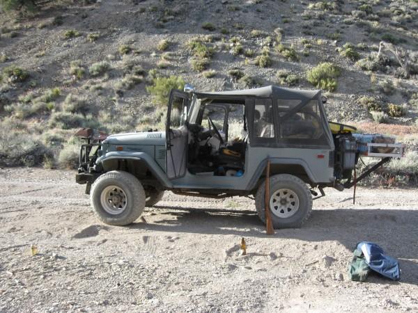

Did you read the OP's post? He doesn't want to buy a bumper. This might be more what he's interested in. But it was fabbed, not bought as a product.

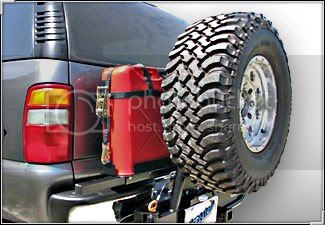

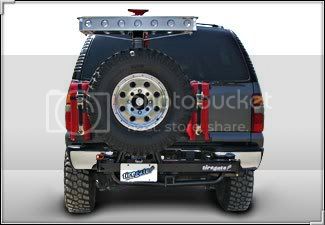

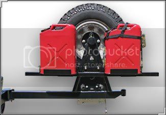

I dont know how to "link" but go to tiregate.com I think this is what you're looking for.
That was exactly what I thought of as well.
Just not sure about the price. $600??? No thanks. I bought my POS Trailer for less than that.
