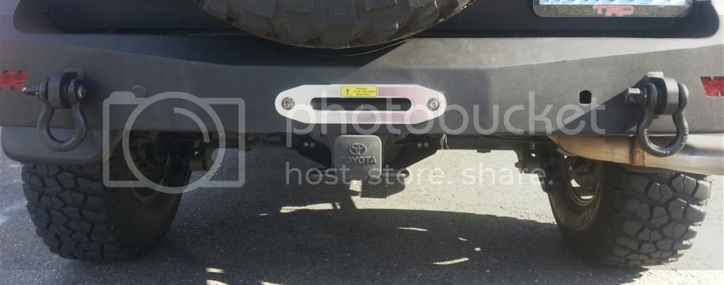

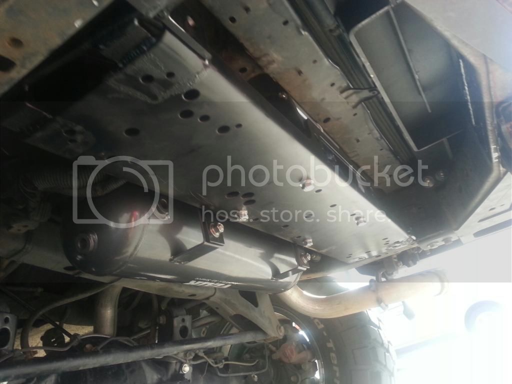

I modified my Reese hitch to accept a Curt winch receiver mount from the opposite end, a piece of 1/4" angle iron as a cross member and lots of measuring and drilling....

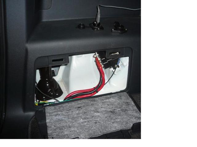

still have to wire it up and section the rear cross member for a fairlead but as far as im concerned, the hard part is done. Its a Superwinch tiger shark 9500 with 92' of 1/2" synthetic. It is completely hidden from sight and fits perfectly between the rear cross member and the vapor canister. I clocked the clutch lever and it works great where it is. I attempted to clock the motor but there is only one set of mounting holes so i could only clock it 180 which put the cable terminals too close to the mounting plate so the solenoid was relocated to the jack storage area.
Did u have to cut out the 2x2 steel on the rear of the hitch or was it already open?
I have a Hidden Hitch and it's welded closed.
Very cool idea.... This is the first rear winch I've seen mounted in an FJ that also keeps the rear receiver.

Looks really good; is that crossbar ahead of the winch stock?
A concern, most types of braid don't like dirt and grit in them and road grime and dust will destroy strength the line in no time. You might want to find a way to cover the spool and protect the line from dirt.
