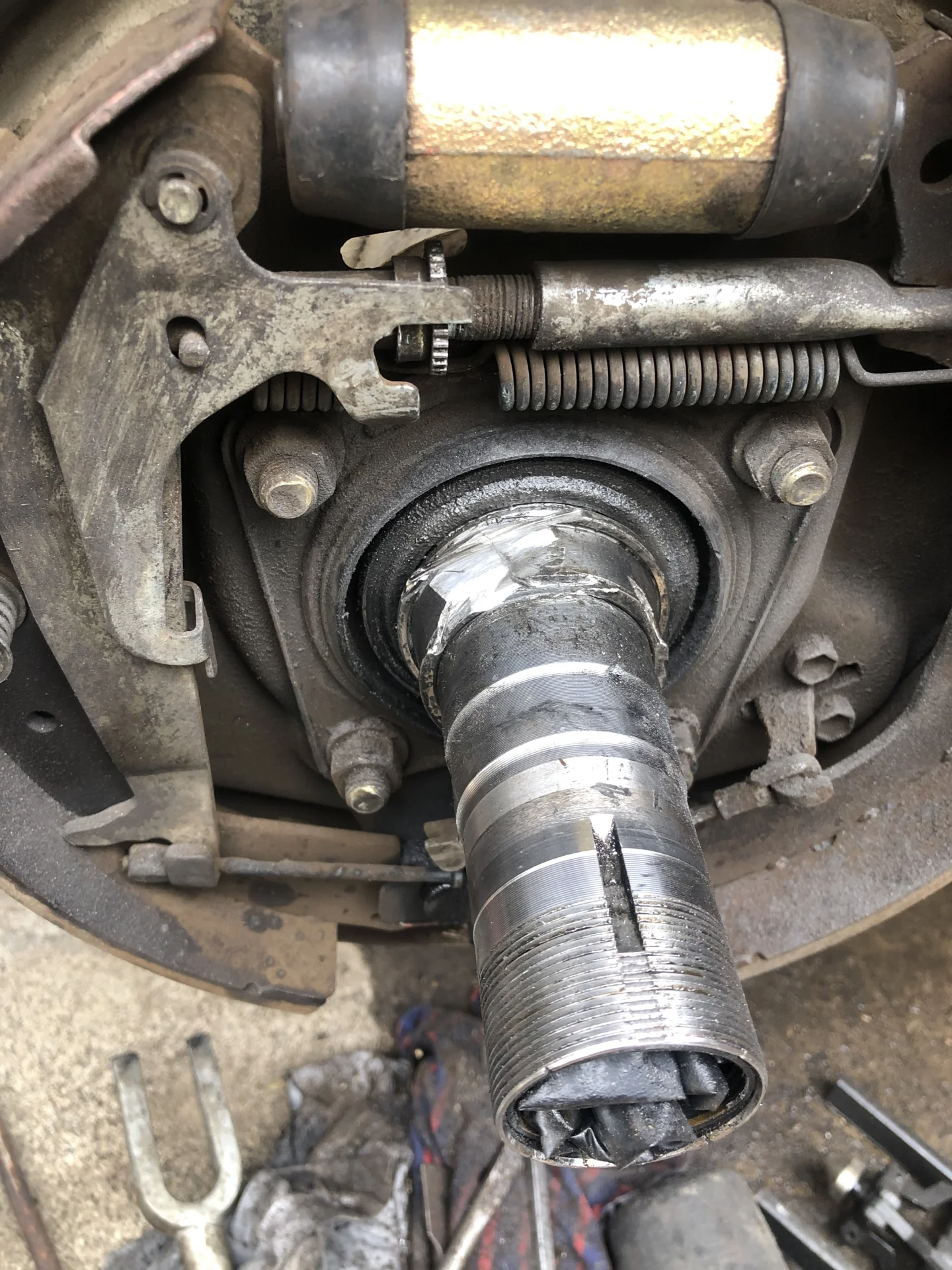

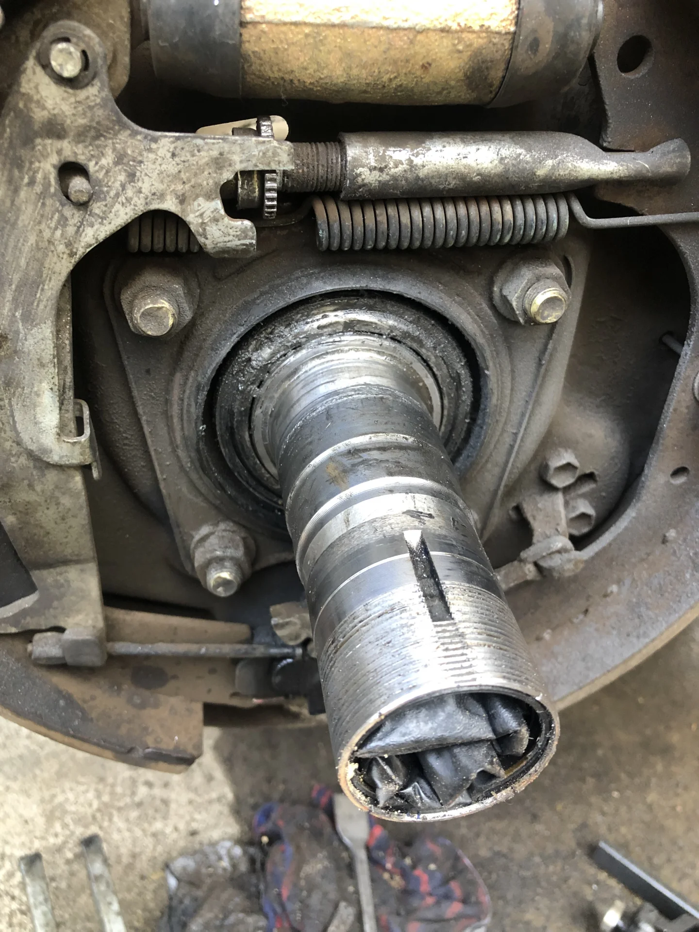

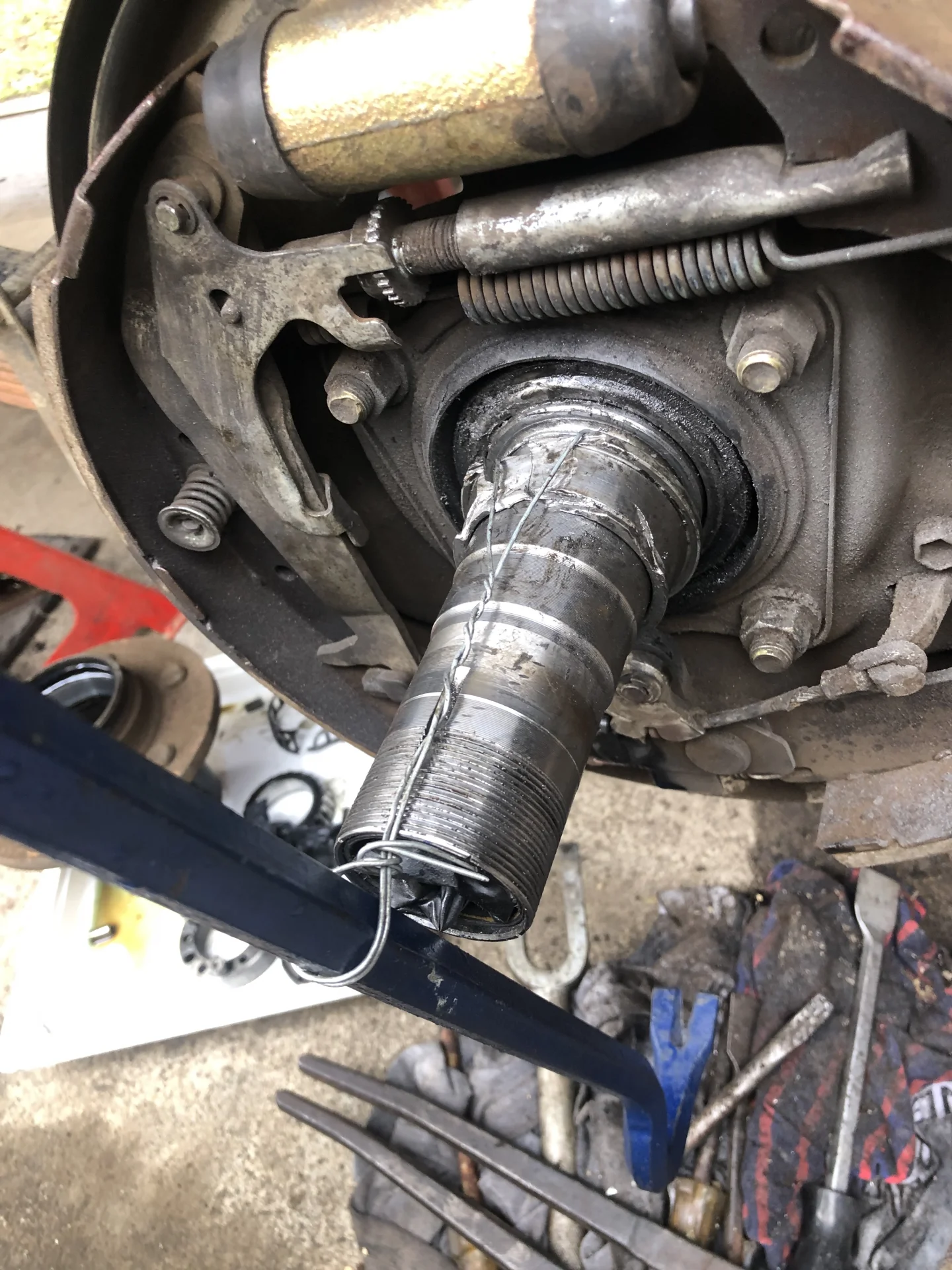

Hi all, wish to ask is there a bearing puller suitable for removing the inner rear wheel bearing if stuck on the shaft? I took yonks carefully cutting and grinding chisel the old bearing off like a watch maker. Finally got it off with wire wrapped around the bearing, bit of a dog.
Not easy to get a puller to grip on that race.
For this one off job, I would weld a couple of steel straps to the race,[water handy to cool it after each weld] and tap/pull it off.
Grinder marks under the race won't hurt much, as long as the new bearing presses on firmly.
Thanks man! I reckon I am going to have this problem every time I change rear inner wheel bearings or wish to repack. Maybe emery the diff end a minute tad. My experience was no way as easy as any of the videos on youtube!
