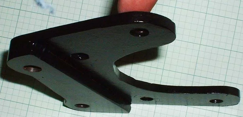

For the rear of my cruiser I used solid mini rotors and calipers. off the front of the disk parts I used up front because I used vented parts up front. I made the brackets after seeing some a friend made. I used 1/4" plate for the main section and 3/8" for the spacer section. after drilling all the holes I tapped the holes for the metric bolts that the calipers use.
pics
I don't have dimensions on these but these should give anyone an idea on how I made them.

Sorry not looking to make any more. But someone should be able to without much effort with these pics. They could be cut out of plate and bent to make for cheep like all the available GM brackets.
