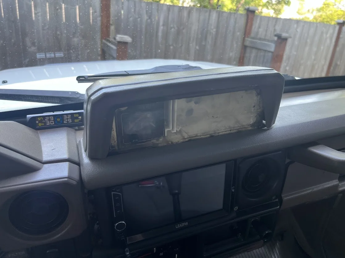

Here is the old one that was in terrible shape

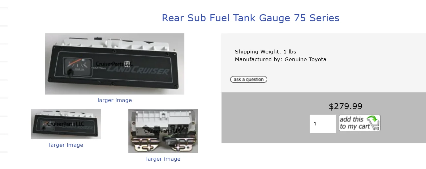

Trying to get one online was difficult and costly, and I only needed the display; my gauge is working fine.

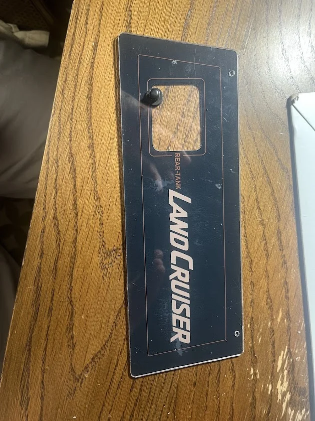

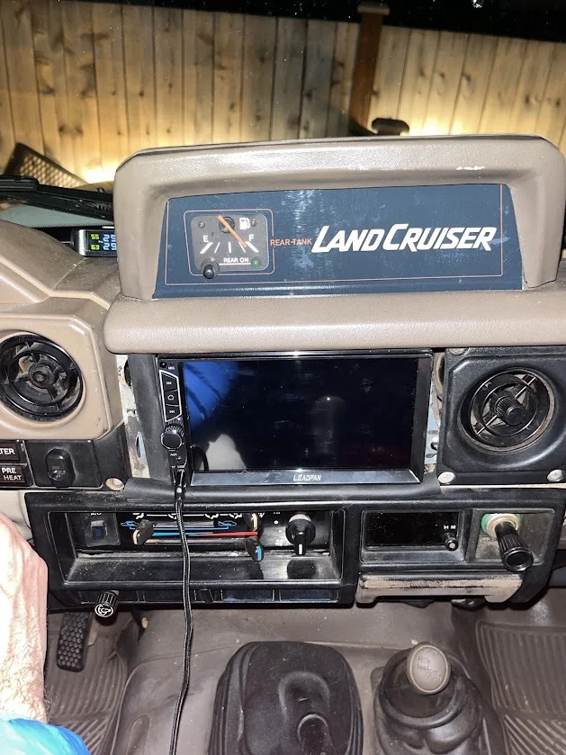

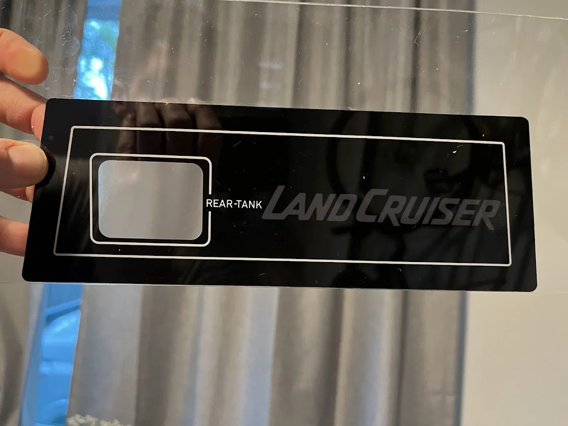

I used some reference photos and my own sheet to design it in Adobe Illustrator. Since I was going to reprint it anyways, I figured I might as well customize the colors, but I have an OEM similar design, and then a dark blue and tan option (shown in photos) that goes with my khaki interior.
I tried reaching out to some sign printing companies, but it was still going to be $100+ for one display. So instead, I had www.carstickers.com print them as vinyl reverse stick printers, then attached them to 2mil acrylic. I scored and broke the acrylic at the border, then cleaned up the edges with a Dremel, and drilled the holes to match.
If anyone else needs a rear tank display, let me know, and I can ship one to you for the cost of shipping and materials. I have 5 prints of the OEM black style, and 3 more prints of the dark blue custom, and if someone is interested in a custom one, I can help design one you'd like.

This is awesome! My display recently cracked and I’ve been looking for this sort of solution!! Is there any way possible to make a display with the landcruiser logo transparent enough so I can put a light behind it causing it to be illuminated??. I’ve been trying to sort this out for awhile. Any help or suggestion becuase if you could help me with this that would be awesome!!
I’d be happy to help you with this. Yes, the logo does glow with a light behind it because of the lighter color. I’ll try to get a picture of the effect tomorrow night.
