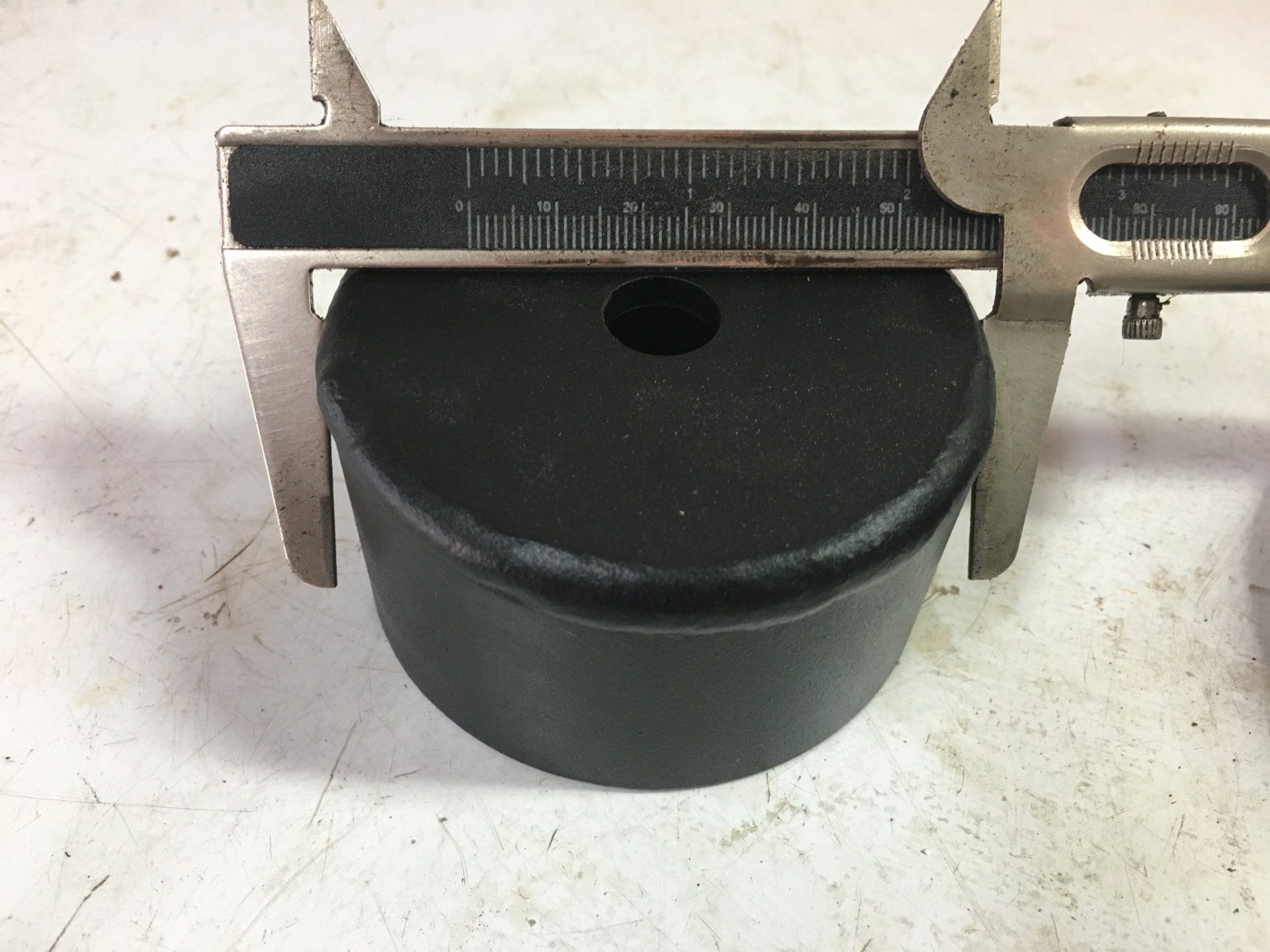

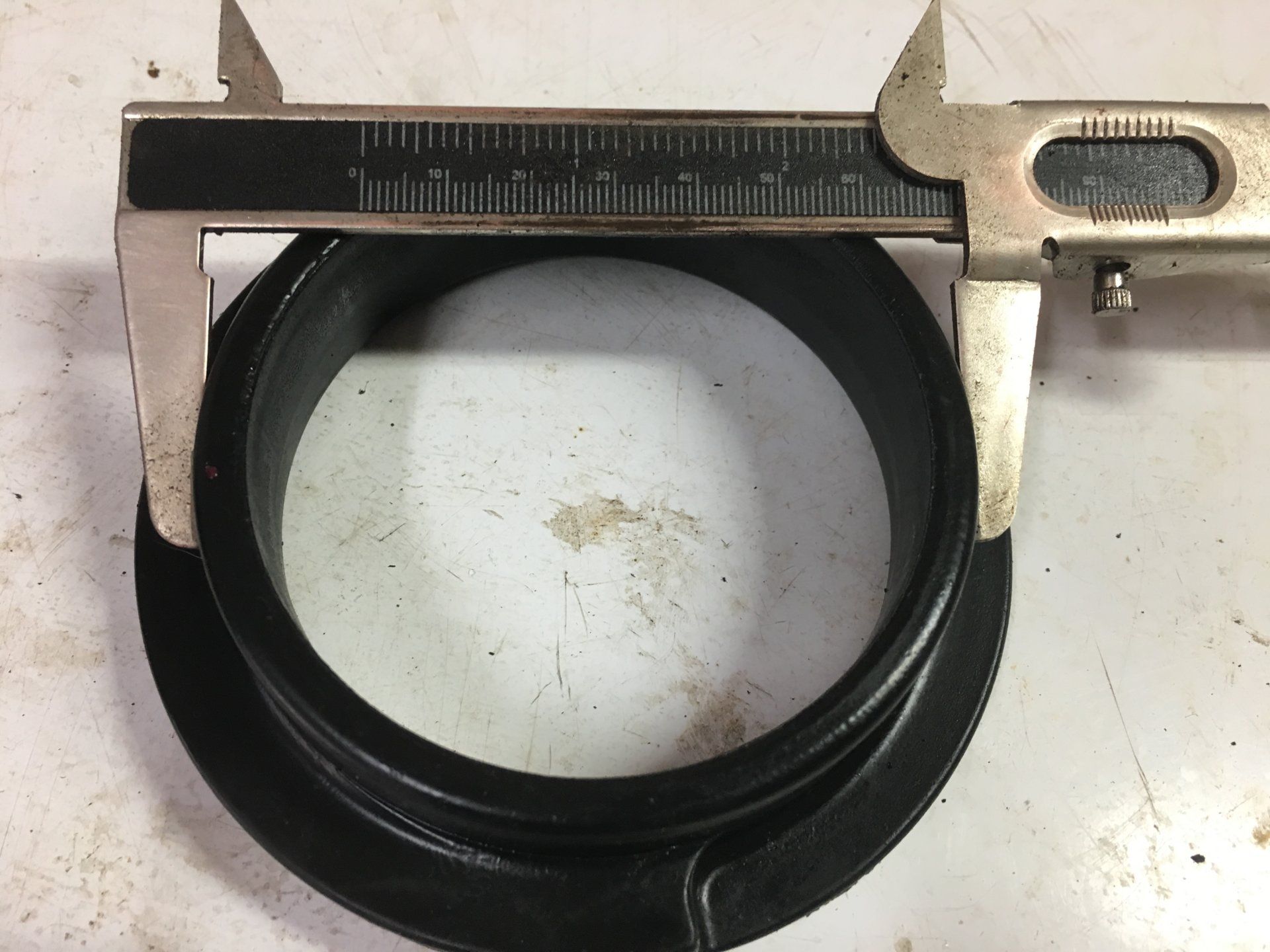

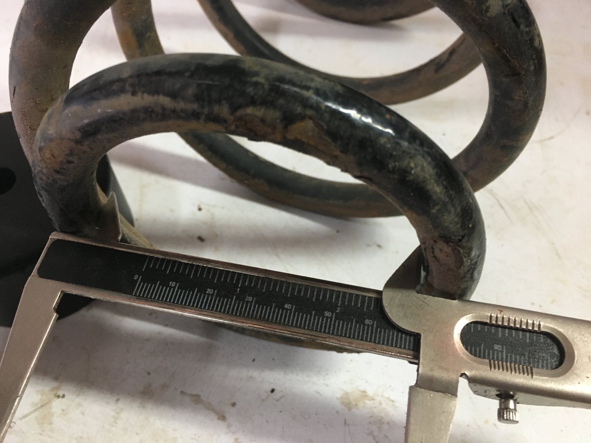

I have a metal tech coil conversion kit that I didn’t need after swapping an e-locker 8.2 rear end. I will get measurements for you tonight when I make it to the garage.
I’ve attached some photos, excuse the old dirty caliper.
Coil Spring ID (bottom) 86.5mm
Bottom coil conversion “puck” 77.5mm
Bottom spring rubber isolator 88mm
