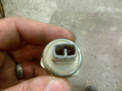

Finally tracked this issue down. It was the two wire sensor that detects the position of the e-locker. Removing the sensor is really easy. Just need a 27mm socket and about 2 minutes of sliding around on a creeper. To provide a little more headroom, you can jack up the frame so that the rear suspension relaxes - giving you more clearance between the floor of the cargo area and the top of the axle.
Position yourself behind the rear axle and look down on top of the diff housing. There are two wiring harnesses and a breather tube all in the same area. The larger harness is a six or eight pin type, but you don't need to really move it. Remove the two wire harness by squeezing the catch release, then pull up. Now take your 27mm socket and put it over the entire sensor. A 27mm socket is generally big enough that it won't harm the plastic connector on top. Once you break the torque on it, you should be able to remove it by hand fairly easily.
Mine had a broken pin in the connector which was the cause for the ghost light. Turns out this is a common sensor in Toyota drive trains, so I tried a used one out of an 80 series transfer case. It bolted right in, but turned out to have a bad switch in it too. So I ordered a new one earlier this week (eep!! $70)
Part Number PNC 84222E
So the bottom line is that the 6/8pin harness controls the actuator which engages the e-locker, but the 2-wire harness detects engagement. My e-locker was physically engaging when I turned it on, but its possible the ECU didn't know it. The ghost light on the dash was the monitor that was alerting me to the broken pin in the connector - the light sometimes would fade or get brighter, but never came on 100% brightness.
Incidently, the sensor from the 80 t-case did not produce the ghost light, because the pins were still conducting whatever loop signal is being sent to it. But because the 80 sensor was bad internally, it made the locker light flash brightly whenever I tried to engage it.
broken pin on left

detent type switch

one from my diff and one from 80 series t-case
