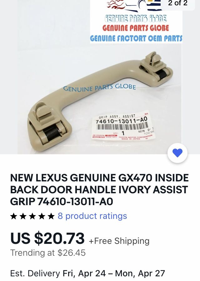

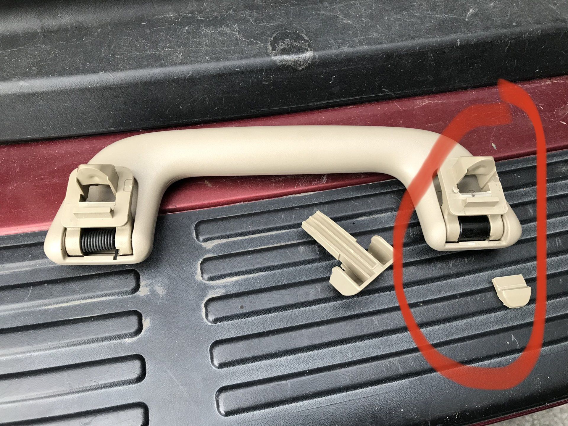

My rear door handle finally broke. Im seeing 2 different OEM designs on ebay. Thinking this different looking one looks stronger than the design my 2009 had from the factory. Does anyone have experience with this?
Original clip style:

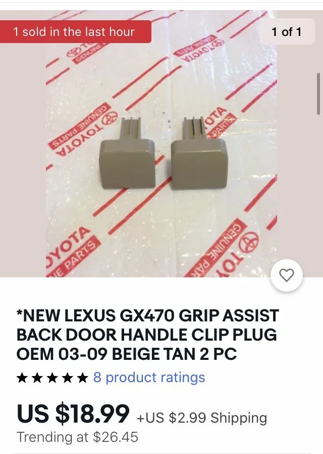

And the other different one (looks stronger?):
I'm pretty sure you need both. The clips in the first photo install into the handle itself after it has been installed onto the door panel.
Ah ha... this is making more sense now. Lol. Thanks
The clip is weak.
I fixes mine by using spiral drywall anchor and a small piece of plywood behind the square clip opening. Then use screw and washer to hold the grab handle. You could only see the screw when you raise the handle.
Ok. So I found what broke. It looks like I need to buy the handle but not the little clip...
Mine broke as well when I removed the door panel last year. I replaced the handle, but if it breaks again I will loop a Nite Ize gear tie through the two holes and call it good.
